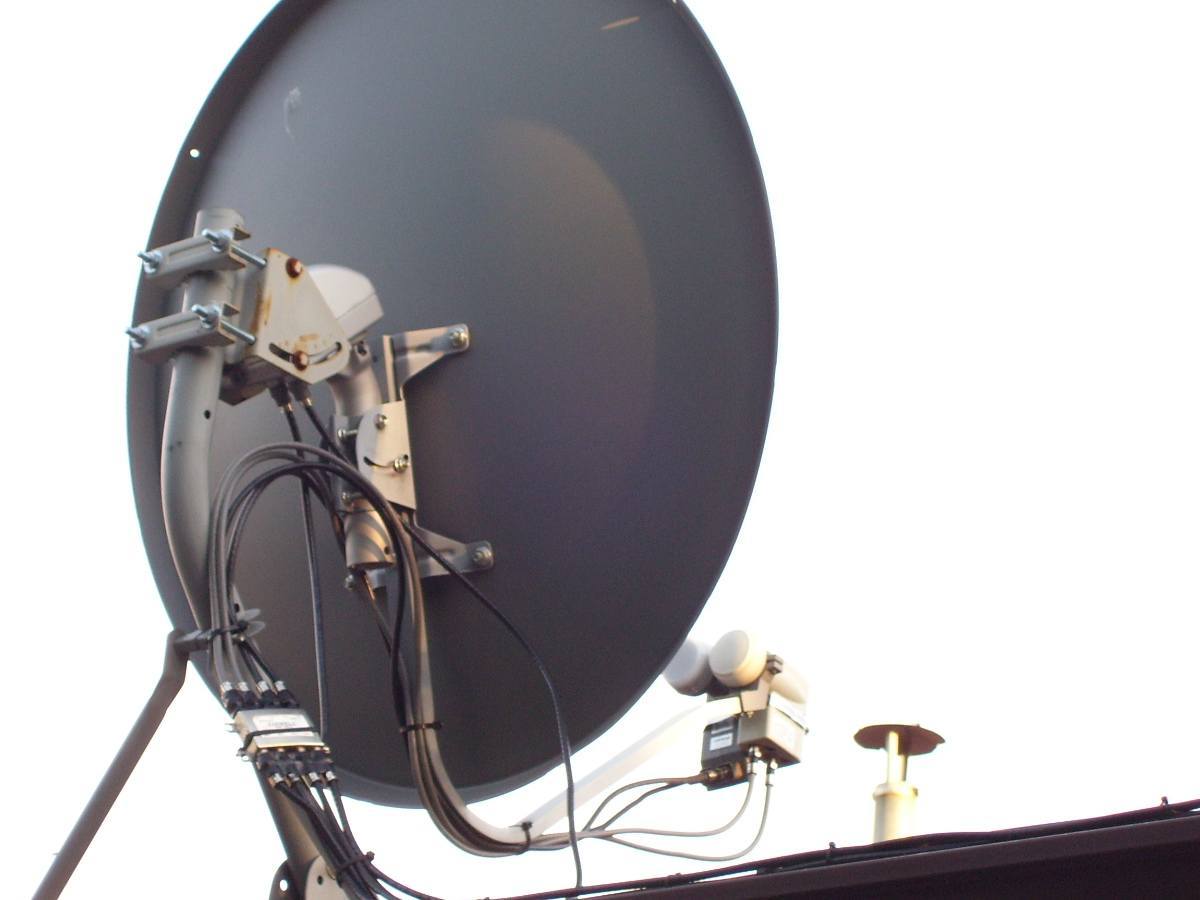

I had my 4x4 switch out in the elements here in Minnesota for 3 years with no issues
I used that coax sealant around all the connections

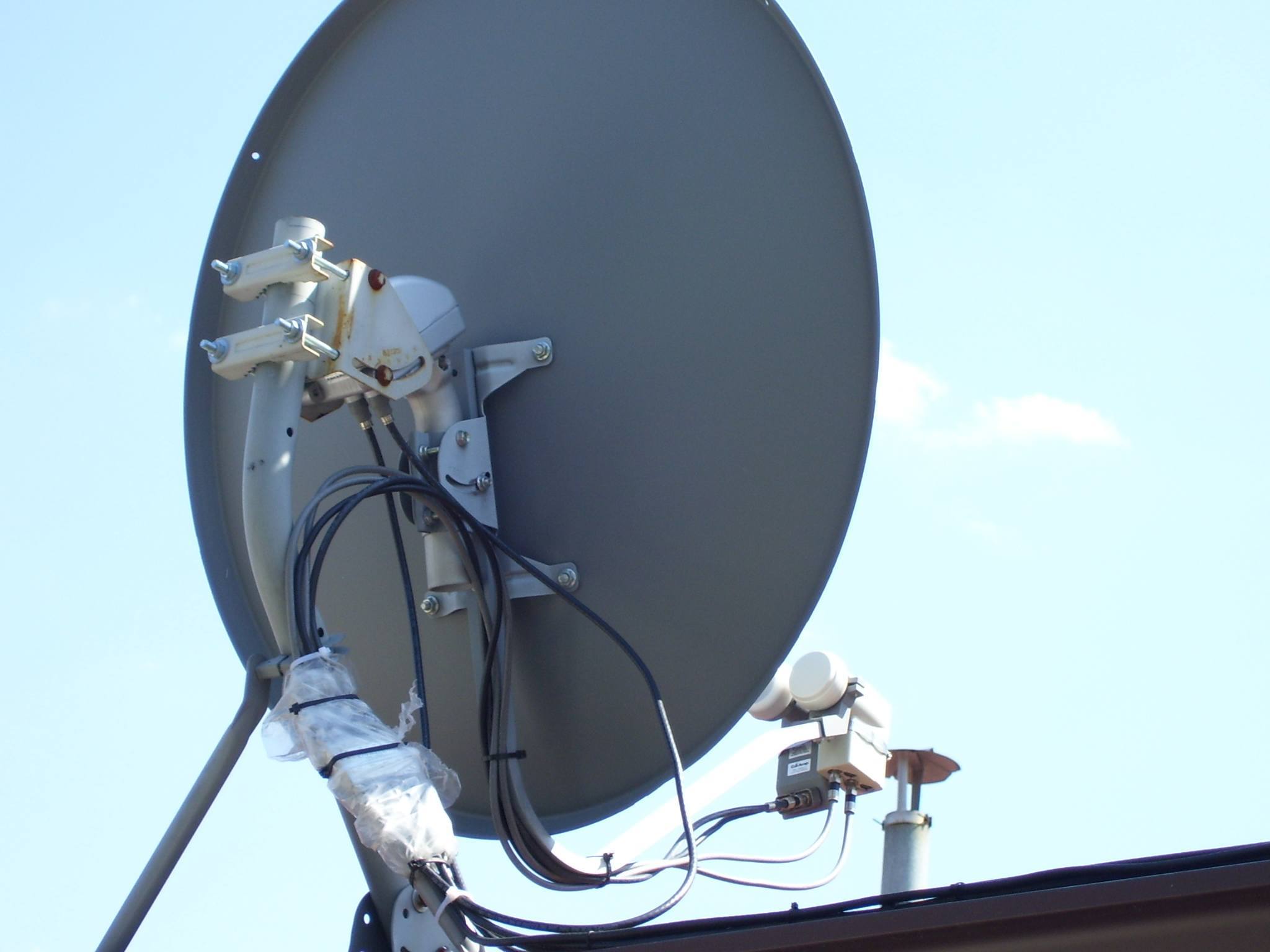

I also wrapped some plastic around it at one time but that actually was worse as moisture got in and corroded the heck out of the connectors...
