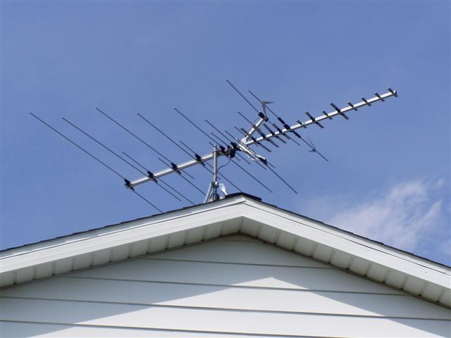

The enclosed picture is the combination mentioned above which I installed a few weeks ago. There is no rotor since all the stations are on one hill a few degrees apart. In your case a rotor is recommended to receive all the stations in your market.
For the out of market stations my suggestion would be the winegard hd8200p with hdp 269 preamp and rotor. I prefer the winegard over the cm3671. I compared the performance of both antennas last summer and the hd8200p worked alittle better.
The analog station WMPT channel 22 Annapolis, 40 miles away at 76 degrees should come in fine with the hd8200P. But you will definately need a rotor to fine tune. The digital probably will not be received but you will not know till you try. I was watching stations this evening at 55 miles with no problem. Mounting higher will improve signal.
If you are interested in decent fm reception, I suggest a separate fm antenna mounted below the combo. Radio shack sells a decent 6' antenna for about $25. I use a separate fm antenna below my hd8200P at home (Wade fm-9 see picture below which is about 9 '...the winegard makes a better one, the HD6065P and there are others).
