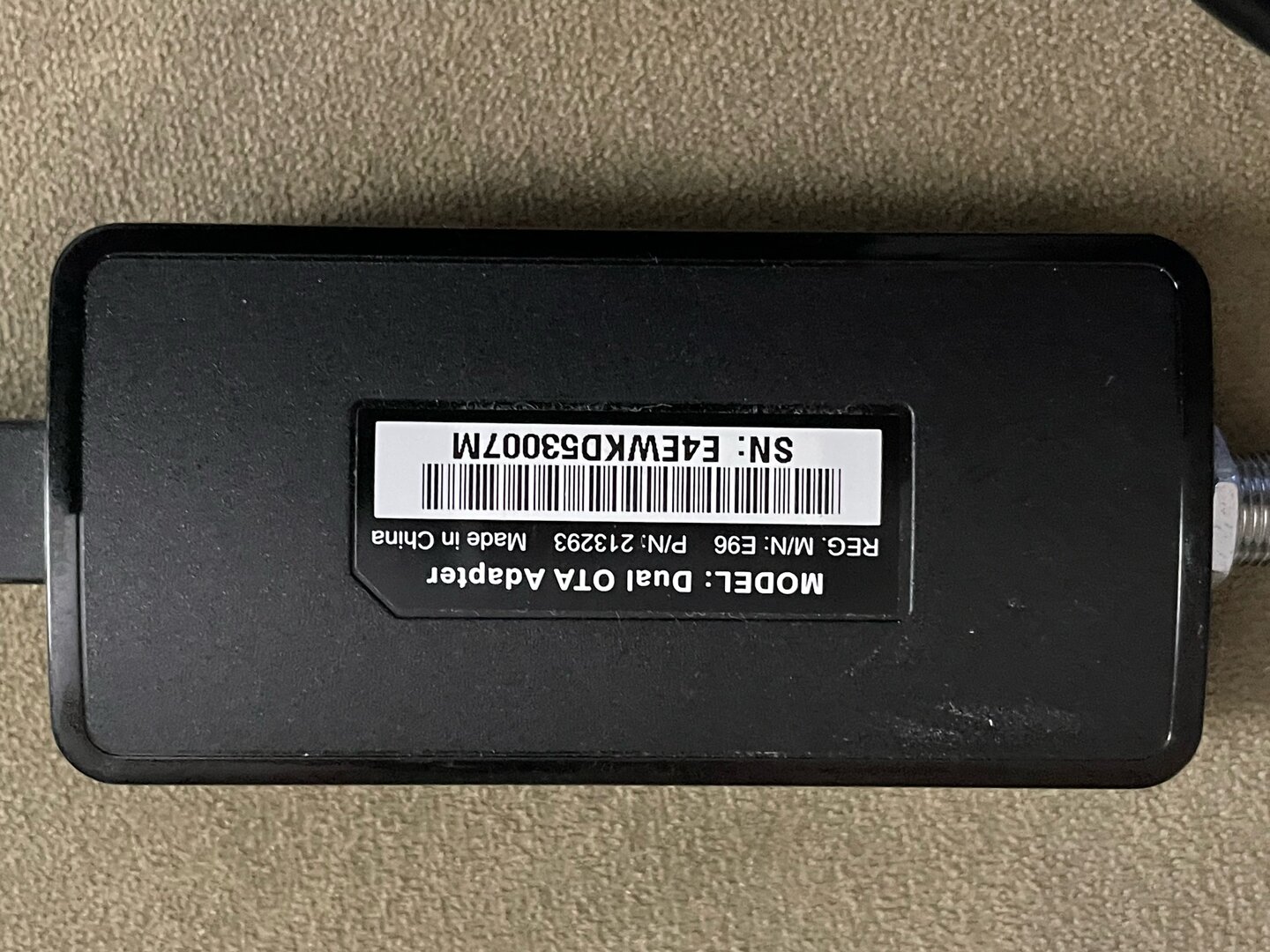

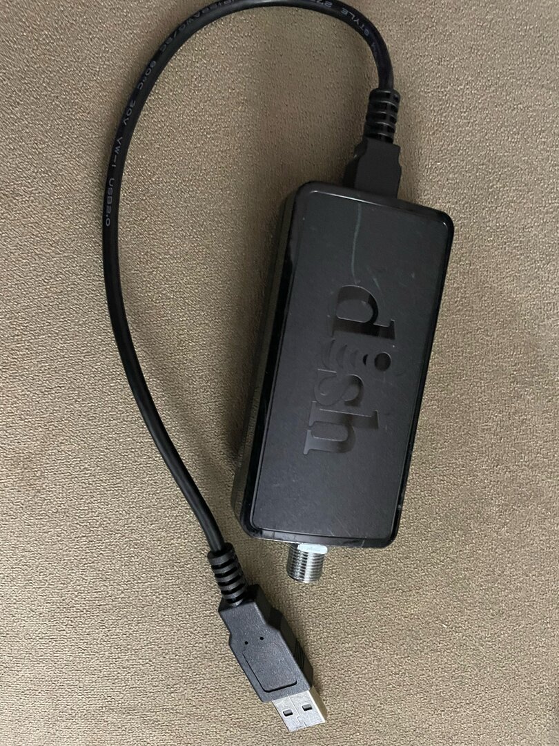

I have two of these. One is currently installed. I am planning to remove the one installed and do a hard reset and then install this one and see if the results get any better.

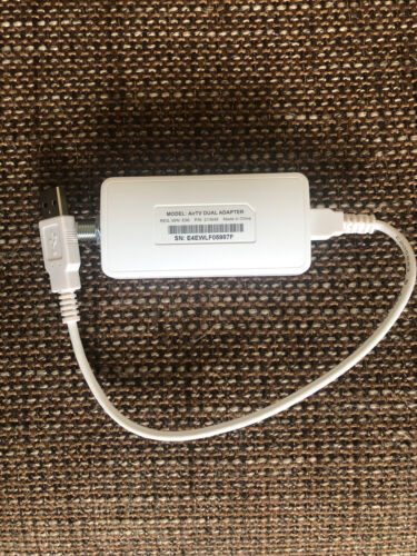

Is this the AirTv dual tuner you are talking about? I have been looking on EBAY and someone is selling this one but it says it does not work with Dish Network. I have the old Dish OTA dongle from a few years ago that runs super hot so I have not been using it.
That one looks just like mine and it DOES work with the Hopper 3.
So I took the OTA tuner from the H3 and disconnected it then did a hard reboot. I took the second tuner I had and connected it and the H3 recognized it and did another reboot and when it came back up I went to the OTA in settings and did a scan and this time I scanned 32 channels and this time I got FOX!!! Watching my Giants losing to the Igles as we speak in glorious OTA! No hiccups, pixilation or any problems. Other than the game that is :biggrin.
