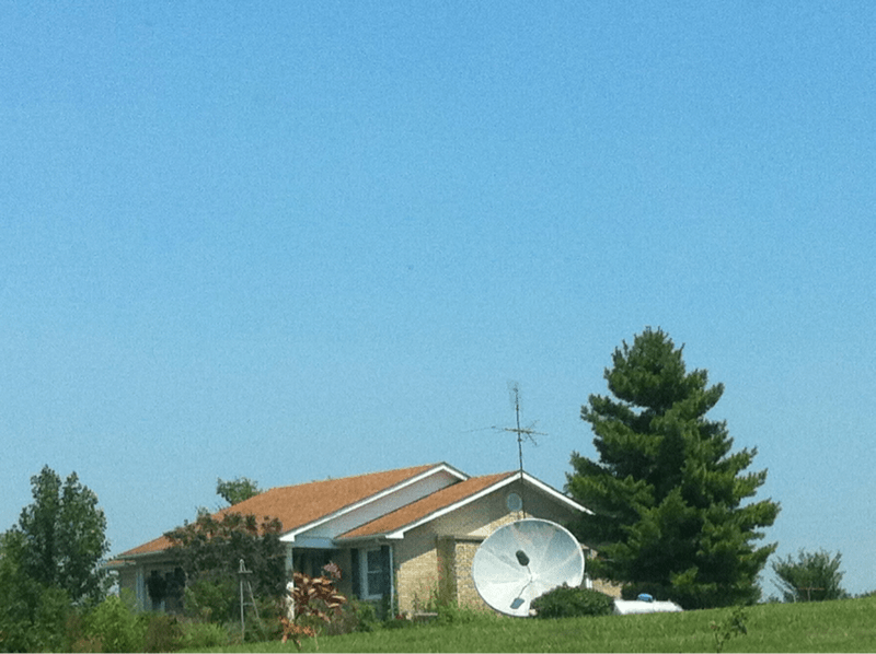

Here's a quick pick I took from the road. Not the greatest but that's the best I got right now.

Don't worry, Shmew22. Dishes are like buses. If you miss out on one, there will be another one along soon (paraphrase from a Gomer Pyle episode, yes I've been watching too much MeTV :D )...

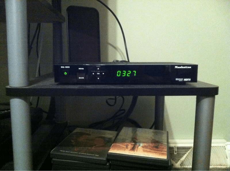

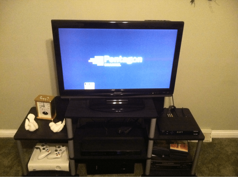

Got my manhattan today! Hooked it up, swung my dish to 101 and I'm watching pentagon in HD!!! Whoo! Well I have talked the folks into a BUD finally and I just gotta talk around and get me one.
