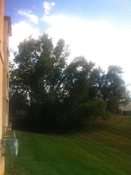

Hey all, I'm really wanting DIRECTV because of the content they provide is the best. Also I wanting an Asian international channel package that no other provider comes close to. Unfortunately I live in an apartment complex that only allows satellite dishes on the patio railling and my back patio door facing West. My question is if the top of the patio railing is aligned directly south where the satellite would be mounted would the HD Satellite and an Asian package Satellite have enough clearance for the 101W/110W and 95W? There's also trees 4 stories high 100-150ft in the LOS.
This picture is facing south just 2 feet right of where the patio railing is.

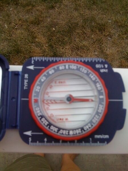

Here's a compass view. I know it's says North but that's really South. Maybe 3 degrees off 90.
I would definitely give it a try ...
the 99, 101 and 103 should be no problem and I would guess that the 95 will be reachable too :)
The trees I don't think will be a problem, the Sats come in much higher than the mast points.

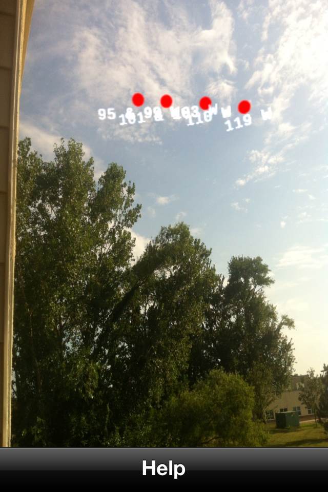

Here's what I found with the SAToolz DTV app:
It's going to be tight.
That don't look all that bad.

It can all be reached. Yes the 95 is close but you should be fine. Just have that picture available when the next guy tries to say "nope, can't be done" also make sure to have your consent from management so everything is there and the install can be completed without the installer trying to hassle you about something
