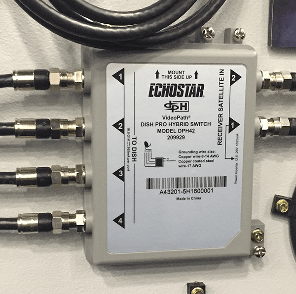

The planned switch for providing multiple H3's using ONE reflector looking at 4 sats is the DPH42 and was on display funtioning at--CEDIA, was it? A photo was published. At this time the target for release is for January, but we all know Dish. I am waiting on this switch along with others. The DPH42 will make it economical for Dish to install more than one H3 per account.
This DPH42 is desinged to work with the hybrid LNBF's and none of the existing Dish switches can function with the hybrid LNBF's. This is why no other switch but the fortcoming DPH42 will work with H3's. DPH stands for "Dish Pro Hybrid"
I expect Dish may announce this or have it on disply at CES in January. I went ahead and uploaded a pic of the new switch in use.
I'm wondering where you got that piece if information because I haven't heard that not have I ever seen any LNB's that get 118 that are Hybrid.
I heard that the DPH42 will use DPP LNB's and output DPH to 2 H3's. And that's why it's called DPH.
I guess we'll see when it comes out.
It does use both types of LNBs.
I had read that in an article I can't recall. Perhaps it will work with DPP LNBF's. The press has gotten wrong before or I remember it incorrectly. What you're suggesting makes sense.
Edit: Also just saw the post stating it will work with DPP LNBF's. Thanks for the correction. I prefer accurate info to my inaccurate info. :).
