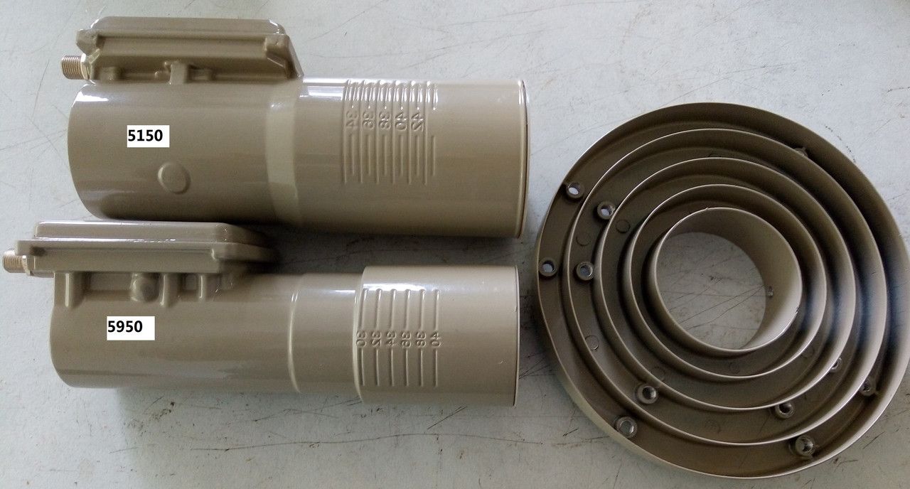

Show us more about those 5G scalar rings. I've seen a little discussion on those from a satellite hobby group from Latin America. They apparently have helped improve SNR a little bit without having to change out LNBFs or feedhorns. I looked them up on ebay au but they are pricey with shipping to the states.
The larger feedhord provides better illumination of the dish, lowers the phase noise. On an 8' dish you can get up to 1dB MER improvement.

Moving forward, recently commissioned Bangabandhu 1 at 119.1°E - LyngSat is downlinking at 4.5 to 4.9GHz the LNB has a Local Oscillator of 5950Mhz.
we also have a few satellites using that band in the Atlantic and Americas regions, primarily aimed at Latin America: Hispasat 6W30 @30W (but no video service that I'm aware of), SES6 @40W, Amazonas @61W and Eutelsat 65WA @65W
suitable LNBs can be obtained from Norsat but quite expensive, and I've seen some cheap LNBFs being sold by Brazilian resellers.
C Band LNB 5150 and a 5950 STARGOLD SG-5950 PRO Made by Gospel Shenzhen
