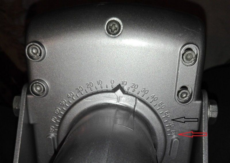

I have this motor technomate tm-2600 m3
but when i turn by switch or receiver not turn full range !! :oldfrown its stop on 65 degrees ( black arrow ) not in the end range 80 ( red arrow ) see the photo IMG_2017062902.jpg :hail
how can solve this problem :helpsign:help

Welcome to Satellite Guys! I've never used this motor and couldn't find a manual online for it. First check the software limits in your satellite receiver. I also found the following review that mentions a pair of hidden sliders on the motor that adjust the hardware limits.
Technomate TM-2600 Super review | TechRadar
Also, I believe USALS has a limit as to how far east/west it can accurately calculate. I have seen threads that mention using Disecq 1.2 to go a little farther east/west. Let us know how it went. :)

thank you my friend :hatsoff
i try to using Disecq 1.2 to go a little farther east/west but not success :coco
can you give me more information abut this ( step by step ) maybe i do it wrong :angel2

my friend
i fix the motor but i don't reach the all west satellites it stop at nilesat 7.3W !! so loss Eutelsat 8 / 8 W & Express-AM44 /11 W & SES-4 / 22 W and in East AsiaSat 5 / 100.5 E & ABS-7 / 116 E :hiding:onstrike

Did you mean 70 degrees Hour Angle difference or 70 degrees azimuthdifference from the south?
For Bahrein (26N, 50.5E), 70 degrees (motor-)HourAngle is equivalent to 77 degrees azimuth, a satellite at that angle would be at elevation 16 degrees above horizon.
ash101:
22W would be at 80.2 local hour angle, at elevation 7 degrees; that is really low!
Did you, as FTA4PA suggested, disable soft limits, and/or looked for the hard limits?
greetz,
A33
Edit: BTW If you would want to enlarge the motor angle range, see for example this little project by Trust : DXtv.de | Motoren allgemein | Drehbereich erweiterung Disecq motor
Don't know if the same method would be useable with your motor, though.
Referencing +/- 70 degree orbital slot from the apex. Actual look angle range is also determined by the install location's latitude.
I also have removed the mechanical stops in some motor designs. Some were very conservative with the factory settings. :)
