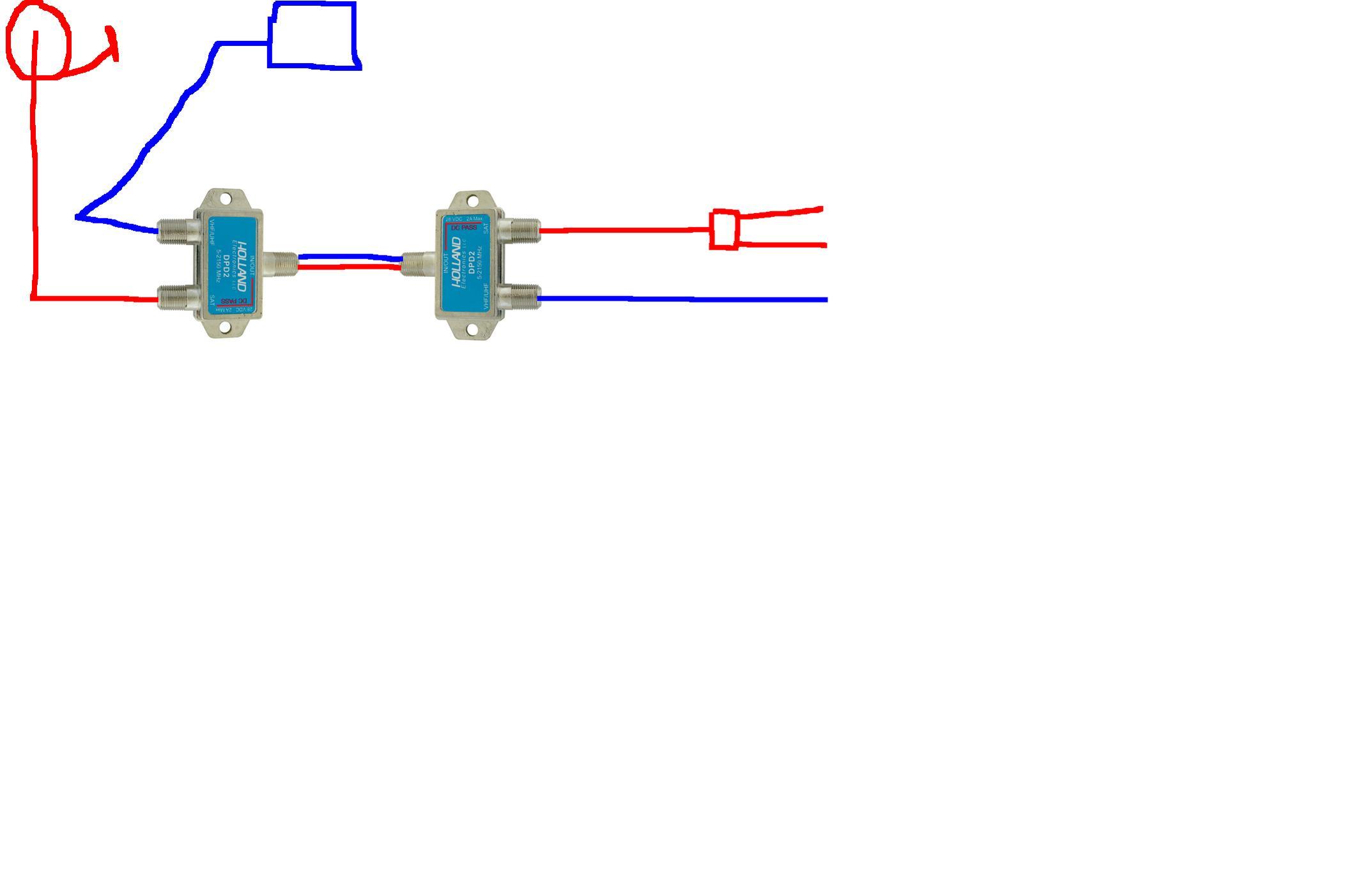

Look at the crude pick i made if diplexers are used it shuld look sumting like that Blue is for Tv#2 SD remote only and Red is the sat signal what you wuld do is unplug recever and disconect the diplexer from the single cable coming out of your wall...
Next conect the cable coming out of your Tv # 2 location to the diplexer... Do not plug it in ... Then go out side/ under and remove the tv #2 line (shuld say UHF/VHf and place it in the single side of the diplexer and the line that was on the single side into the UHF/VHF side and plug recever in.... then press menu 611 and run check switch if no sat is found you have messed with the rong diplexer out side just revers what you did on the first one and then do the same to the next one and run the check once more..
Good luck post back if the tech installed it difrently like placing a power inserter on the line with the HD witch he shuld have not done
