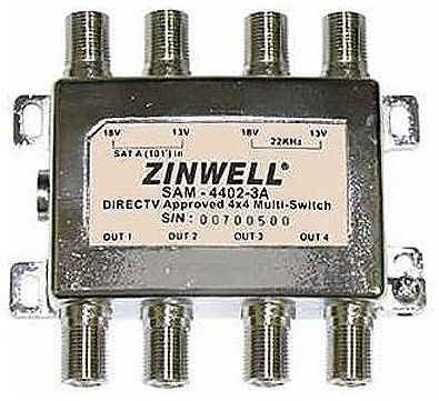

OK, I need you to help me with the final connections to the switch with 2 separate scenarios since I don't know what dish is there currently.
Scenario 1) I have my 4x4 switch and two dual LNB dishes, one that needs to get the networks, and the other to get local channels.
Scenario 2) I have my 4x4 switch and one dual LNB dishe and one single LNB dish, one that needs to get the networks, and the other to get local channels.
I've attached an image of what I'm looking at so you can be as specific as possible.
Thanks!
Buster
No, the meter in the receiver will work fine.
In either case run both outputs from the main (national) networks dish to the 2 inputs on the left side. (the NON-22khz ones) It doesn't matter which LNB out goes to which input.
Then, just run a single coax from the other (locals) dish into the 18V 22khz input - if you have a dual out LNB, just use either output.
BUT, peak the 2nd dish FIRST, then connect as I already told you above...
It REALLY is as simple as I already described before... :D ;)
