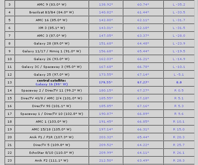

I don't have a t-90 but I was running some numbers from my location (48.4N) and it says I could get from a 44 degree arc when it is centered close to true south, and up to about 48 degree arc when centered farther east or west.
Then I ran some for Edmonton AB (53.5N) and got a range or arc from 48 to 52 degrees with 48 being true south. Then Mexico City (19.4N) get only about 22 degrees centered TS to 55 degrees centered farther east.
All sats showed between + and - 25 on the guide bar.
Definitely seems to be related to how far you are from the equator.

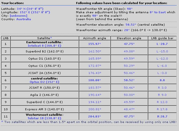

I've attached a "satlex" output near enough for Mexico City.
All this proves is that the WaveFrontier Toroidals can only be successfully used on one side or the other of the Clarke Belt, but not across the top.
If you look at the elevation figures, you will see that they decrease either side of the central Sat. This is consistent with the Clarke Belt, but cannot be achieved by tilting the dish to change the elevation.
I postulate that the claims, cannot be achieved in practice.
I've given this quite a lot of thought and searched the web, and this is the only feasible argument to explain the inconsistencies.
Thank you for your input and interest,
Kindest Regards, " The Druid ".....:eureka

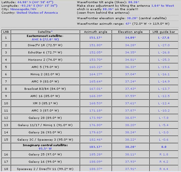

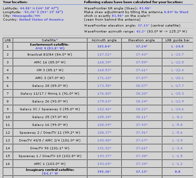

I had both sides of the clarke belt on my T90 with no issues. I went from 72-111 (even 119) with my T90 and I am in Minneapolis, MN (true south 93W also my centre LNB). You can tilt the dish to get both sides of the belt no matter what the elevation is. Plenty of folks have used the T90 with oddball elevations. Oddball meaning their centre LNB has a skew already.

I've attached the relevant parts of the two lots of your data.
In the first you are only 10 degrees off due South for your central Sat.
This means you only have about 2 degree error in elevation at the 83 end from your central Sat.
The other one where you cover 72 to 119, would give an error in elevation of 8 degrees from your central Sat.
This reinforces my contention that you cannot get optimum across the top of the Clarke Belt and why many are having problems setting them up.
As far as your setup is concerned, "If it ain't broke, don't fix it."
actually my venter sat IS my true south. Here in the US from 111 to 123 is a wasteland on KU so I have 123 on a separate dish. Actually 105 is the end of KU for a while (107,110,111 are subscription satellites)
nope. Kept the setup as is. I added a piece of wood to extend the bar to get 119 which is a subscription satellite here (but NASA is FTA)

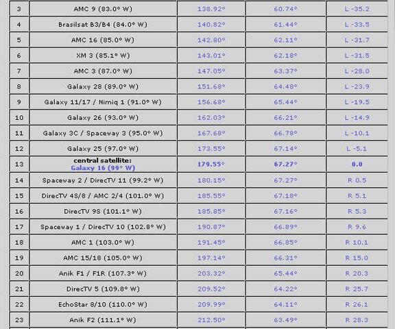

Satlex program errors.
G'Day Cobbers,
Thanks to your input, it has become increasingly obvious that the error is in the program when looking from the South. When I change the view to looking to the South with the same Sats and longitude, the figures appear realistic.
As a matter of interest I attach the relevant charts.
Again, many thanks for helping me solve this problem.
Kindest Regards, " The Druid ", aka Bill. :)
