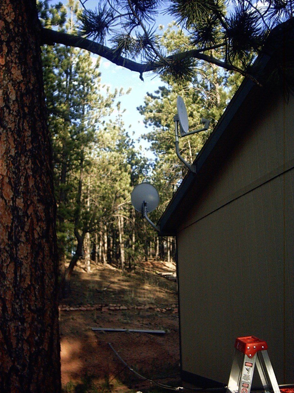

Assuming you're still talking about a single-eye BSS (circular polarization) bird, any change due skew is solely due to the change in location of the LNB. Sometimes a couple of inches makes a big difference - like when you're shooting a LOS like shown in the attachment (my 61.5 dish).

LOL! Very nice "pole extender" Simon! Couple of the guys I work with have taken to the idea of using pipe benders and modifying a typical D500 mast. Using a typical 6 foot fence post, they'll bend it to give a mast "elbow" and then run a few holes at the bottom to run the securing bolts to the footplate
You caught that, eh? Actually, it's a piece of exhaust pipe welded to a standard J-pole. Expedient, but not as pretty as the commercial long-J or S-poles.
