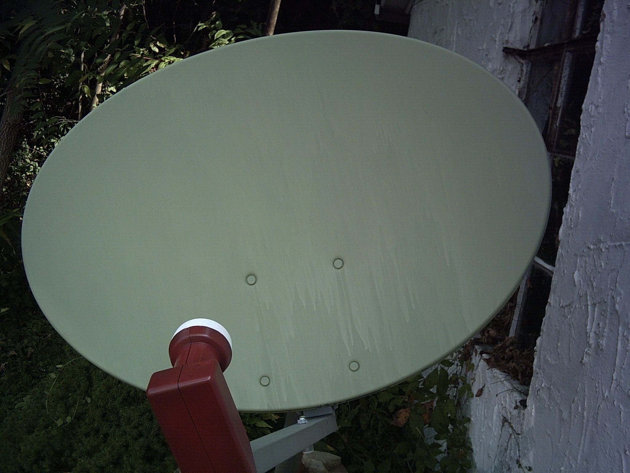

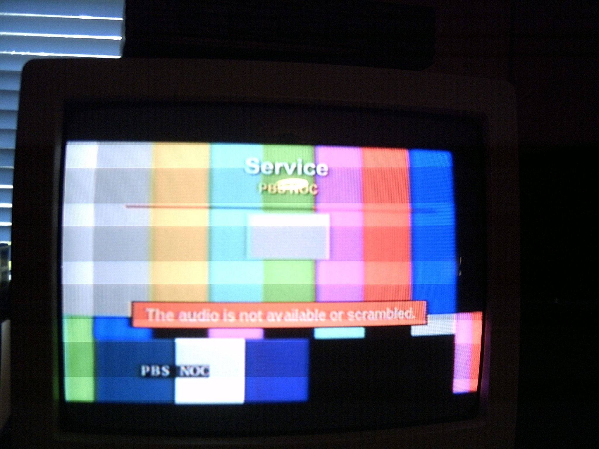

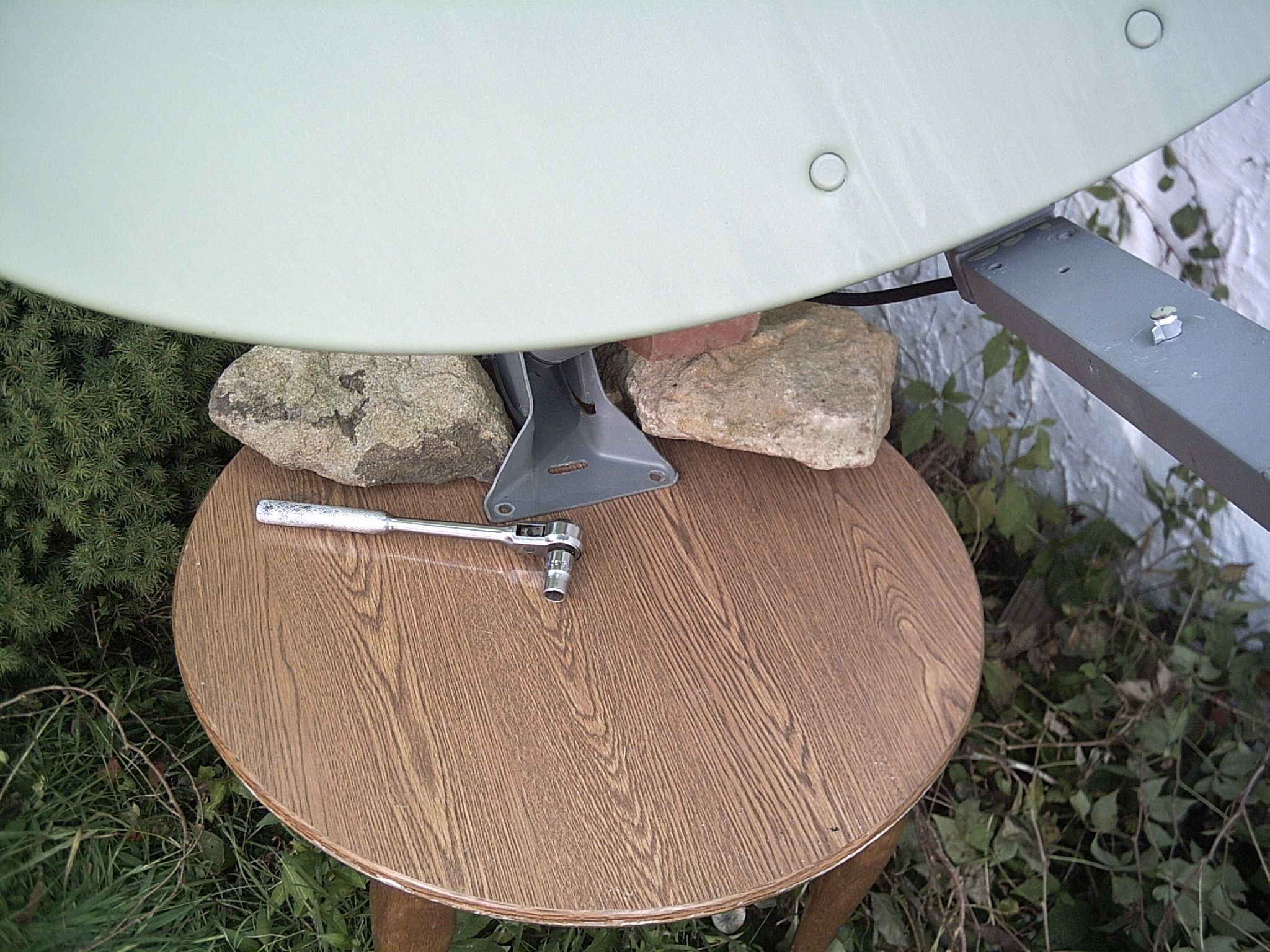

Superdish II Almost there!
Got the dish mounted and painted light green to match the 2.4 M Ku. Considering how to mount the bullet lnbf, when I exclaimed, "What was I thinking? (Hitting forehead with palm of hand). Why not just use an L-shaped unit? So I did, and it worked, at least for the strong TP on PBS 125 W. Saw that the lnb -- a 0.4 noise unit was kinda weatherbeaten, and liked the pictures Cadsulfide sent, one red lnbf professionally mounted and all, so I ran down to Walmart for spray paint. Boy, was I in for a nasty shock! The cans of paint that were 87 cents are now a buck 12!!!! AND...AND they were out of the little plastic stars I was going to decorate the dish with! Ah well.... quick paint job and started to aim. Found 125 quickly and skewed so as to get 12180. No Montana PBS, but really did not try very hard to peak, or receive 123. Here are a few pictures.

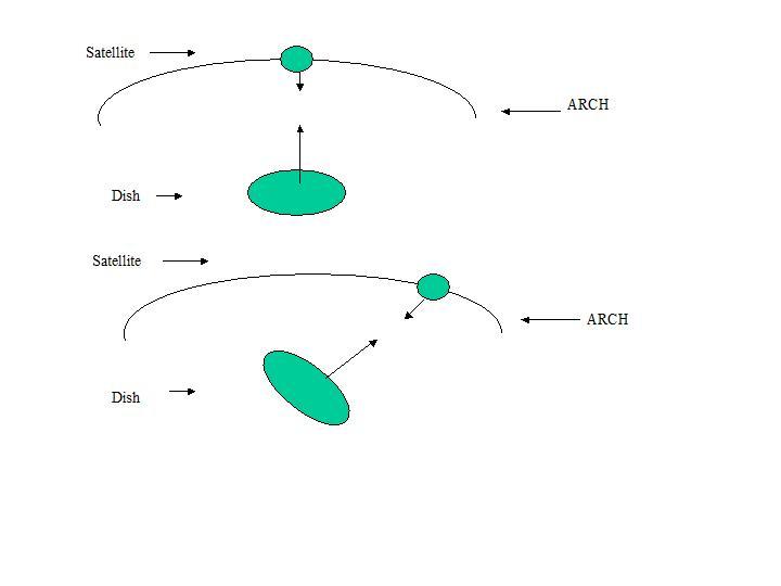

Dish Tilt/LNB Skew
I understood that the reflector face of a dish's vertical plane should be at a 90-degree angle to the satellite in Clark Belt arch for the maximum capture of signal for both circular and linear signals. Also for linear LNB's skew it is to keep the vertical pick up element in the LNB perpendicular to the satellite for proper capture of the satellites' linear polarized signal.
Am I correct????

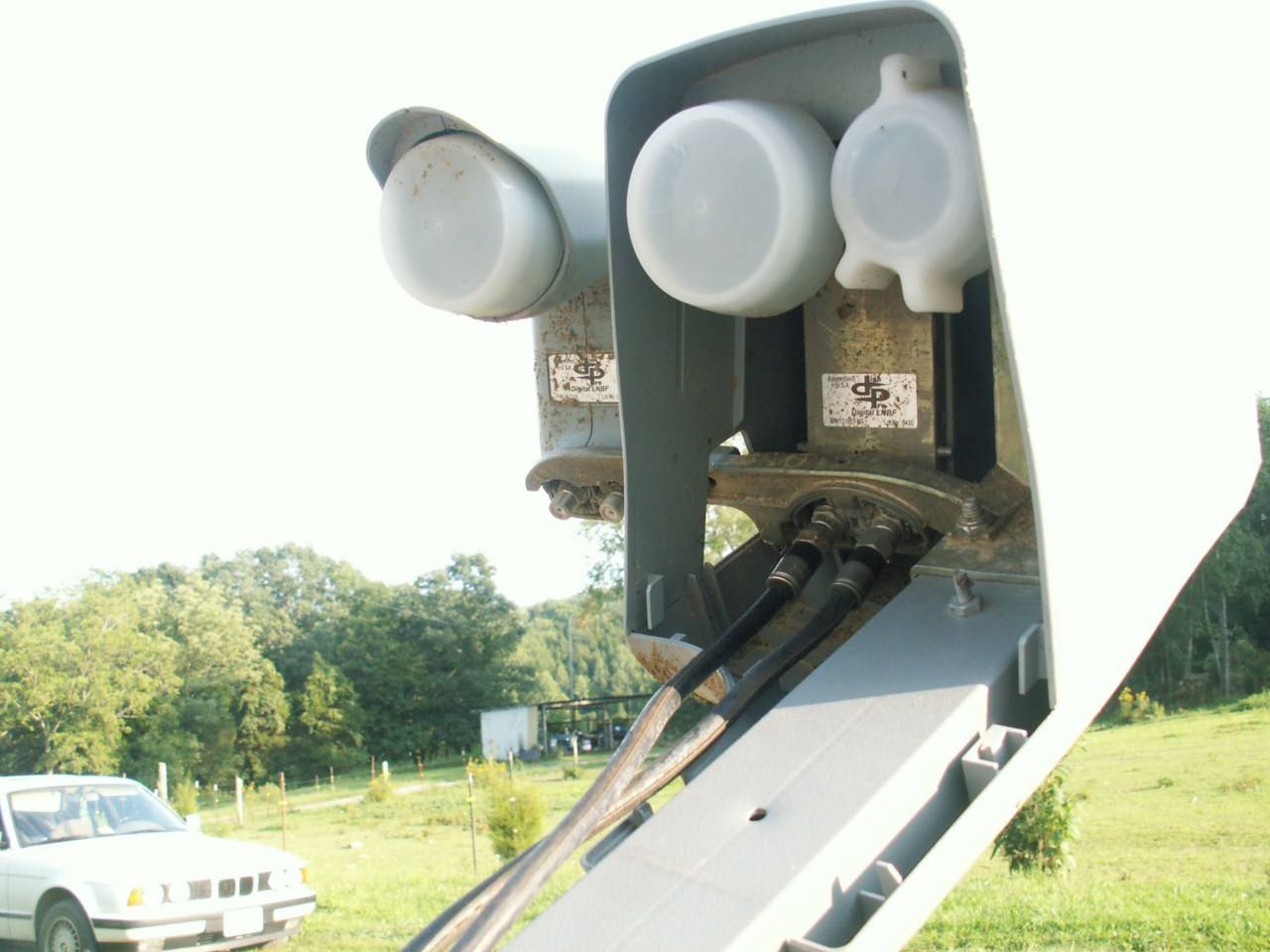

What about to mount the FSS stacked lnb alone in an lnb holder to be mounted on a 5.5 feet diam. dish. With this dish size, would be of any difference in performance to change the elliptical feedhorn for a round feedhorn and which one would fit it?
Thanks for any comments.
For Ku band, with a 5.5' dish any functioning lnb would work fine. Of course the feedhorn the dish came with would give the best performance, but with that much collector area you would be good to go with almost anything if it were at the focal point. Furthermore it would be a great dish for additional lnb's. Do a search for Linuxmans excellent thread on getting the whole arc with fixed dishes.
If the dish is offset, then the round feedhorn with an F/D of .6 to .7 would probably perform best.
That would include the round feed with the three "fingers" from a SuperDish, shown below.
If the dish is prime feed, with the LNB in the middle and close to the dish, then your F/D is probably in the .3 to .4 range.
A feedhorn like the AF-120 from Invacom would be a better match to the dish.
A picture of your dish would settle the discussion.
