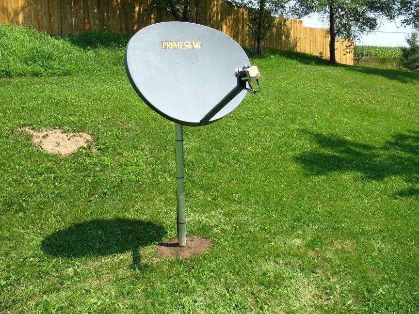

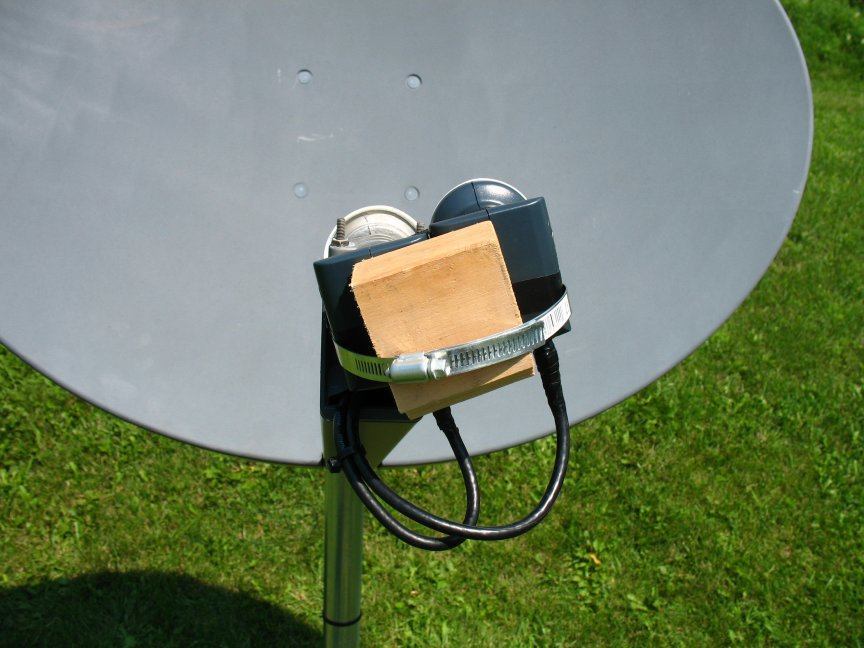

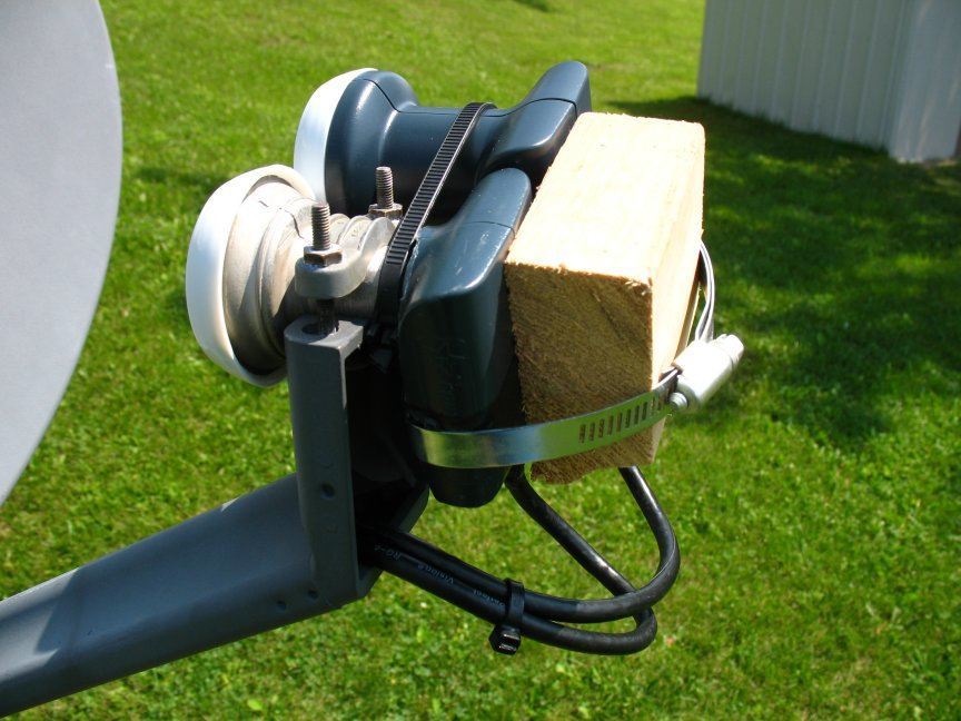

Here is my IA5/AMC-4 dish.

And why you need a piece of wood in the back of the LNBFs? Thanks.
The reason for the wood is that the hose clamp when tightened down, was forcing the 2 lnbs to "spread" so to speak. By placing the wood there, it put pressure on the LNBs , and filled the "extra space" in. Let me check those tp's and I will get right back.
OK, on IA-5 11966 I get 56 on the Neusat, and 70 on the Fortec. On AMC-4 12120 I get 53 Neusat and 65 on the Fortec. It is raining here now.
