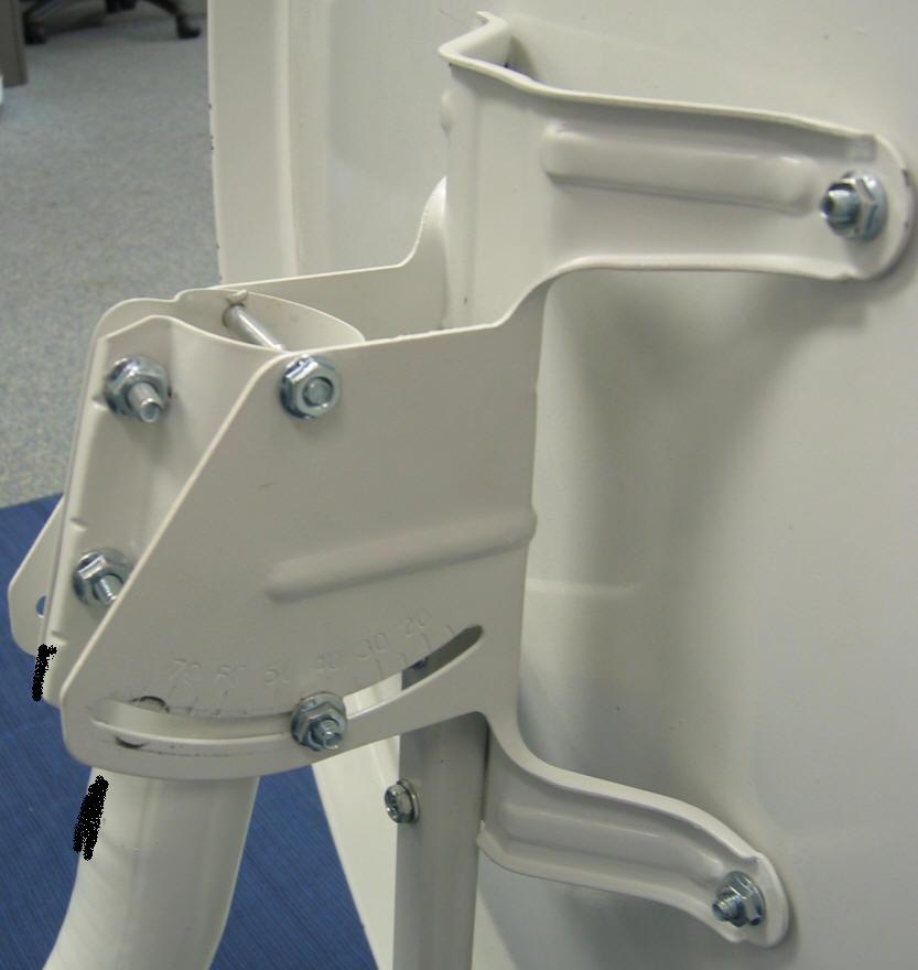

so you're 4 degrees away which if you draw a line on the mast of the dish (line it up with something like the bracket that can move) you would move less than 1/16" off that mark you made you will hit 125.
The mark also knows where you are on the arc
when I say 1/16" that is on the mast
see attached pic. When I had to move a dish one time I made a mark on the mast that lined up with another mark on the elevation bracket. Then I knew I was at X spot. I had to move the dish 6 degrees and on that mark it was 1/16" off that mark.
