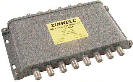

You can use the Zinwell WB68 switch. It is pretty cheap on e bay and requires no added power.
Thanks for the replies. I figured there was an issue with the multiswitch. When I connect two lines to my HD receiver it works fine, but my 401 receiver does not detect a signal. If I remove one line from the HD then the 401 will work. It seems as though only two lines are functioning out of the multiswitch.
You need to eliminate your present 2 X 2 multiswitch and replace it with a tone switch as mentioned above. Hook up your 2 lines coming from your LNBs to the 2 low voltage inputs on the new switch. F1R is Sat A
I called *C to find out what multiswitches they recommend. Tech told me I don't need a multiswitch just a splitter that will handle a minimum 1400 Mhz. So I left my current setup the same (orginal 2x2 outside), added the splitter to one line coming into the house, sent the two lines from the splitter to my HD receiver and it works fine.
