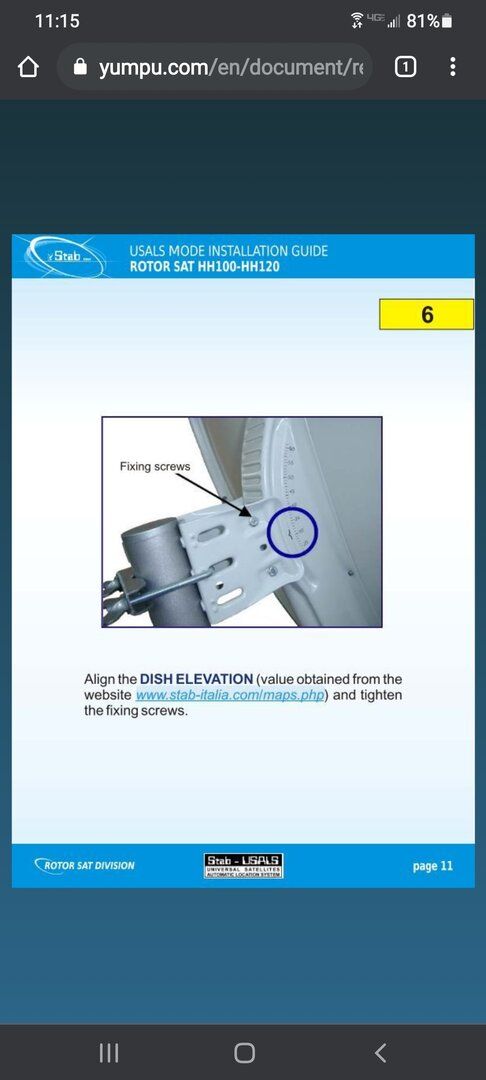

I just did the installation of my stab. It appears to be working fine.
But in the instructions and here on the website stab the instructions it says to set the dish elevation per instructions.
But it's a dead link I just set it at about 51° from when it was pointed at 97 west.
Do I need to re adjust the elevation if so where do I find that information.
Thanks Clayton
In my instructions for HH100 and HH120 they say to set the elevation at P(being the degrees of elevation for the fixed mount given by the dish manufacturer) minus (60 minus latitude).
Elevation = P - (60 - latitude)
Hope this helps!
Reactions: Moosebiker
Thanks I think I found it on satellite pointer .com
It's 40° every satellite I searched its comes back with 40° dish elevation and 28.5 on motor which I already have setup with my address 90 stab motor. I just set dish elevation at 51° starting point.
