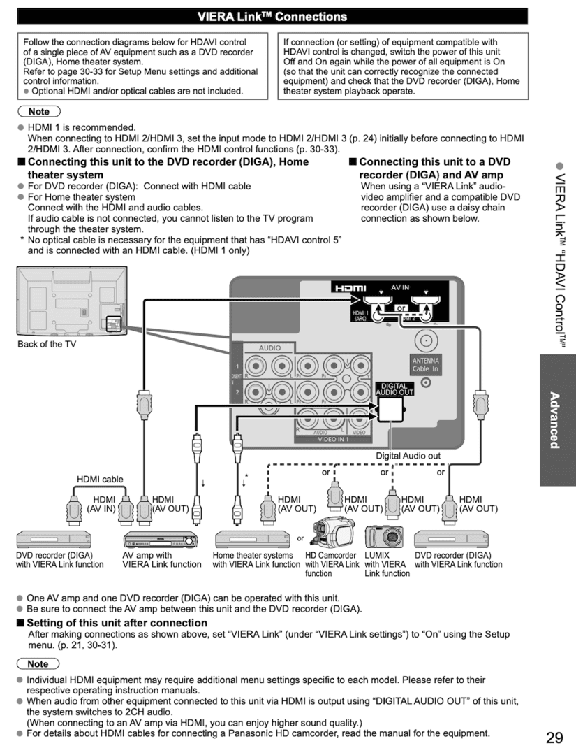

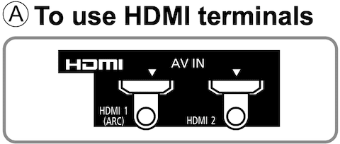

rabbitt83, I pulled up the PDF for your TV (it looks like one I might have considered for our bedroom; I ended up with a 40" Sony, but it's LCD, not plasma) and according to the manual, your HDMI 1 input supports ARC.
Panasonic doesn't refer to ARC in the Owner's Manual, but calls it "HDAVI Control™" as part of "VIERA Link™". Starting with Page 29, it talks about setting up the remote to control an external sound system, if that's any help.
The TV supports ARC and TOSLINK for surround sound output. The TCM and movies answer is a bit scary as this could mean legacy media formats. Pretty much all TCM content is monaural. Knowing whether the "movies" in question might involve surround sound would be very useful in making a recommendation.
The extractions (teeth pulling) will have to continue to find out how many of what kind of inputs are desired.
