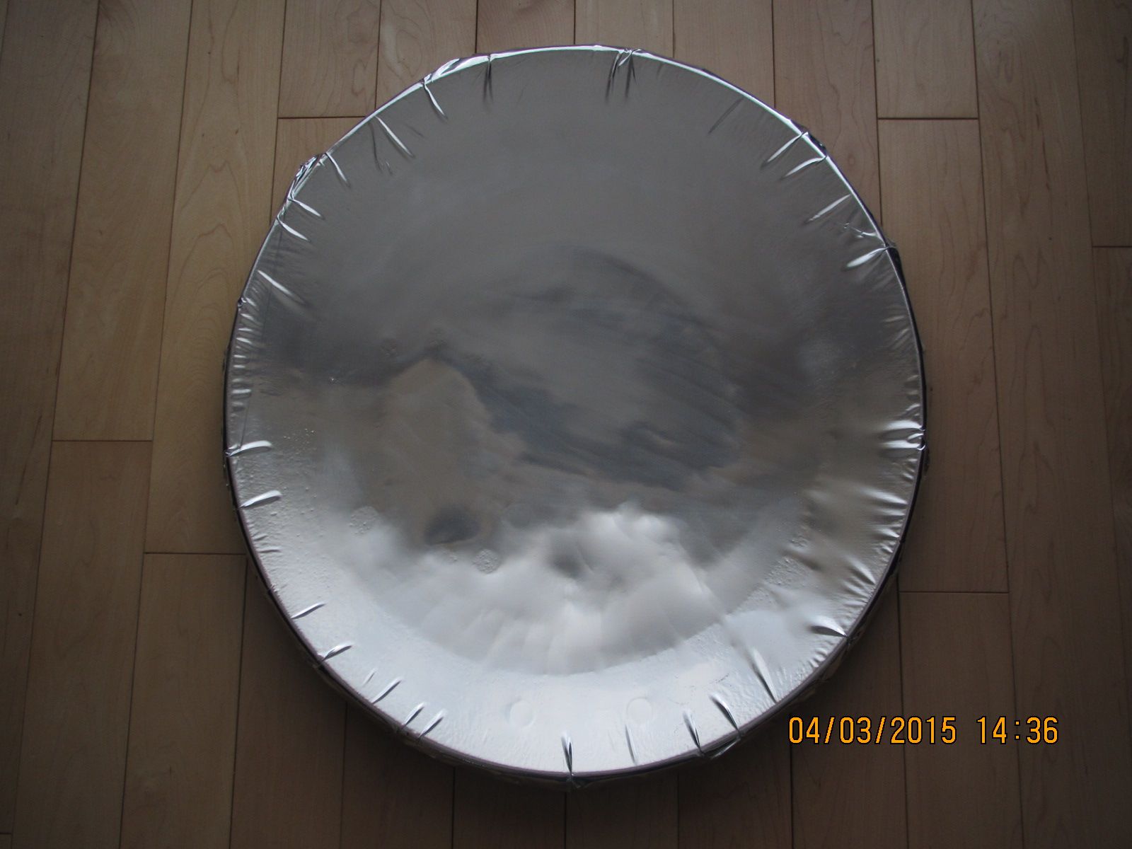

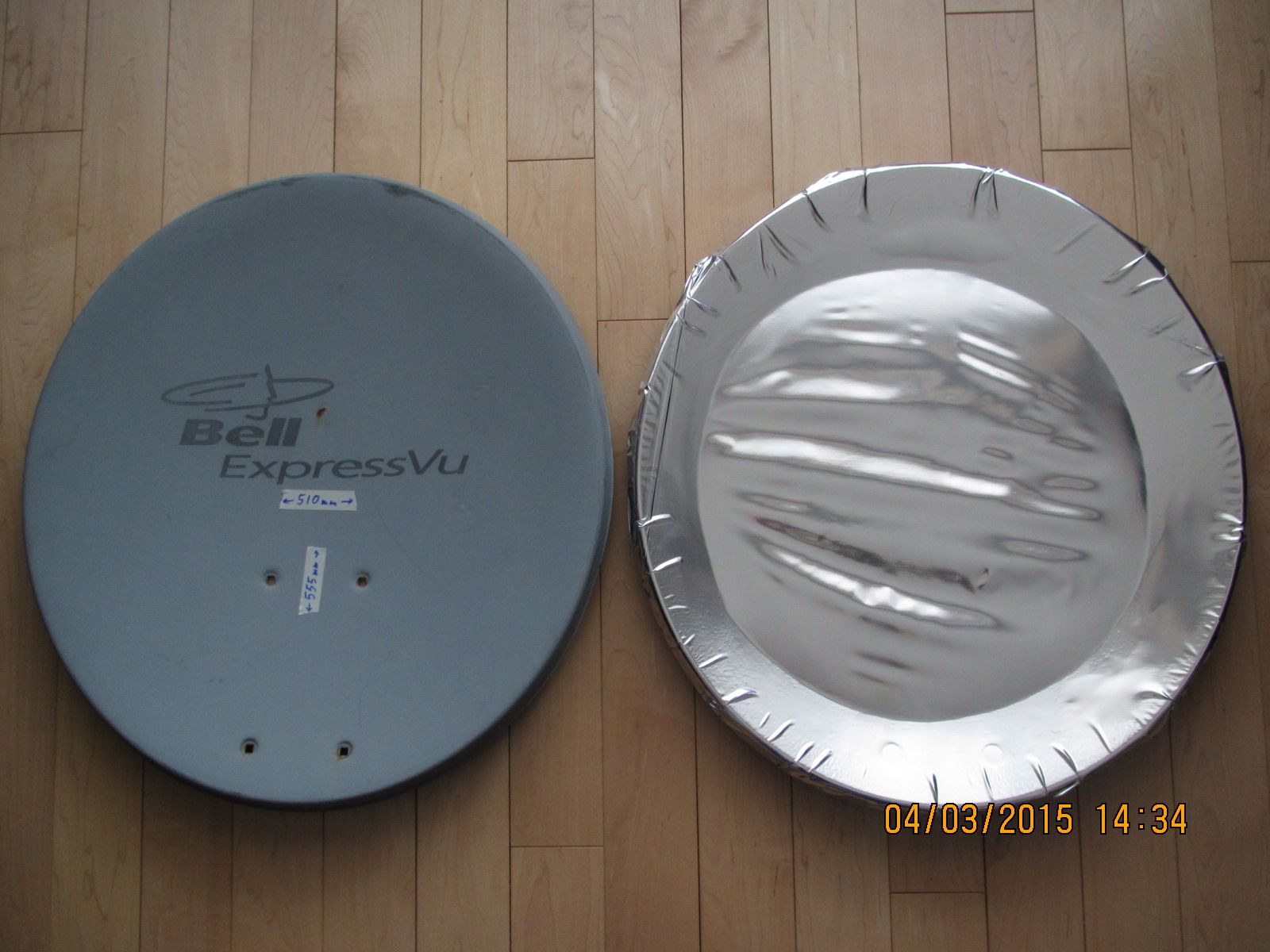

I tried to cover dish with aluminum foil of the type for insulating heating ducts.
Attempted to work it in, with fabrics gloves, from outside edges to inside, in a sort of spiral path.
The foil kept popping out.
Used heat gun, and made it stick to the dish.
Next day, noticed the foil popped out in the center (50 % of surface).
Pushed it in, now with fingers only, ( no heat gun).
But it popped out again. The dish surface was painted with a paint which is rather grainy, not smooth, and it did not let the foil glue to hold.
Other thing, the heat gun made the foil surface kind of matte, less reflective for light.
Another example, how NOT to do things...
Cheers, polgyver

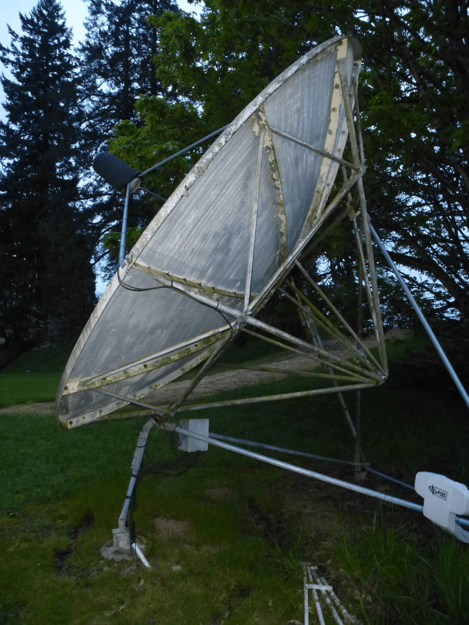

... I am now in the process of cutting 12 wedge shaped pieces of mirror film to glue to my 8.5'. Going to wait till after sunset to apply them.
Reactions: . Raine
I've got the 12 mirror film pieces cut. Rather than applying them all to the whole dish at once I decided to just test glue some of the small leftover scaps to make sure that it doesn't bubble and does OK outdoors. I'm trying some 3M Super 77 spray adhesive with 4 small scraps on the dish now.
If this doesn't work, any glue recommendations ? Liquid nails as suggested by Garyd?
The 3M Super 77 adhesive worked OK for the test with the small pieces, so I started applying the mirror film to the dish this evening after work. 1/2 of the dish is done. There was more wrinkling than I would have liked but it should work fine for this, especially since I'll be taking it off the Birdview when I'm done experimenting.

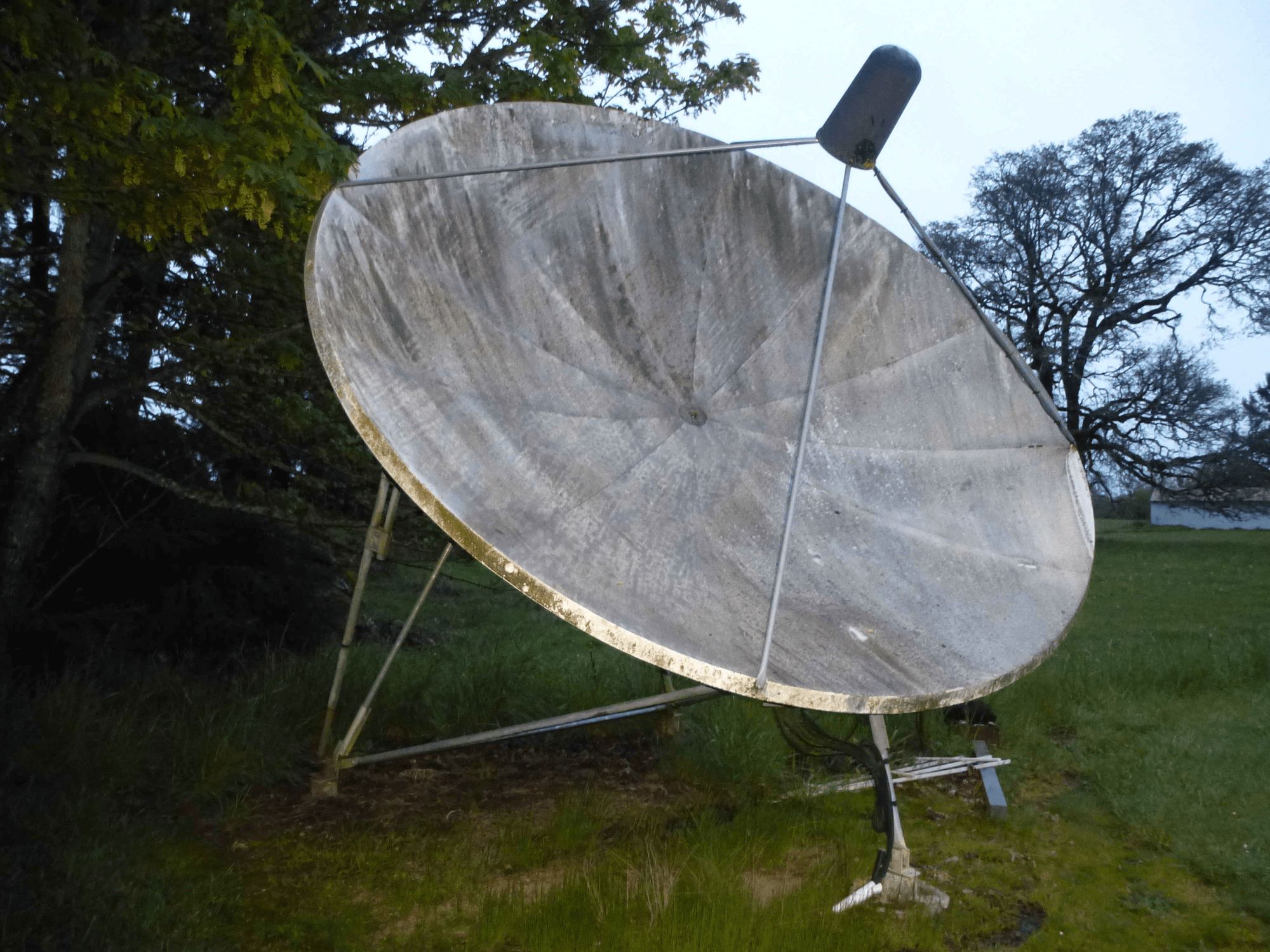

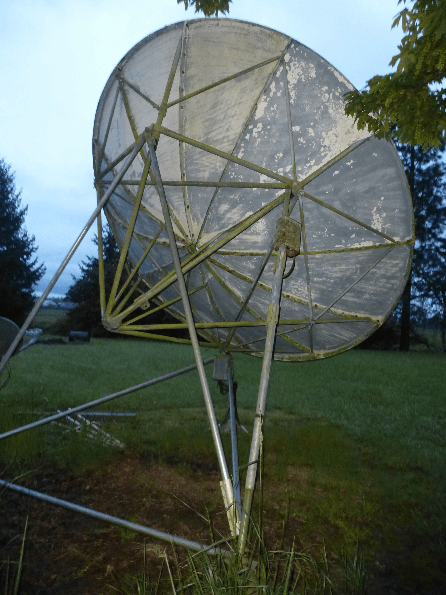

... At solar noon, 1:04 PM I had the dish aimed south at an elevation of 62 degrees. My first test was with a spray bottle to see if the focal point or the beam was visible in the mist (like in the video from an earlier post here). Unfortunately it wasn't. Either the background lighing was too bright or my beam wasn't sharp enough.
Next I stood on a ladder and placed a scrap piece of wood fence near the focal point. It ignited quickly.
Then I put two eggs in a cast iron skillet (given to me before I got married, not my wife's) and tried to reach over far enough to get the skillet bottom into the focal point. I simply could not hold the heavy skillet at a distance for more than a few seconds. My plan was to position the bottom of the skillet a few inches short of the focal point in order not to melt the iron.
I might try this again when the sun is much lower elevation, like 8:30 AM, so I don't have to stand on the ladder.
