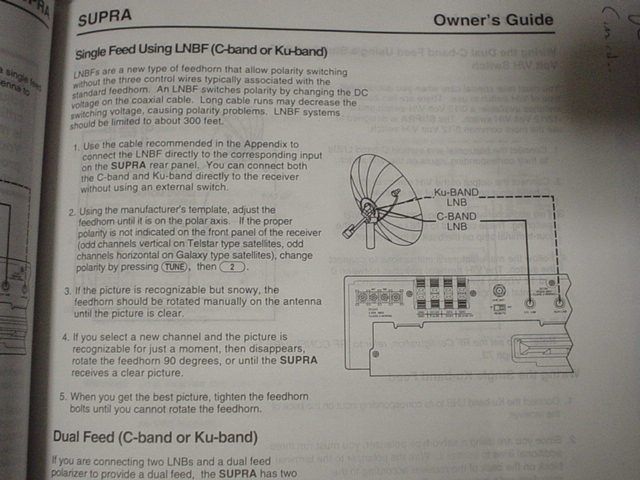

Most C band receivers manufactured in the past decade can operate a LNBF. Check in the menu of the Supra to see if there is an option. There are some really low priced C band LNBFs available. I bought a Gospell model to try on my 6' dish for $15 and it works great. Be sure to pick the LNBF with LO frequency of 5150 mhz, not a bandstacked model.

Corrado..Thanks for the tip. I did find it in the owner's manual. So let me get this correct. If I buy a C band only LNBF I will only use a coaxial cable to the DSR-410. The servo wires will not be needed. If I buy a C / Ku LNBF, does that use 2 coaxial cables from the dish to the receiver? One that I saw online looks like the signal is combined to one coax cable.
Here is what I am leaning to purchase:
c-LNBF - the best one that is easy to work with
DSR-410
Anything else I need? How about if I want to do FTA? What else should I purchase?
Sorry for all of the questions.
