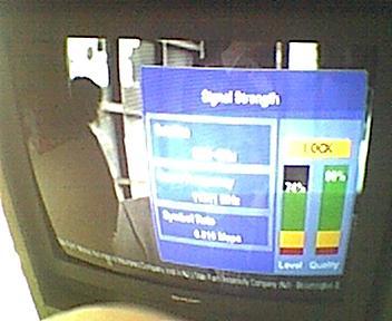

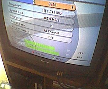

so every box is different. Here is one I did a while back. Same signal (ONN), same setup, 2 boxes (Pansat 1500 & Coolsat 4000). Look at signal difference
