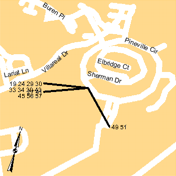

After moving the antenna around some more I was able to get 78 on RF 56 and can recieve a channel from every single rf except for 56 and 57, 56 being KRON. Don't know where I could move it to make it get any more signal. If you look at the picture attatched 56/57 is same direction as 45 and I can get 92 signal on 45. Am I doing something wrong?
