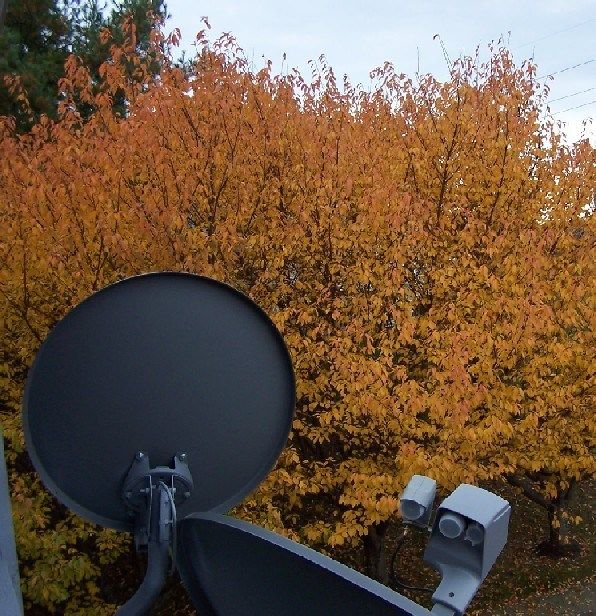

As others have stated the angle is a lot higher than it looks. Check out my 61.5 setup, looks like it was going straight into the tree. You just gotta give it a shot. I would at least have them attempt it instead of looking and throwing in the towel. Second, i wouldnt even worry with 129 and go for 61.5... you'd have higher sig, less issues and pick up a sweet high def aquarium on the demo channel
