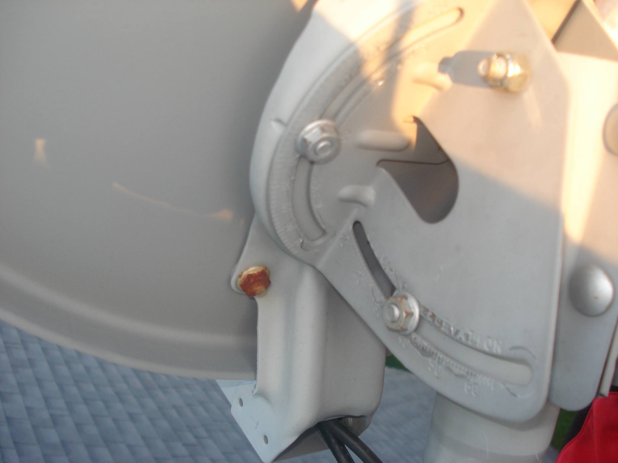

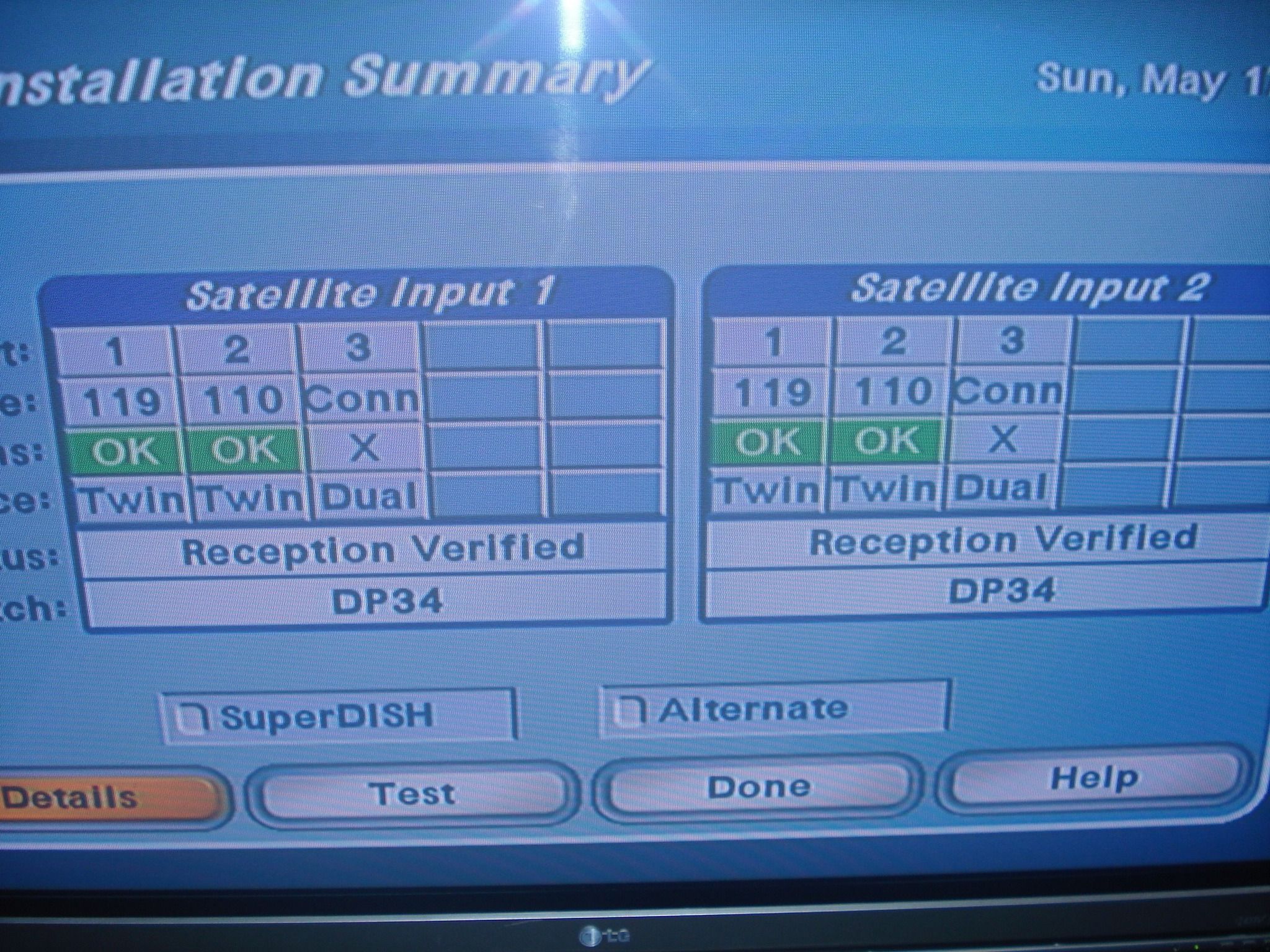

I have my sattlite pointed east zip code is 75116 on port 4 switch dp 34 menue screen reads port4 conn trans xxx az is set at 122 & ele set at 37 no signal reset 522 and disconnected cable and reconnected same statius.
Go back to your switch a DP34 has 3 inputs from the satellite and 4 outputs. Why are you on port 4 and how many lines do you have connected to a 522?

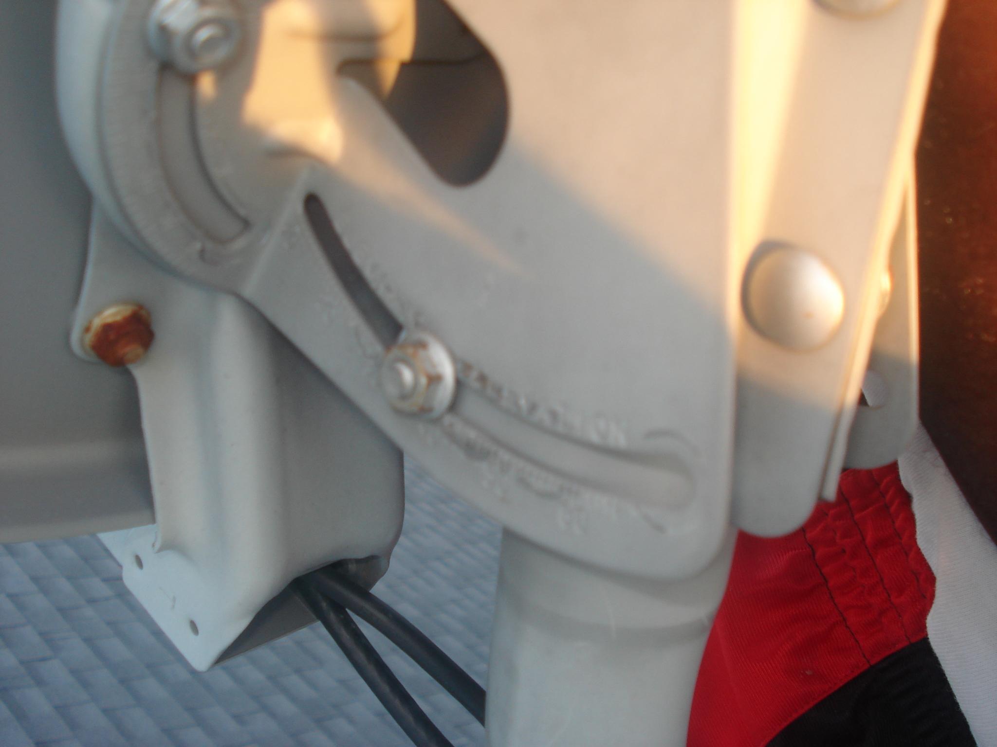

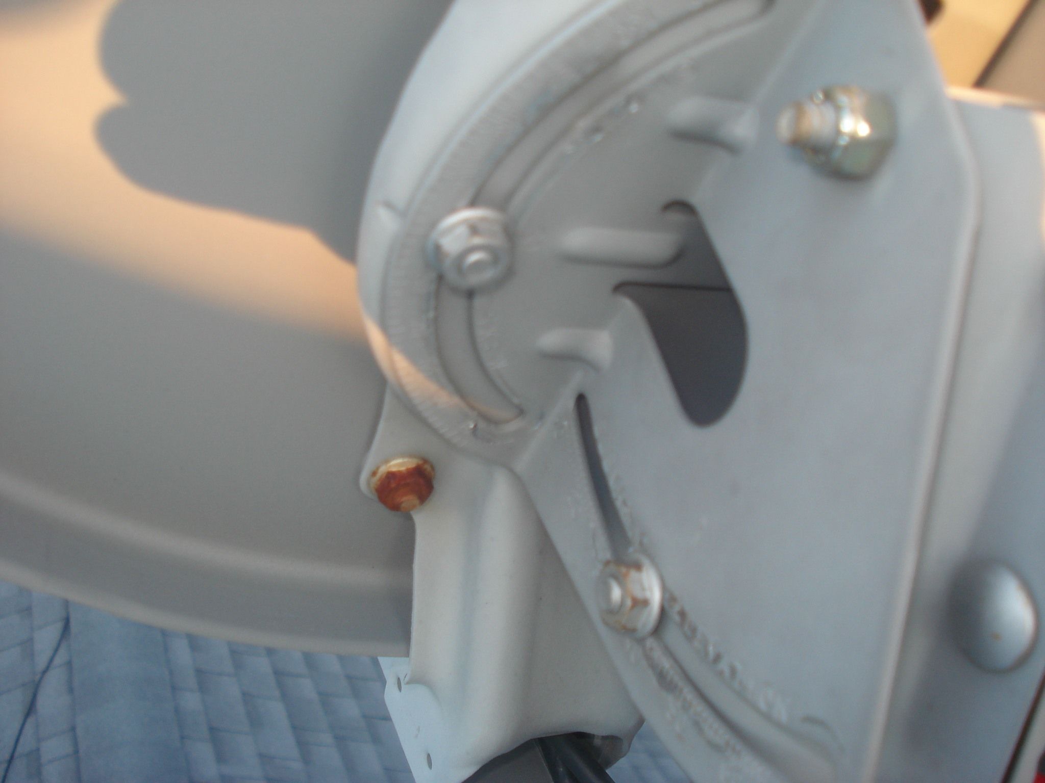

reset dish skew is 90

on a dish switch 119 goes to sat1 or dish 1, 110 goes to sat2 or dish2 rest of them are for more dish's. with that being said , to test you switch hook 119 up to port 3 if u get 119 then your switch is good . then its more then likely the lnb,. 61.5 is fairly easy to find. man this website needs a goto section for stuff. but it is the best one i have ever found !

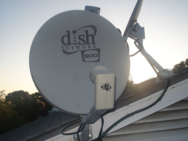

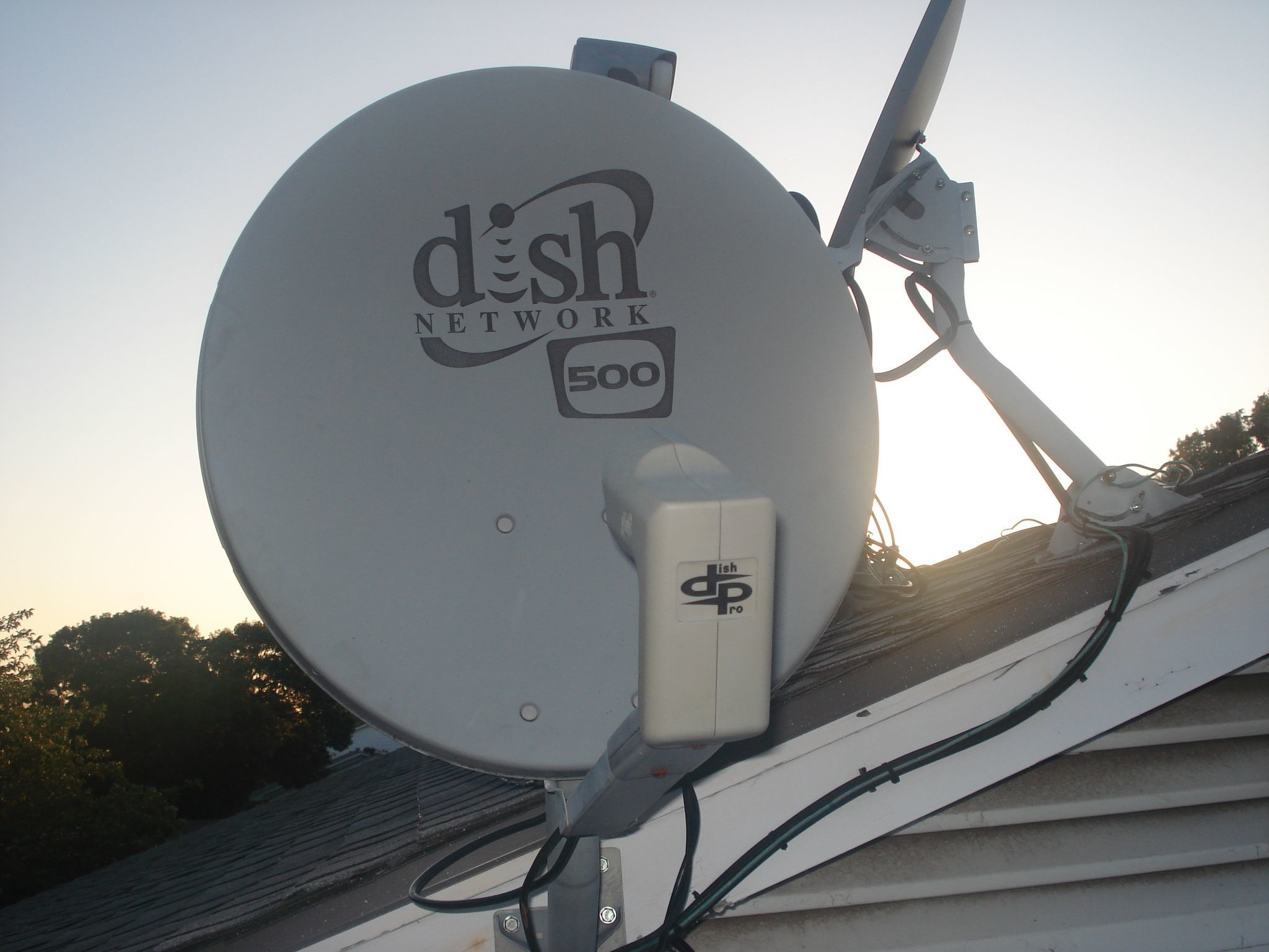

I took the lnb from the dish 500 exchanged it with the lnb on the dish 1000 worked fine set the az at 127 set the ele at 36 the az is about 3oclock east still no signal.
ok guys first let me thank all of you who were able to offer help thanks for the support, decided to call dish after 3 long days of trying to get 61.5 online, paid dish 29 dollars
to tweak all my dishes and find sat 61.5. I lacked one thing and that is I'm going to buy
a real compass I was off about 30 degree pointing sw experience teaches you one thing
be prepared the next time to have all your tool onboard again thanks everyone.
