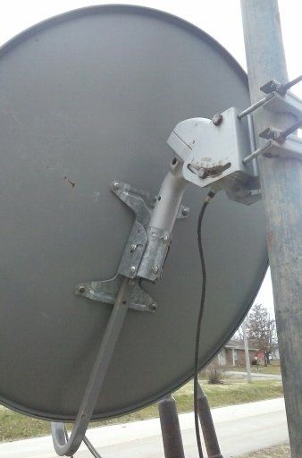

The dish that came with it, still mounted to a pole has "itbusa.net on it. Its about the size of standard Direct tv/Dish/etc dishes. If I understand it right, the "LNB" which is the thing pointing at the dish, has a Quad Polar Legacy 4 O/P lnb (thats whats written on it). I am not sure of its a C or Ku. It is more round and 34" across. Will try to post pictures of the dish and lnb shortly.

The pole that came with the dish is slipped over the old short pole that was here when i bought the place. Its a snug fit, but i can take the dish off and attach it to the pole thats cemented in (by dish or Direct tv...)

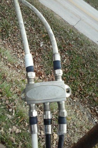

It has a 4 in 1 diseqc that has the cables plugged into it. Not sure if they are hooked up right, but I am guess from FaT Air's info, I only need a cable from the "L" marked lnb. There is a cable thats behind the dish, is that the motor? Where would that get connected?
I just did that with mine. I wanted a higher pole to get a clearer shot at the sky for my motorized ku dish. I had one that slipped right over the original DirecTV pole. As long as it's a snug fit (no play) and plumb you should be ok with that. It would be a good idea to drill a couple holes and put in some screws to keep it from turning on the other pole in case you get strong winds.
Good, you have a motor. That gives you a lot better choice of things to watch. You need to make sure the motor/dish assembly is rotated on the mast, as a whole unit, to your true south. Use dishpointer.com as FatAir said to find it. You can either use a compass or find a reference point on the ground that is on the line FatAir mentioned. One of the L connectors gets attached to the LNB in port on the motor. The other port on the motor goes to your receiver. PS: Make sure power is disconnected to receiver whenever attaching/removing cables from lnb, switches, etc as it may do damage if it isn't.

The top two go straight to lnb. On the bottom row, the left goes to lnb, middle one goes into the house/receiver, and the last on right is the motor wire. Can I bypass all of that and connect one of the "L" lnb to the other port on the motor? I couldnt see anything that said what the two ports were on the motor.

Yes, you can bypass the diseqc switch altogether (probably best when just starting out) and hook the lnb directly to the lnb in on the motor. Ports on motor should be marked in some way as lnb and receiver. Is there any label on the motor that shows brand/model?
FTA4PA-I didnt see anything saying what brand the motor is, but i did get up closer with ladder and found the ports labled. I used the diseqc to make the motor cable reach the cable running into the house. Motor is plugged into one marked for lnb. If that wont work, mayb I can buy a connector to make the two cables reach.
It isn't recommended to run a motor after the diseqc as most diseqc's aren't rated to pass the current that the motor will draw. Some can handle it, and I have heard of some people doing it, but best if you can extend the coax enough to get to the motor without it. If using a barrel connector
to extend the coax make sure you seal everything water-tight. I use this: http://www.lowes.com/pd_78453-98-2155_0__?productId=3129711 Also, make sure all the coax is good quality RG6, not RG59.:)
