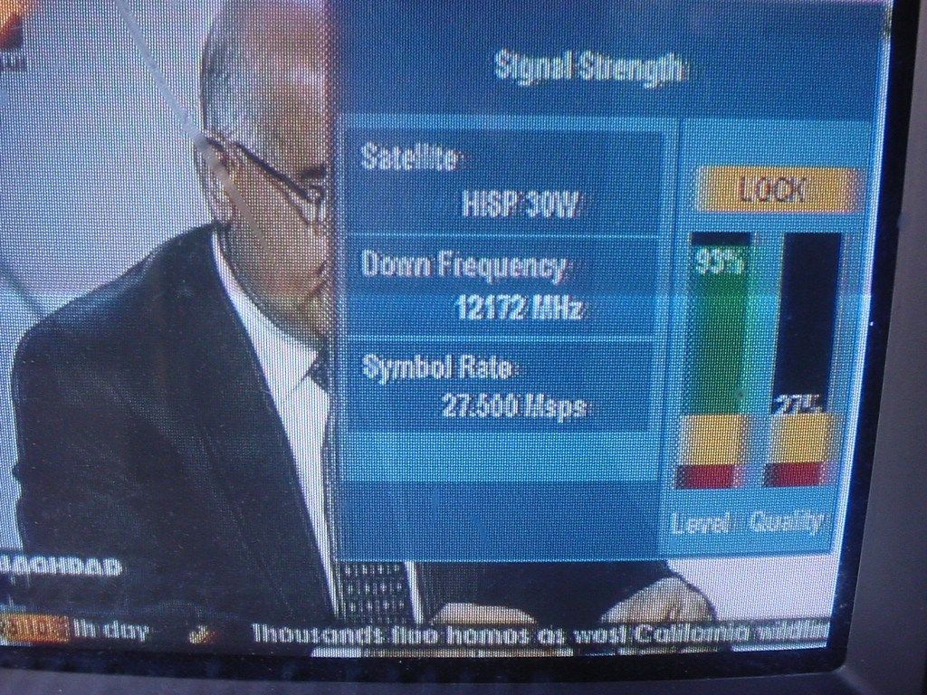

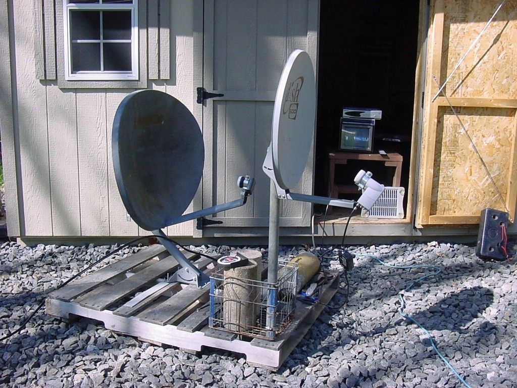

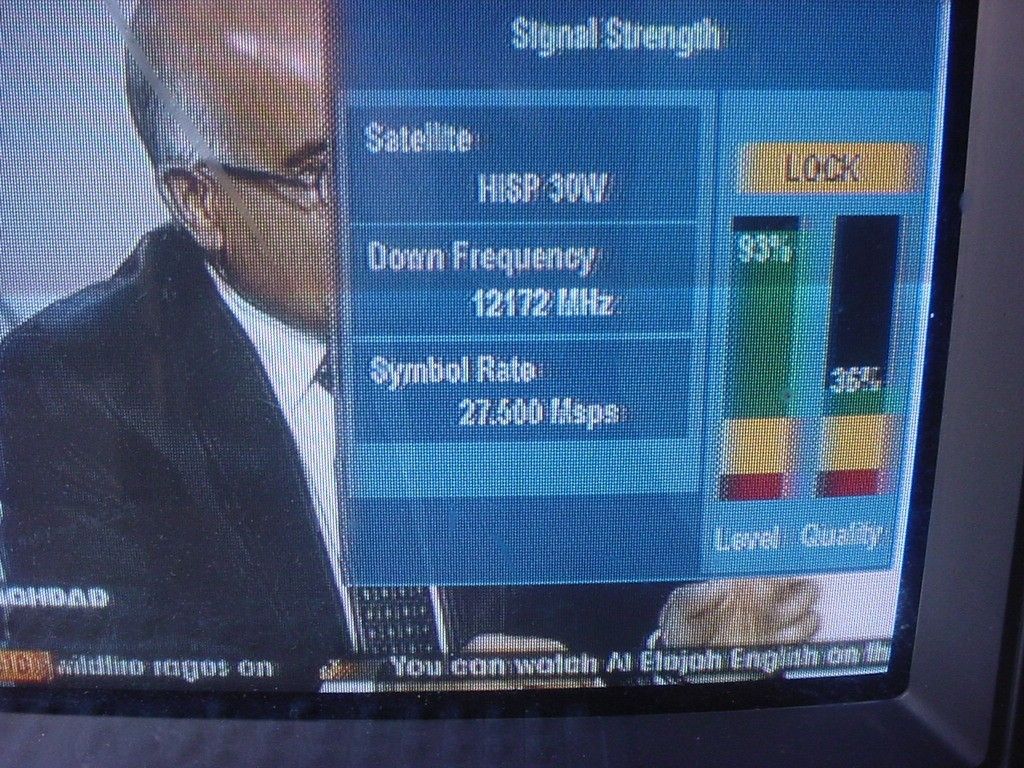

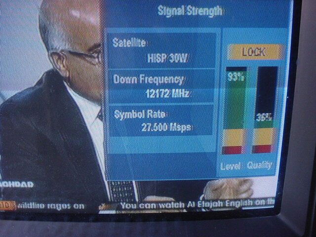

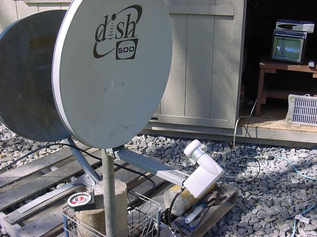

Even with the leaves coming on the trees, I gave it a try. I tried an old Primestar dish that I've used in the past at my test location for 30W and got the signal in about 30 seconds. Then once I knew it was possible I cycled through the ridiculously undersized dishes to see what was possible to rig up. Even a frankendish500 gave a watchable picture with fluctuating 30ish quality. The Primestar was around 80Q.
