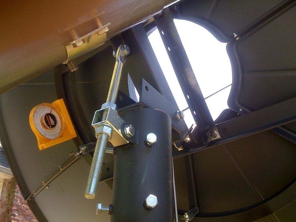

Where he's got the inclinometer is fine. (provided the pivot axis and where the inclinometer is stuck to are at right angles to each other...)
Do both of those surfaces of the inclinometer have a magnet on them? Mine doesn't. I wonder....
Nope mine only has a magnet on one side.

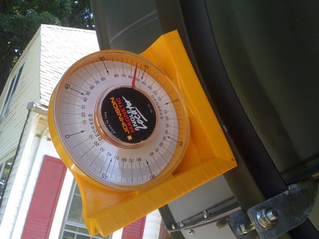

What are you using for your declination offset angle? That diagram is a little funky. What he calls elevation, is 90º - elevation....
For Latitude: 41.6927° Longitude: -72.7215°, I get a little less than 6.5º
If you measure on the back plane of the dish (that circular ring thing) it should measure 41.7º at TS. (With your angle finder oriented as pictured) On the polar mount, it should be less by 6.5º.

Ok we believe we have the elevation set correctly now. (We used Shawnn's method)
Now trying to figure out the declenation angle.
On my angle meter what should it be set to? 41.6 + 6.5?
Maybe if someone could talk us on the phone, as we are missing something. :)

Yep that's it>the declination will be right when its the sum of 1.site elevation & 2.delination offset. Around 48 on the angle meter. I'll pm you a phone # .

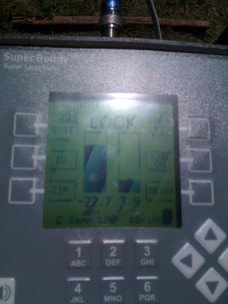

Well we hit a signal! Not the one I was looking for but a signal just the same.
58 degrees, Intelsat 9! :)
At least we know the LNB works, but something is still off.

We are working and are tracking the arc!
From 55 degrees all the way over to 105. With signals of around 70 on the SuperBuddy Meter.
We didn't try to go further yet.
We even got KU on my true South satellite of 72 degrees. (didnt try on other satellites yet)
It probably still needs to be tweeked a bit but we are very close, and since i have other things to do I am locking everything down and cleaning up the site.
Thanks to turbosat for his help, his idea of moving the motor and seeing whatelse I could hit was a very good one. :D :D

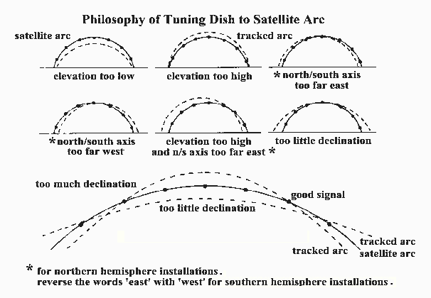

This will help you dial it in Scott.
