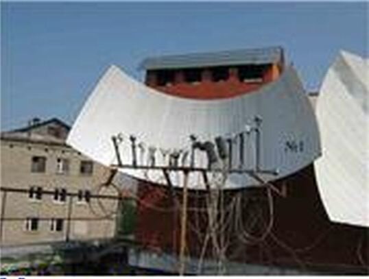

Not even sure, what they ask money for on that site but its true, generally polar mount doesn't need to be plum. One just needs to know how to set the dish & motor correctly given mount deviations from vertical in 2 perpendicular directions. And multifeed can be setup in a very unusual way too like on the above pics. But for a typical user, it ain't give any advantages, may be for a balcony or hard to reach wall mount it can help to compensate for some alignment errors. :) No sense to pay for it such huge price though.

To make you wonder even more, this dish doesn't need any adjustments, but...it works. :)
