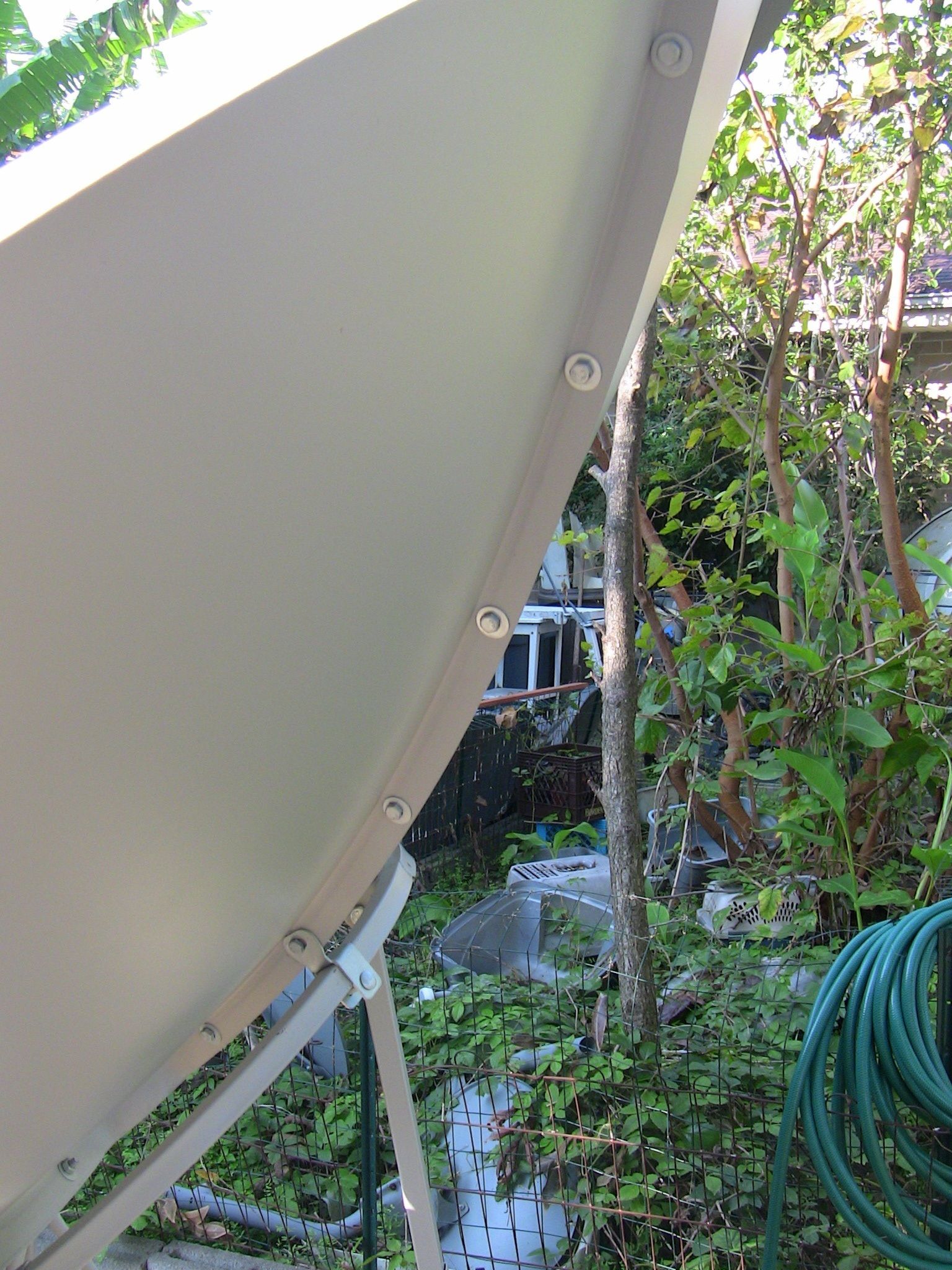

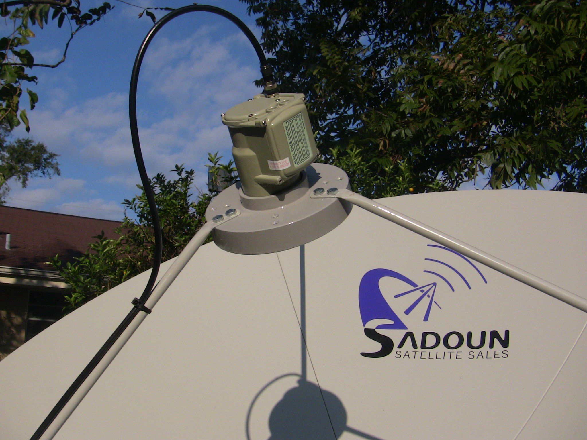

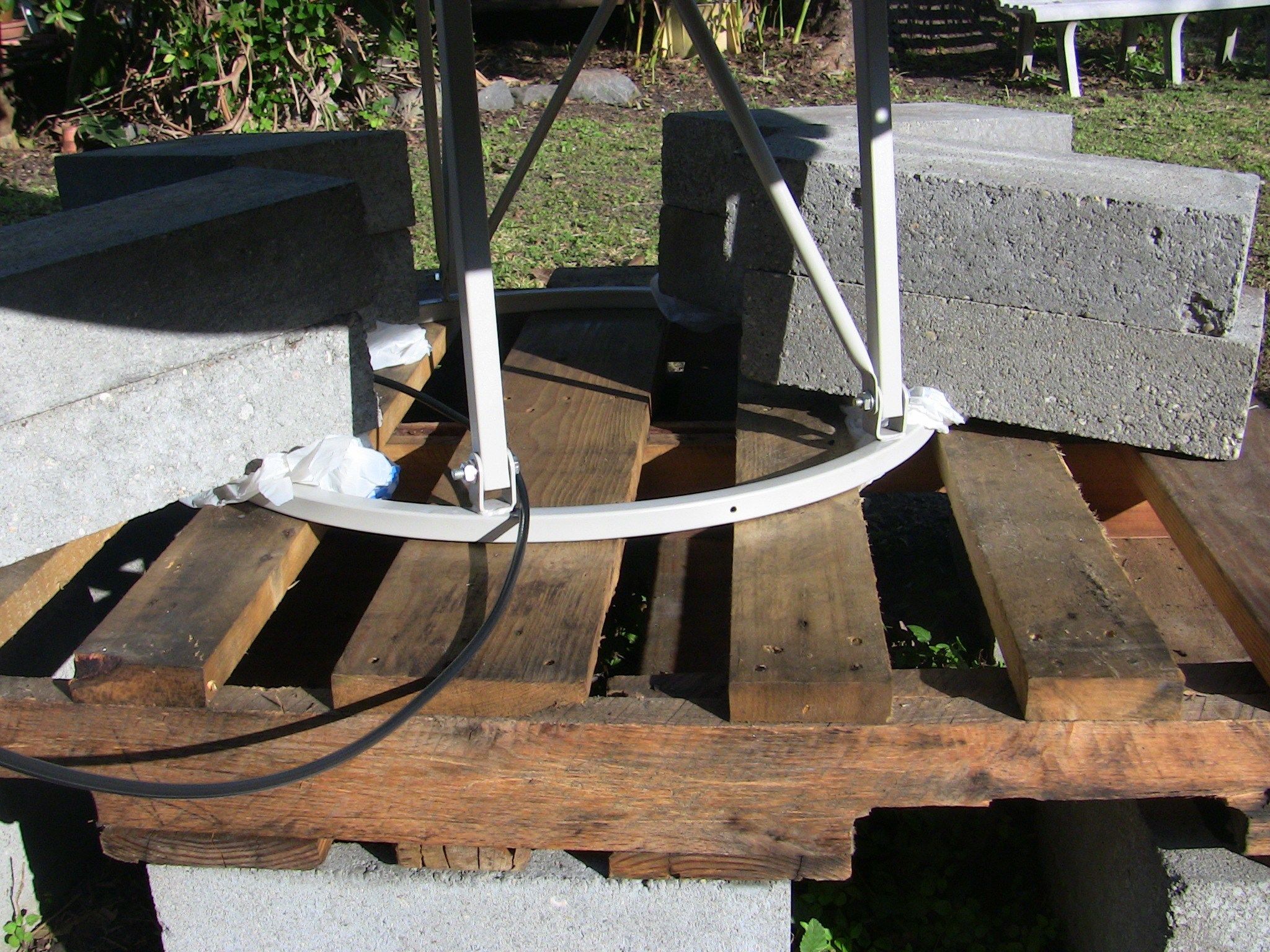

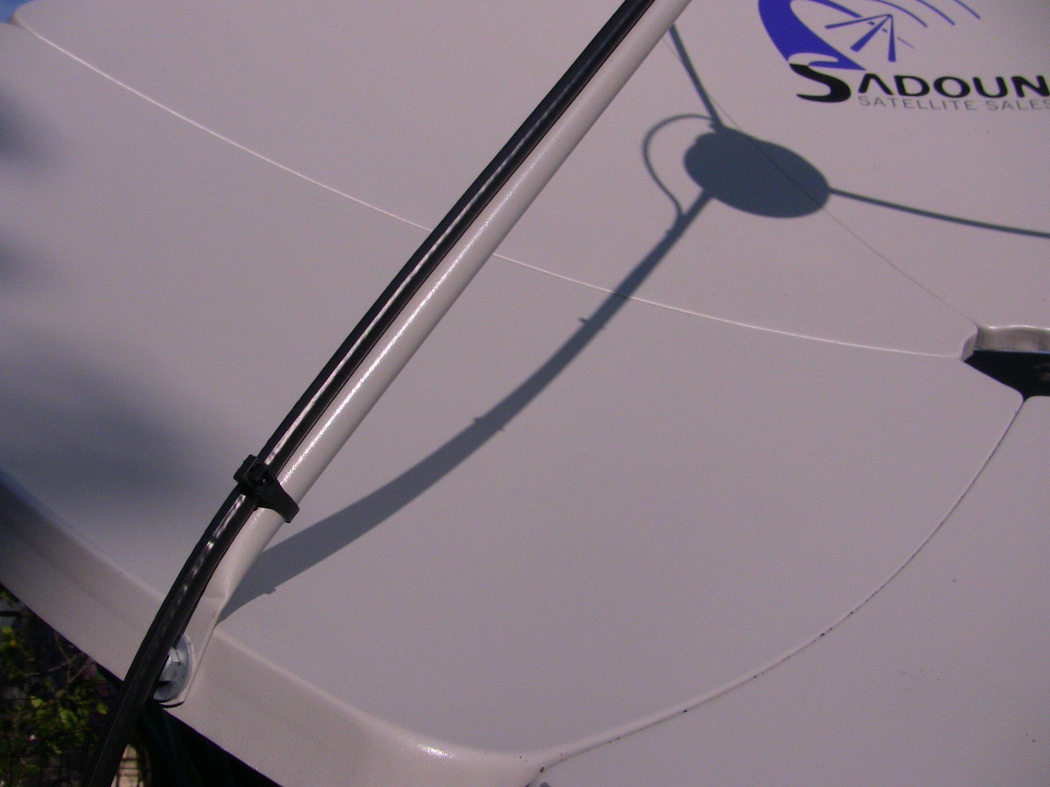

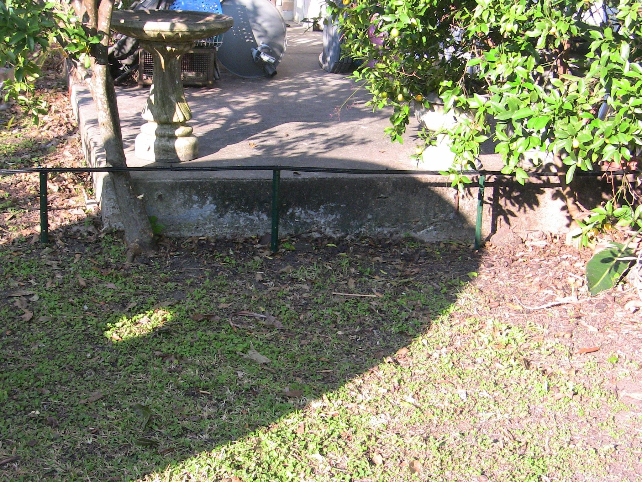

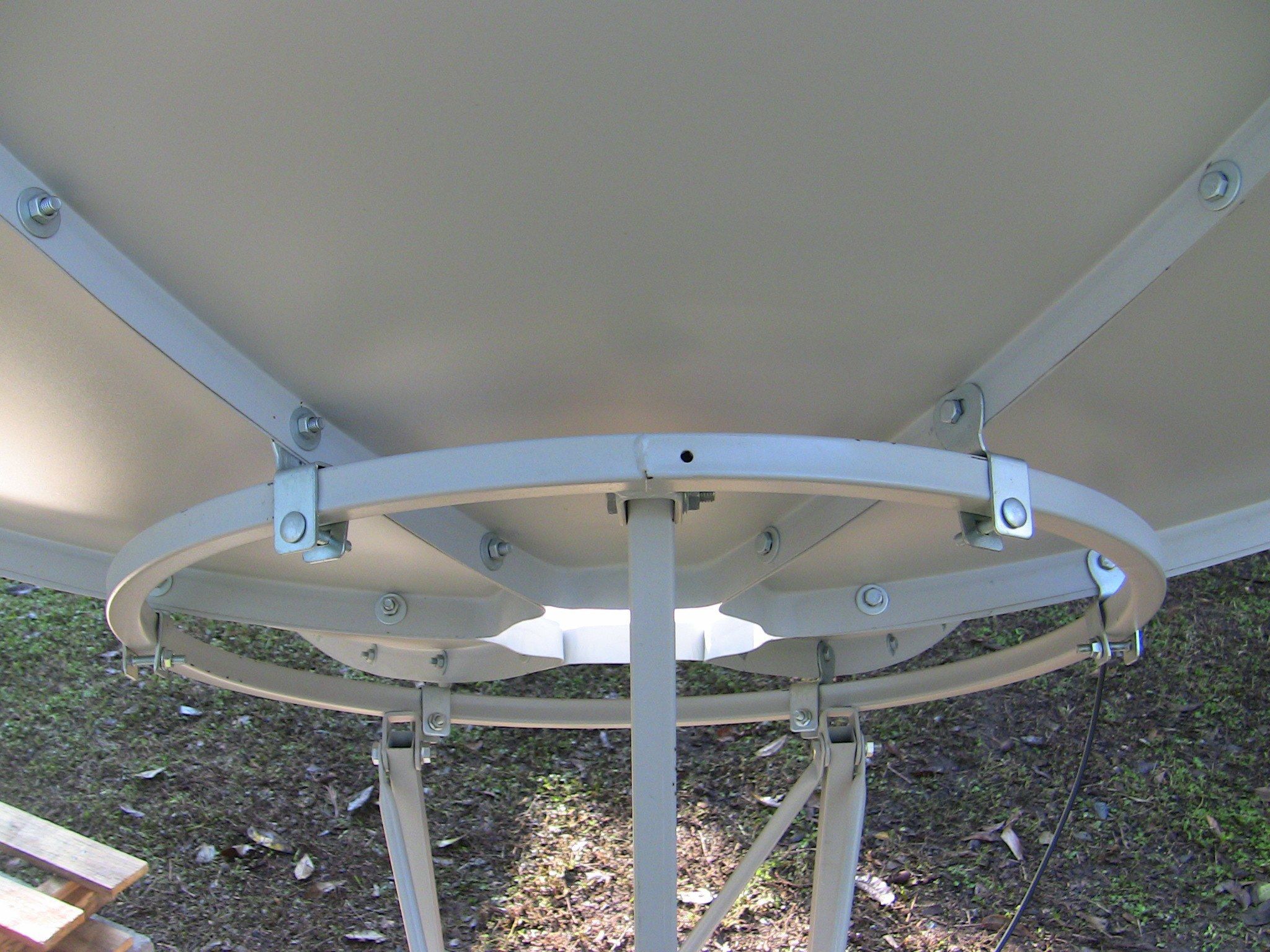

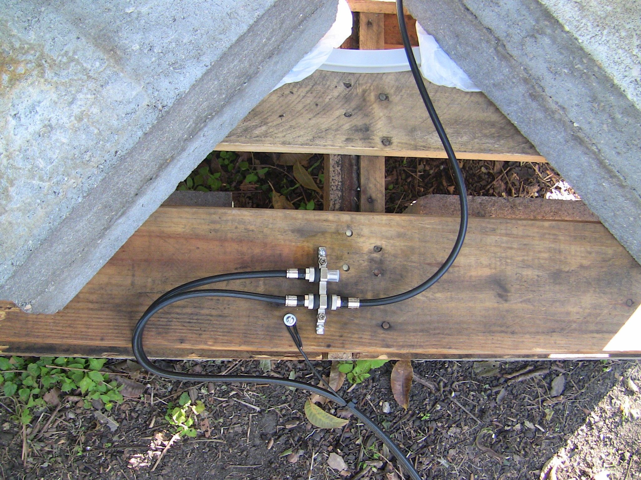

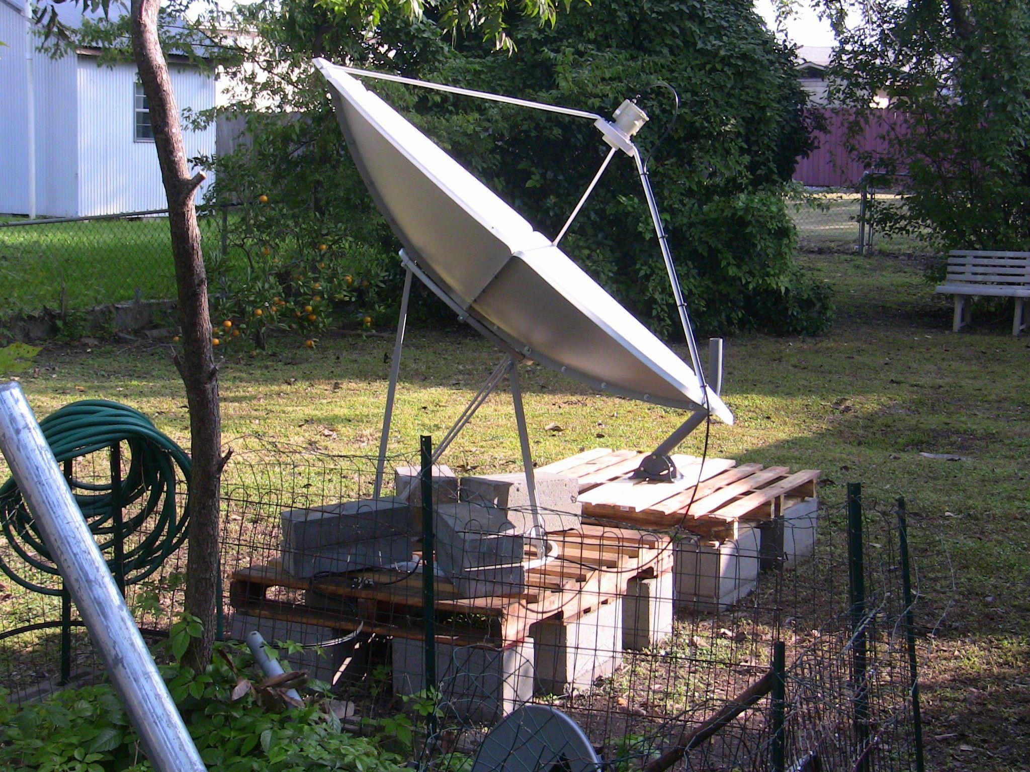

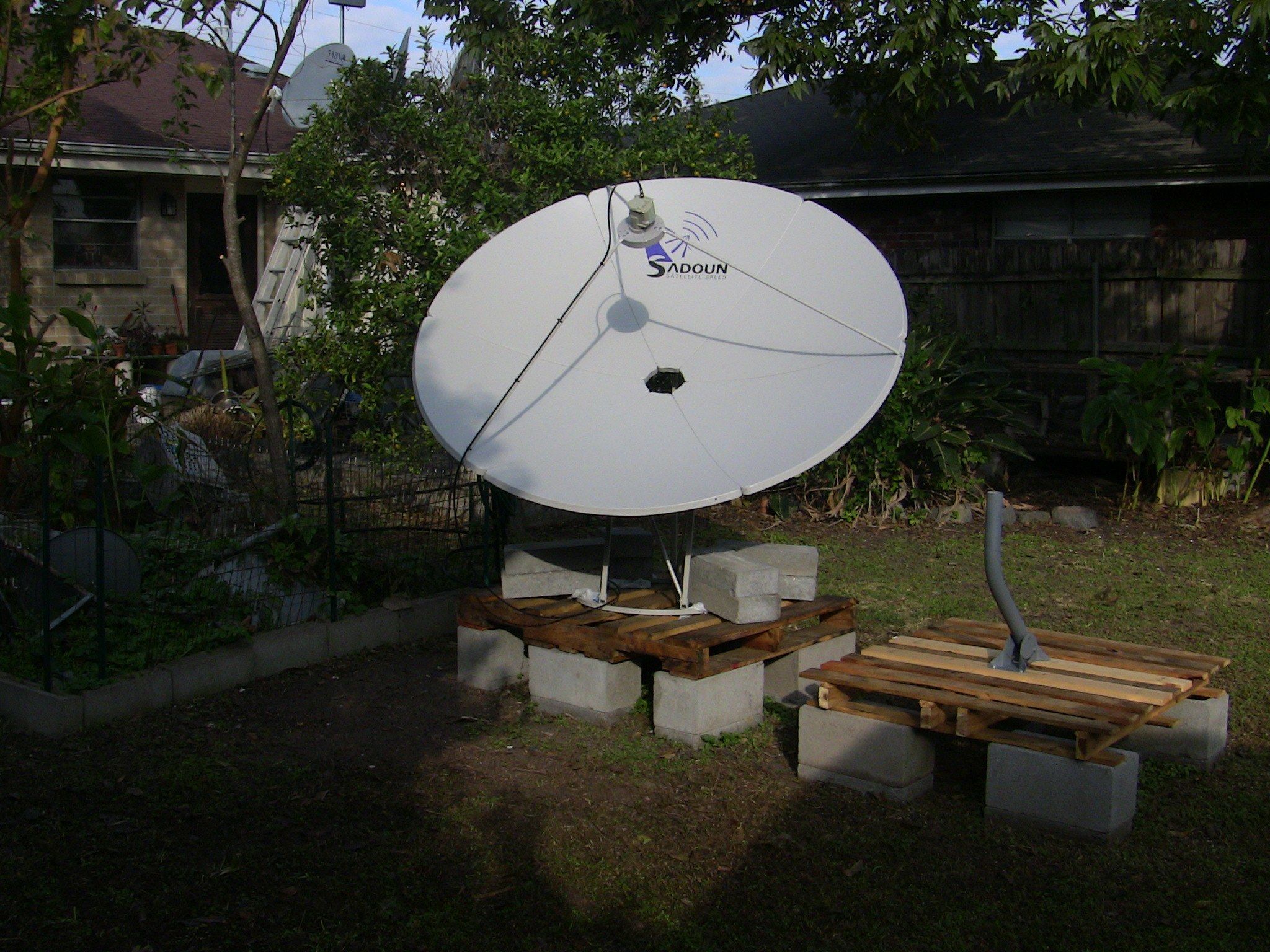

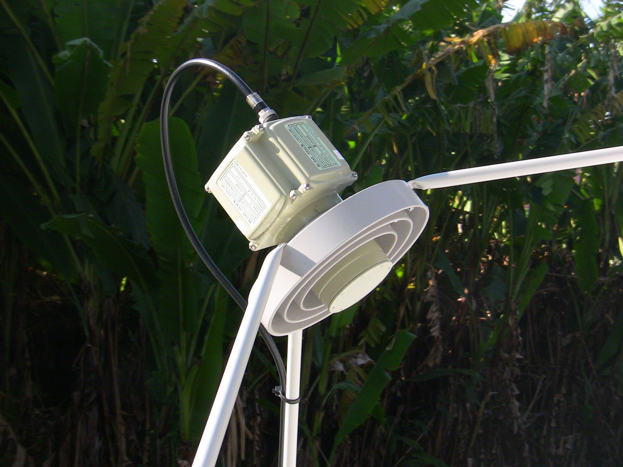

Here are the final set of pictures. I will also post some additional pictures in the "Pictures of your dish farm" thread of the support work (cabling) for the new ground level dish farm where PortaBUD resides. In the first picture, we are introduced to PortaBUD and the beginnings of the new dish farm. The Eagle Aspen B1 SAT STACK is seen in pics #2 and #3. I liked Corrado's idea for adding washers (pic #4). Pic #5 shows the ground mount stand bolted to the dish reflector. I wanted the ability to disconnect PortaBUD from the cable leading to the house and connect a receiver at the dish site without disconnecting from the LNBF itself, so I added a ground block (pic #6). The cable leading from the LNBF is strapped snugly to the LNB support pole (pic #7). I weighed the dish down considerably, since we've been having high winds with our cold fronts (pic #8). Pic #9 shows PortaBUD's shadow, and a glimpse of how I managed to get coax out to the new ground level dish farm without burying the cable. Burying would have been next to impossible, since the ground is filled with tree roots, and also rocks that were used for fill. There are four coax cables in all (two runs of PVCX3B). Finally, pic #10 shows PortaBUD as it now sits, fixed on 72W and providing wonderful SD and HD feeds of STS-129 from NASA-TV.
