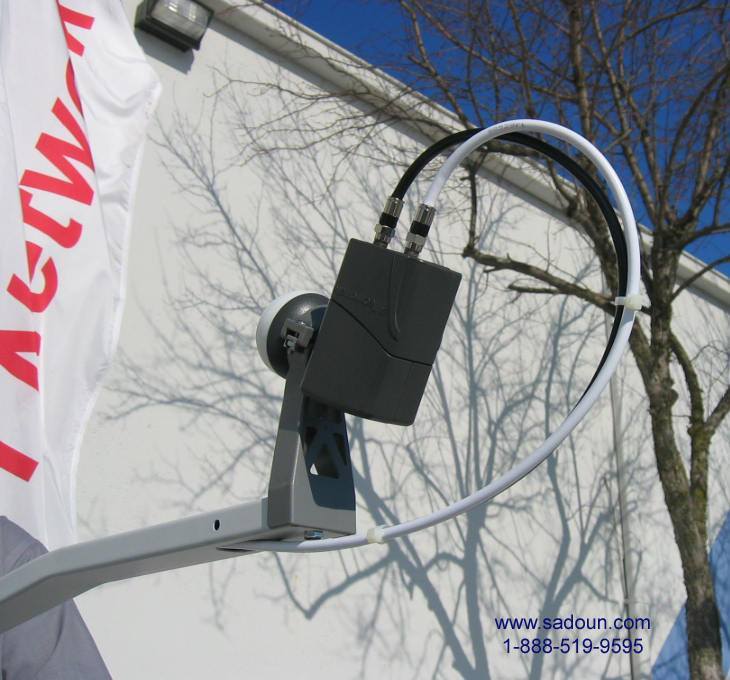

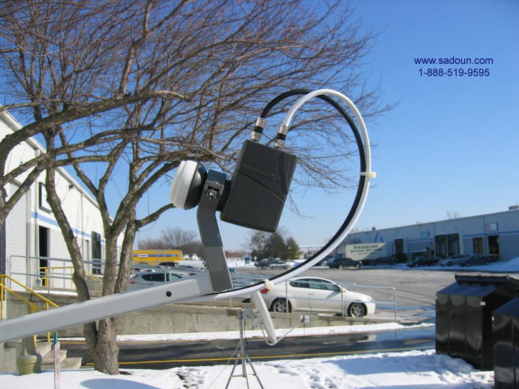

On the new Fortec Star 120cm dish, it comes with a new bulky LNBF arm. It works perfect with a DSS rectangular style LNBF without using the LNBF holder that comes with the dish. For a regular bulky dual KU LNBF with a 40mm feedhorn, you may have to turn the LNBF 180 degrees in the holder as shown in the picture. Make sure you use weatherproofed connectors. Also you may want to use weather-boot around the connector.
