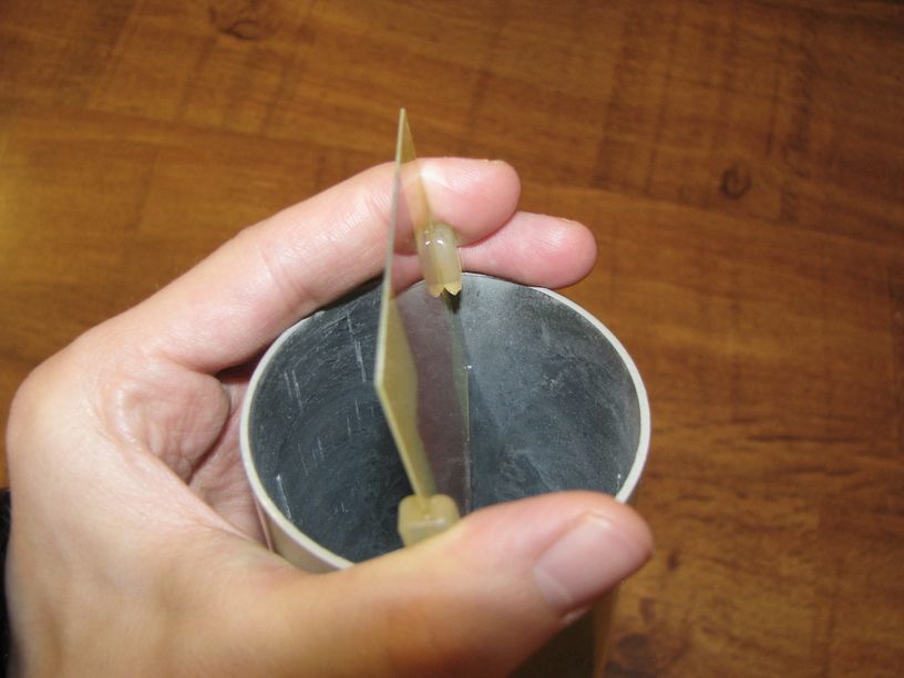

It's very thin plastic (about 1mm). It is sold in Russia but also I can send by express priority mail - dielectric 12$ and 4$shipping, I accept paypal.
I will show You more photos soon. My friends from polish satclub forum have just bought it and test signals so I hope to attach some photos.

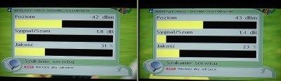

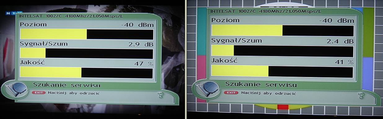

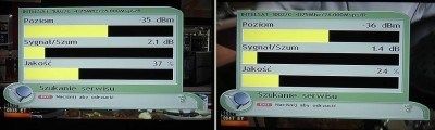

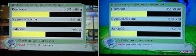

Left side screen - new thin russian dielectric
Right side - common dielectric plate

As You can see at post above, dielectric improves especially low band, 3.4-3.7 but for example 4,08 is also good. :)

Thanks for tests. I'm glad that dielectric improved signal. Remember that thin russian dielectric should be put deeper than traditional dielectric model. Happy New Year :)
