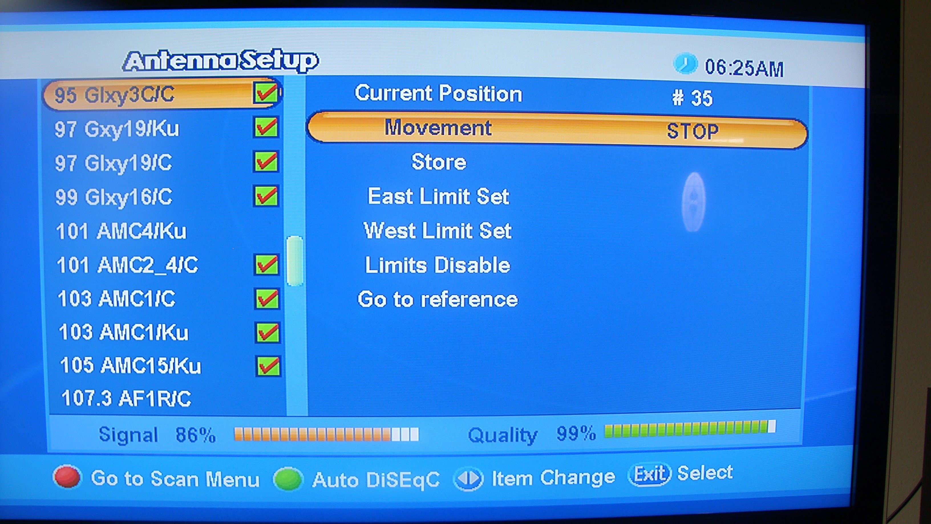

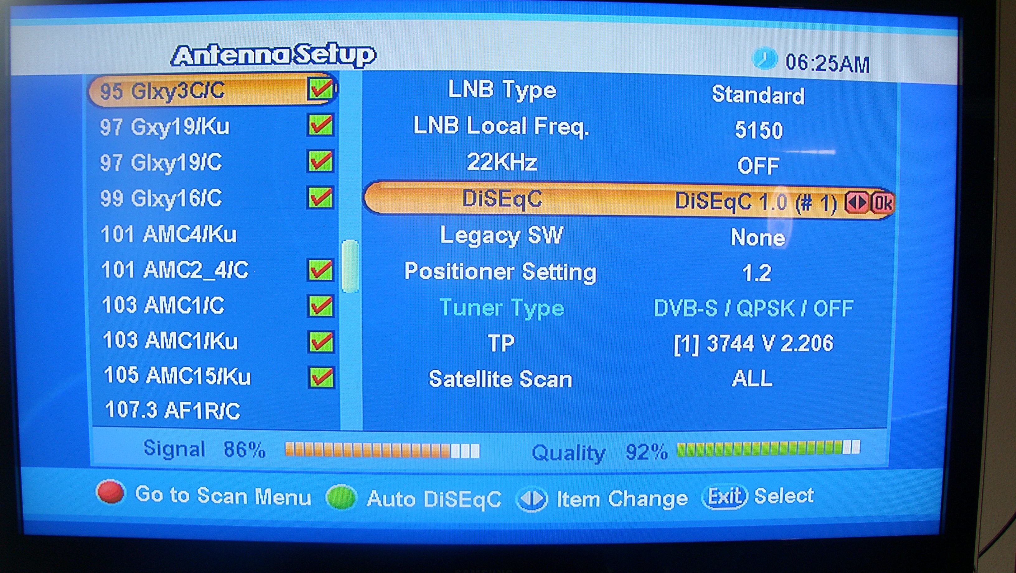

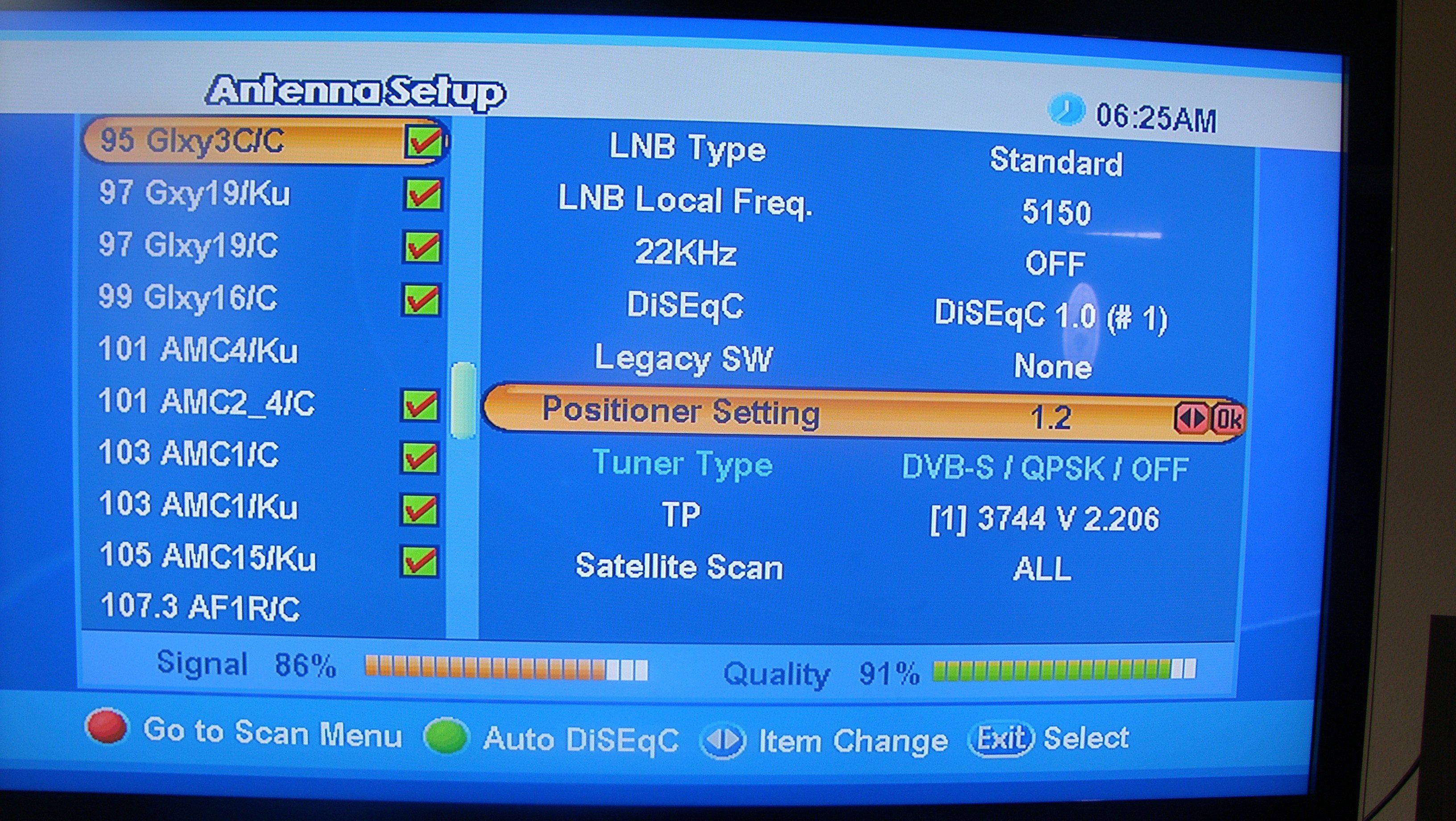

I can work with you in developing the motor/switch combo. Below are some pictures of my setup with another receiver that supports motor/switch combo

SH103691.JPG: Antenna Setup screen showing Diseqc switch or 22Khz Switch Sections.
SH103692.JPG: Position setting highlighted where USALS can be selected or DiseqC 1.2 motor. Selecting DiseqC 1.2 and entering takes you to the next screen in picture below.
SH103693.JPG : DiseqC setting where motor can be driven east or west, stored etc.
