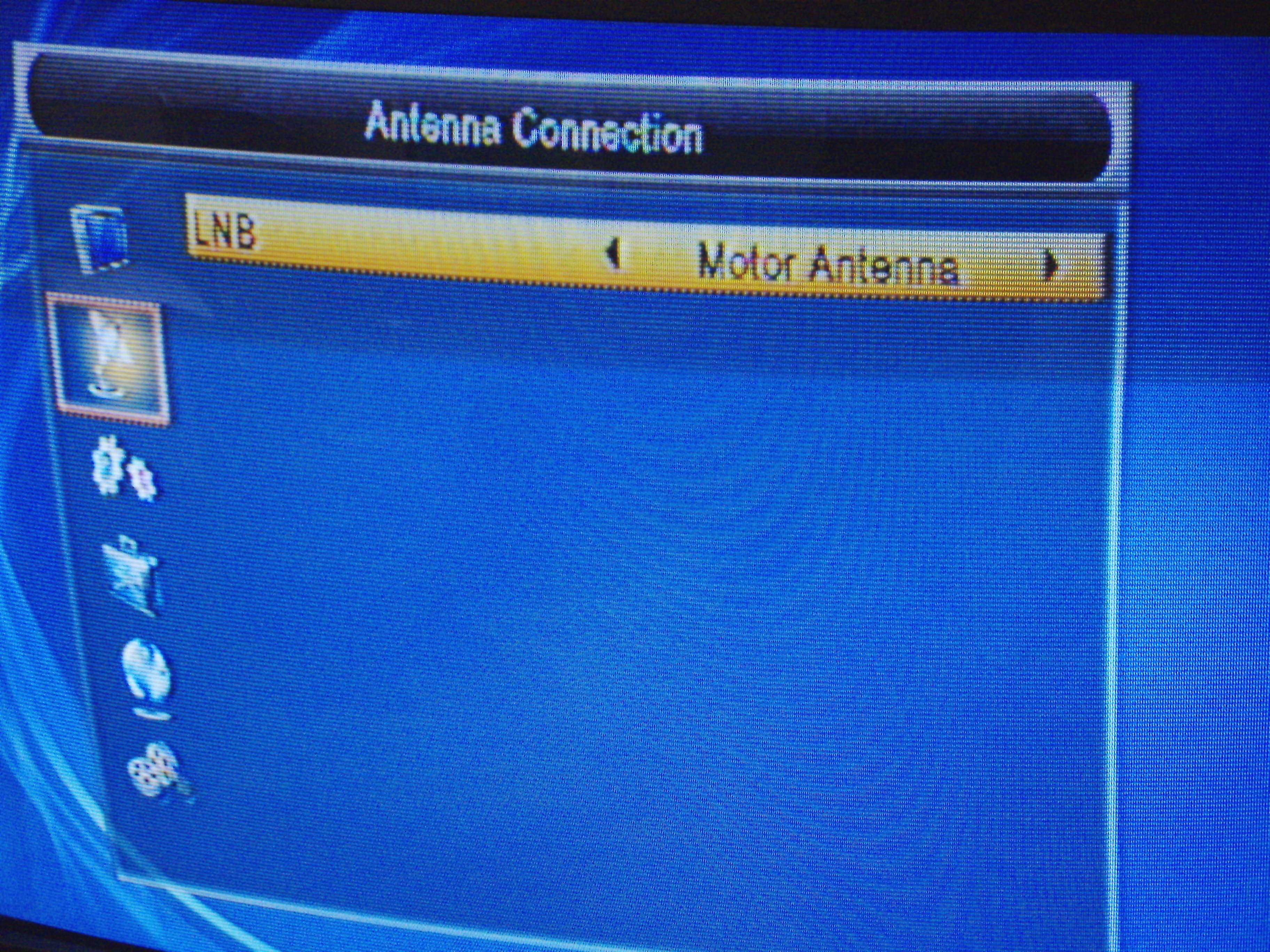

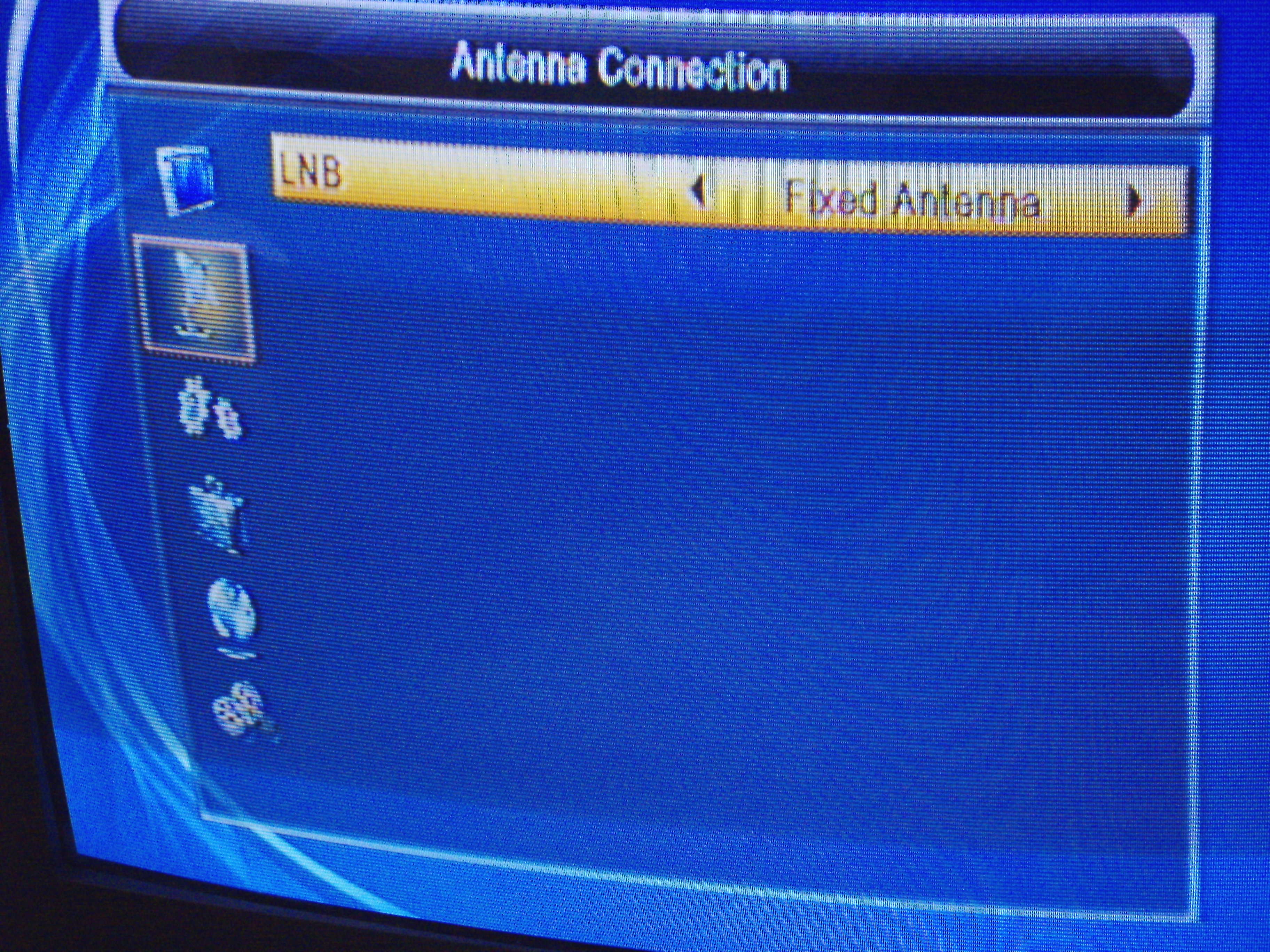

The problem with the Sathawk is one of the menus gives you these 2 options
Fixed Dish
Motorized Dish

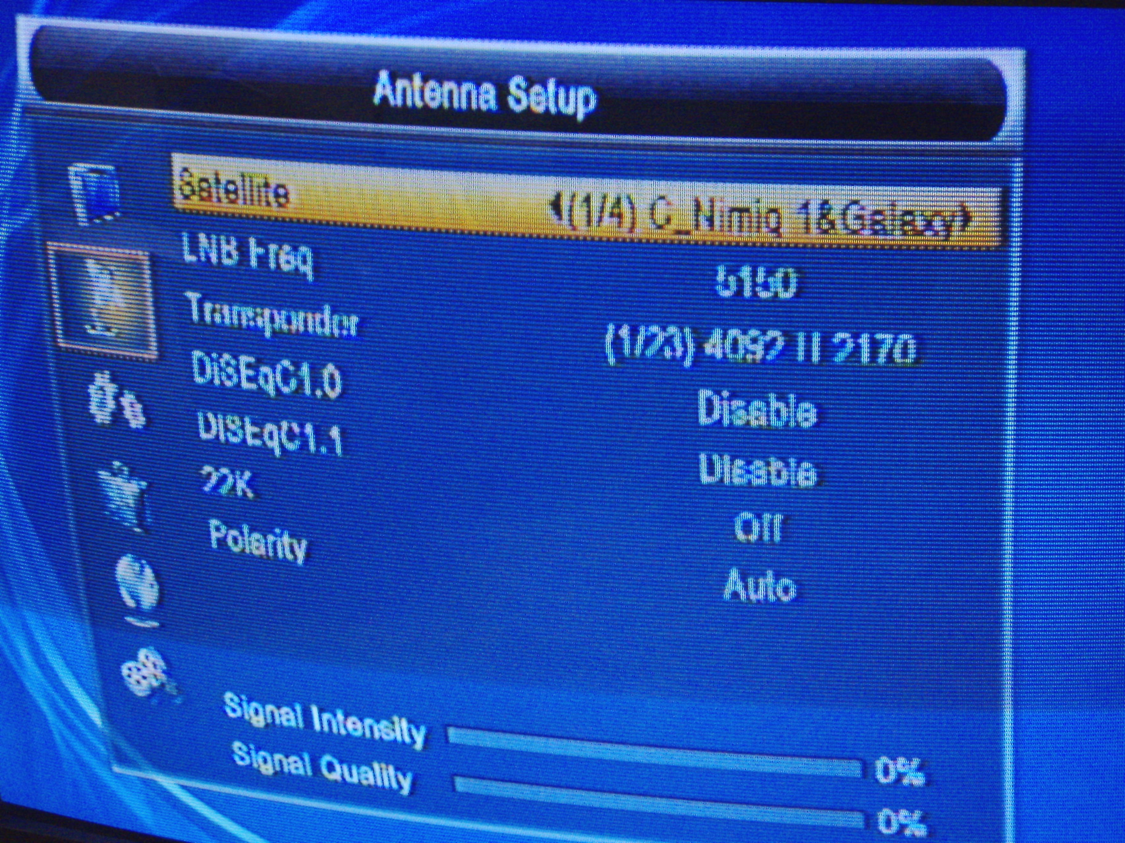

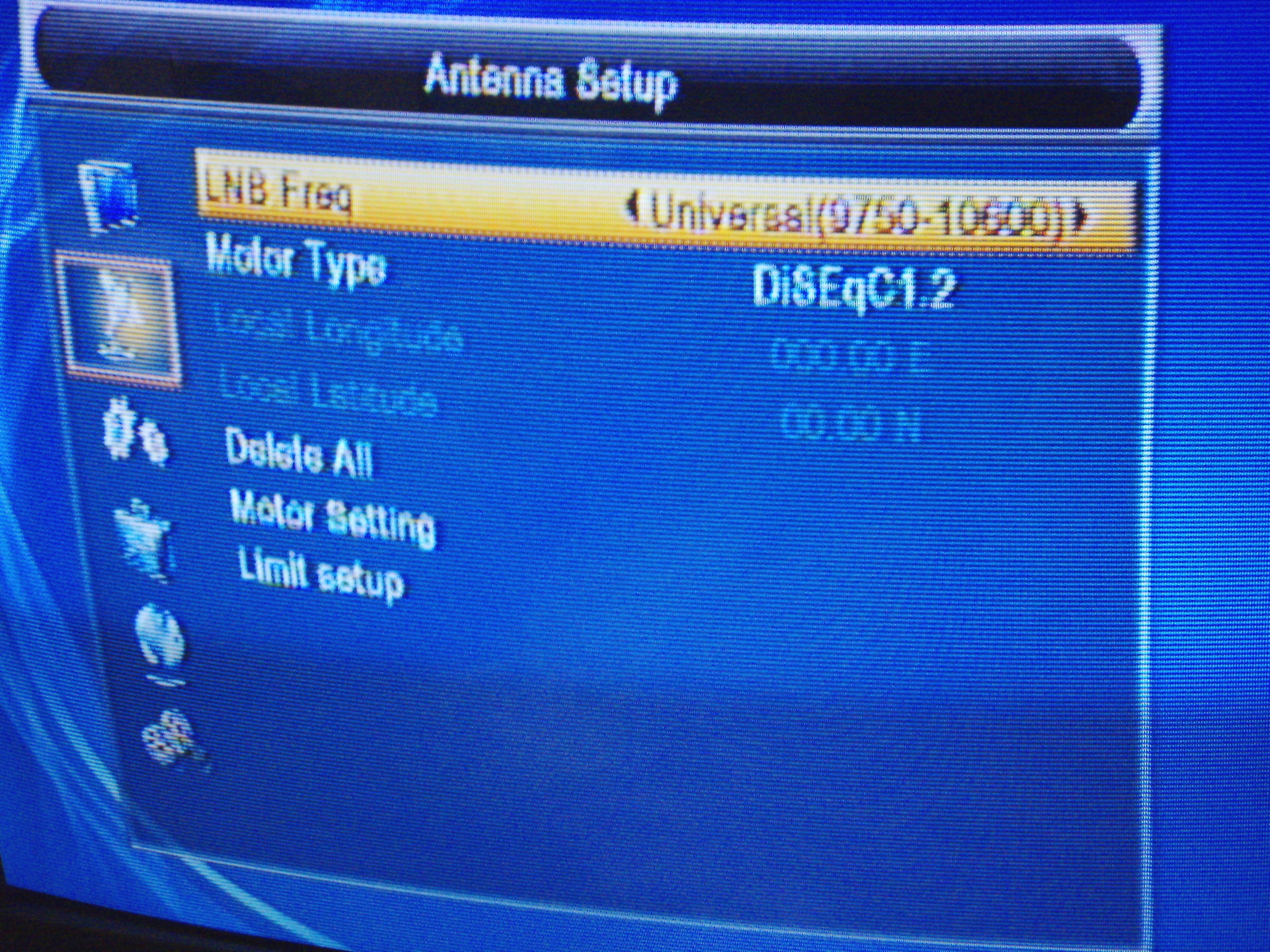

If you select fixed dish then you have the ability to utilize all the menus for setting up a LNB/diseqc/22k etc. When you select motorized and go back into that same screen you only get to select the LNB type for all LNB's and can select the motor functions. The screen with the LNB LO's and switch matrix is gone. So you have no way of changing anything
maybe this will make it clearer
1st screen you see is "antenna connection". When you select that you can either do a fixed setup or a motor
if you do a fixed setup then the antenna setup gives you this option

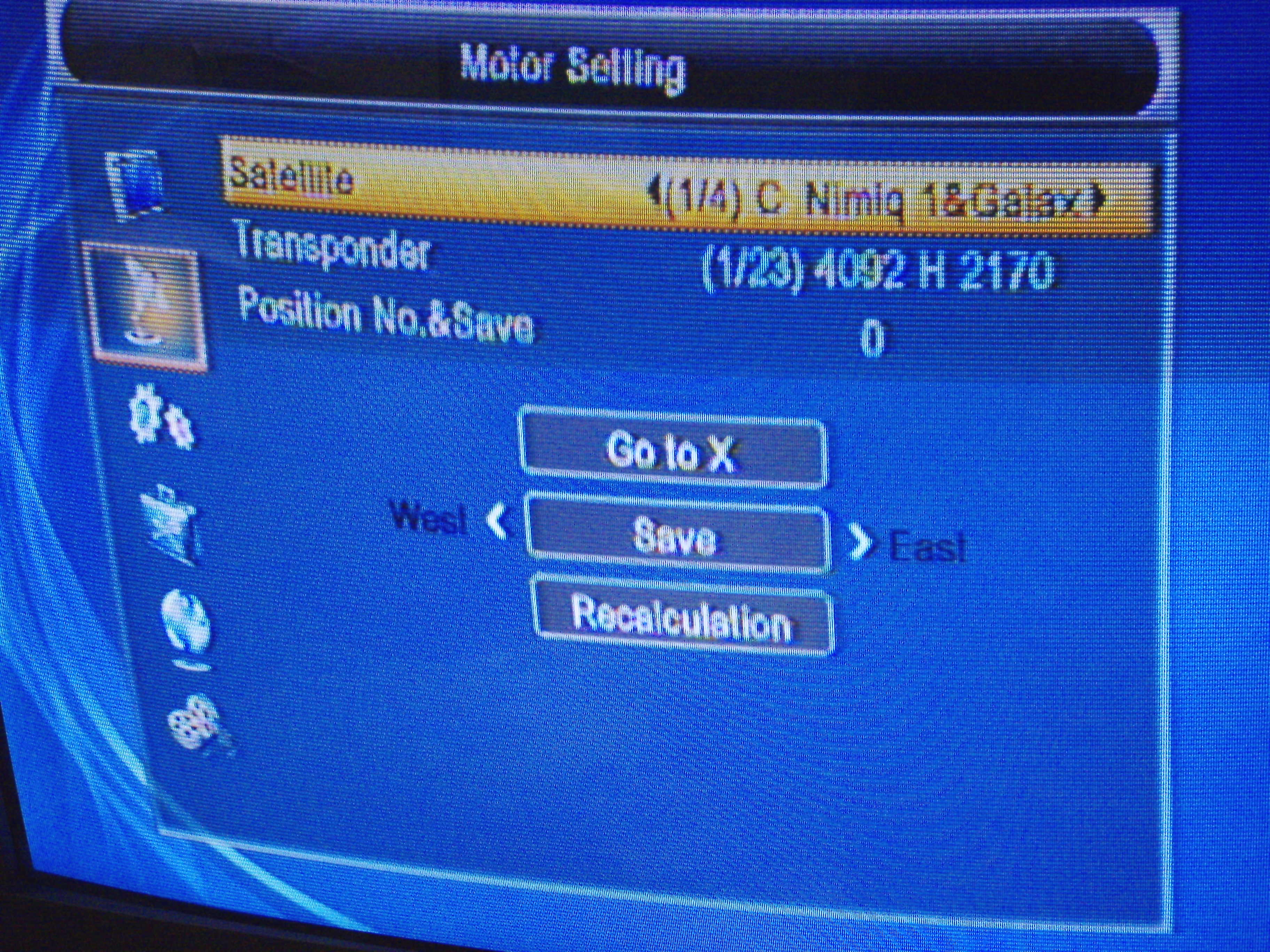

but if you say motor then you are severely limited. You can only select one LNB LO for all the sats you want to setup

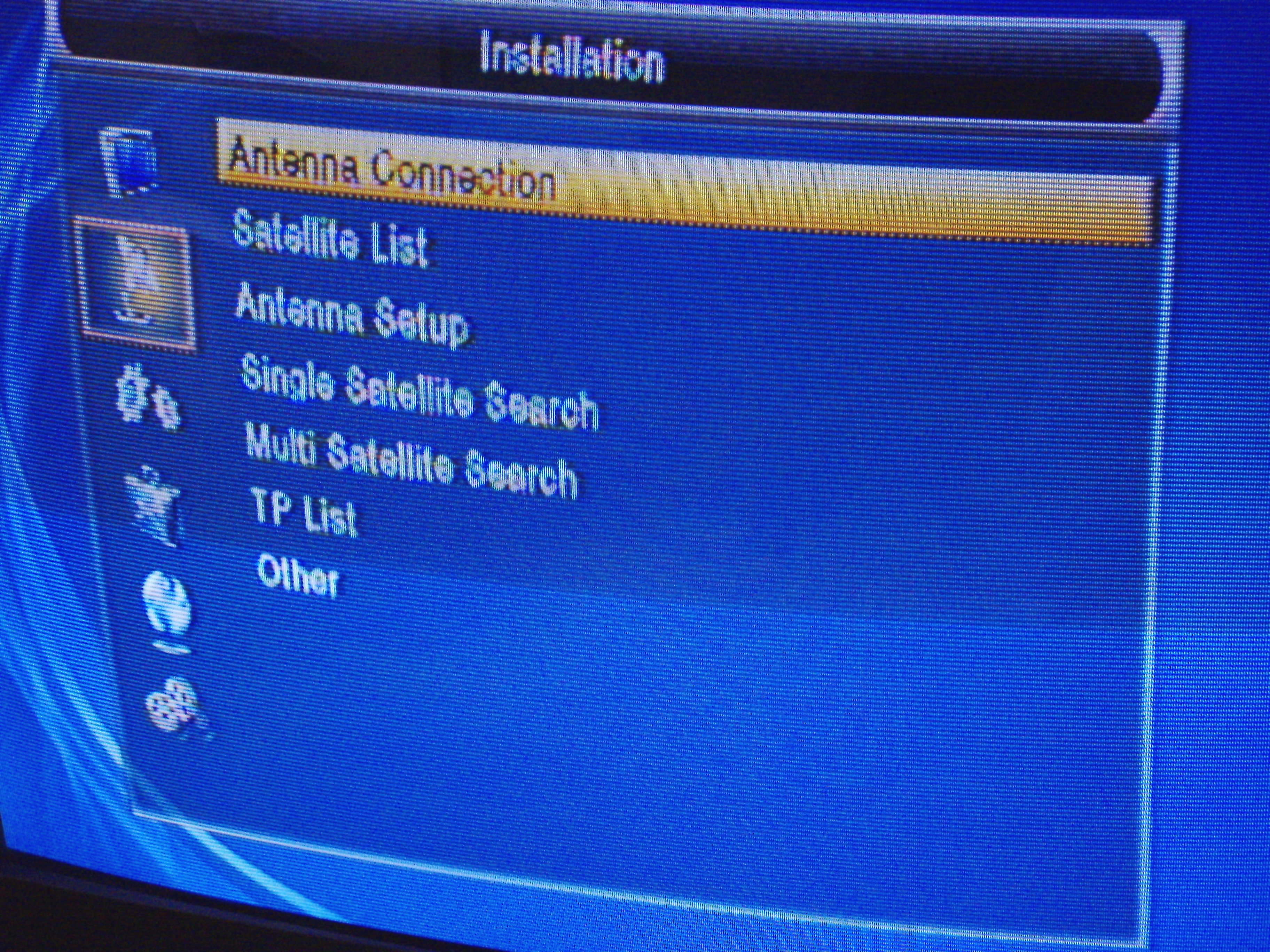

I know its been said in a few posts about the issue but I guess pics drive home any confusion out there
