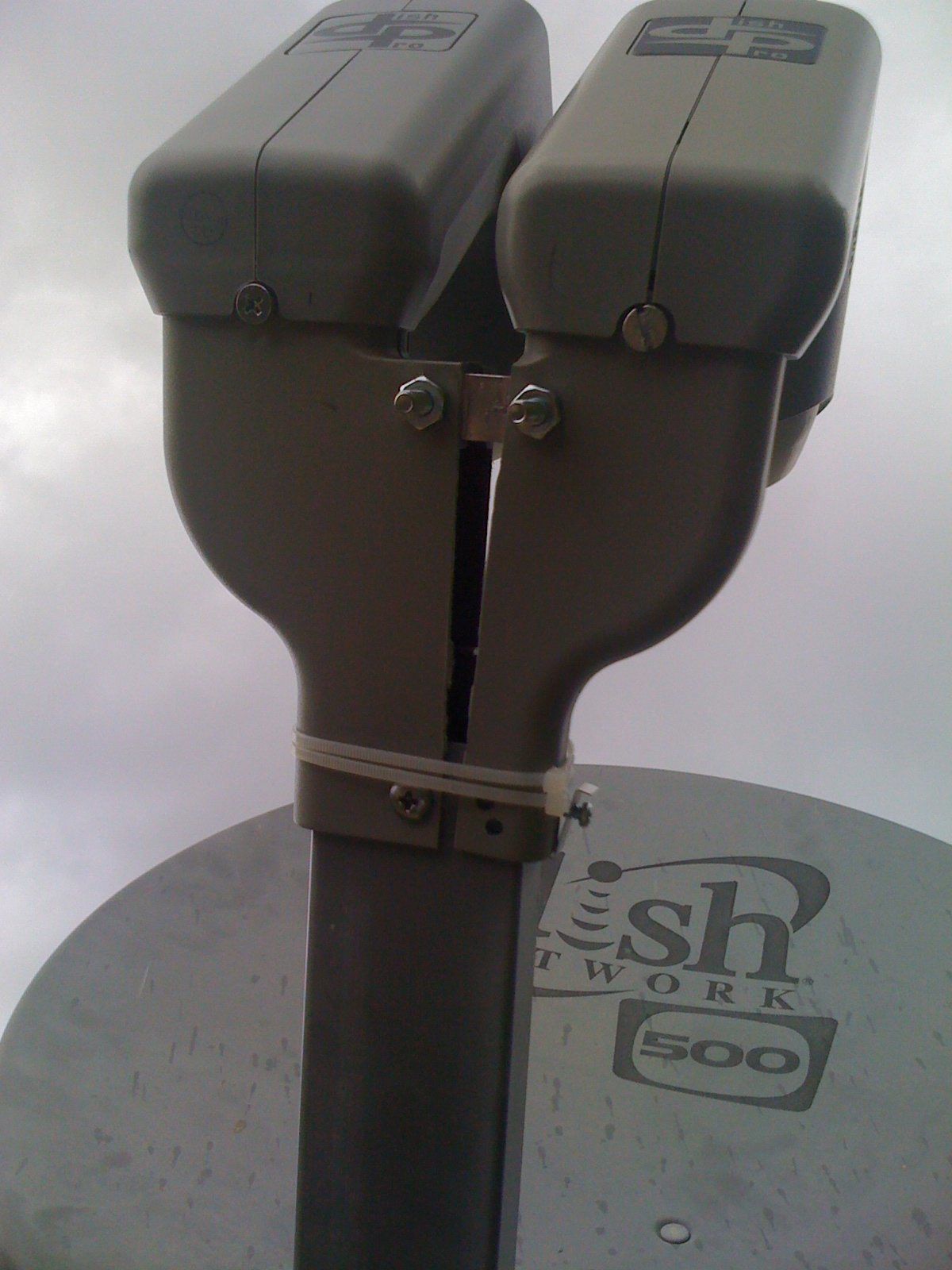

Dish 500 with modified yolk (opened up about 1/4 in. works remarkably well - see attached picture. Tr. 2 on 61.5 (a weak tr.) is about 48 and tr1 on 72 is 58. :D
As a previous poster suggested - use the skew, elevation and azimuth settings from Dishpointer.com (the ones for AMC-4 at 67 west are very close).
Do NOT use settings from the 1000.4 manual or from satcalculator.net - which gave me the wrong skew settings if you use the 2 satellite option. It gave me 72 when the actual skew was closer to 63. Be sure to re-drill the plastic of the yolk an center the two lnbs. The Dish500H (hack) works great. :up

Using the same transponders as Delta_Charlie for comparison, my Dish500Hack with the spilt yolk gives these readings:
61.5 TP 20 signal Q on VIP 221k 56%
61.5 TP 32 signal Q on VIP 221k 55%
72.7 TP 19 signal Q on VIP 221k 62%
72.7 TP 32 signal Q on VIP 221k 64%
