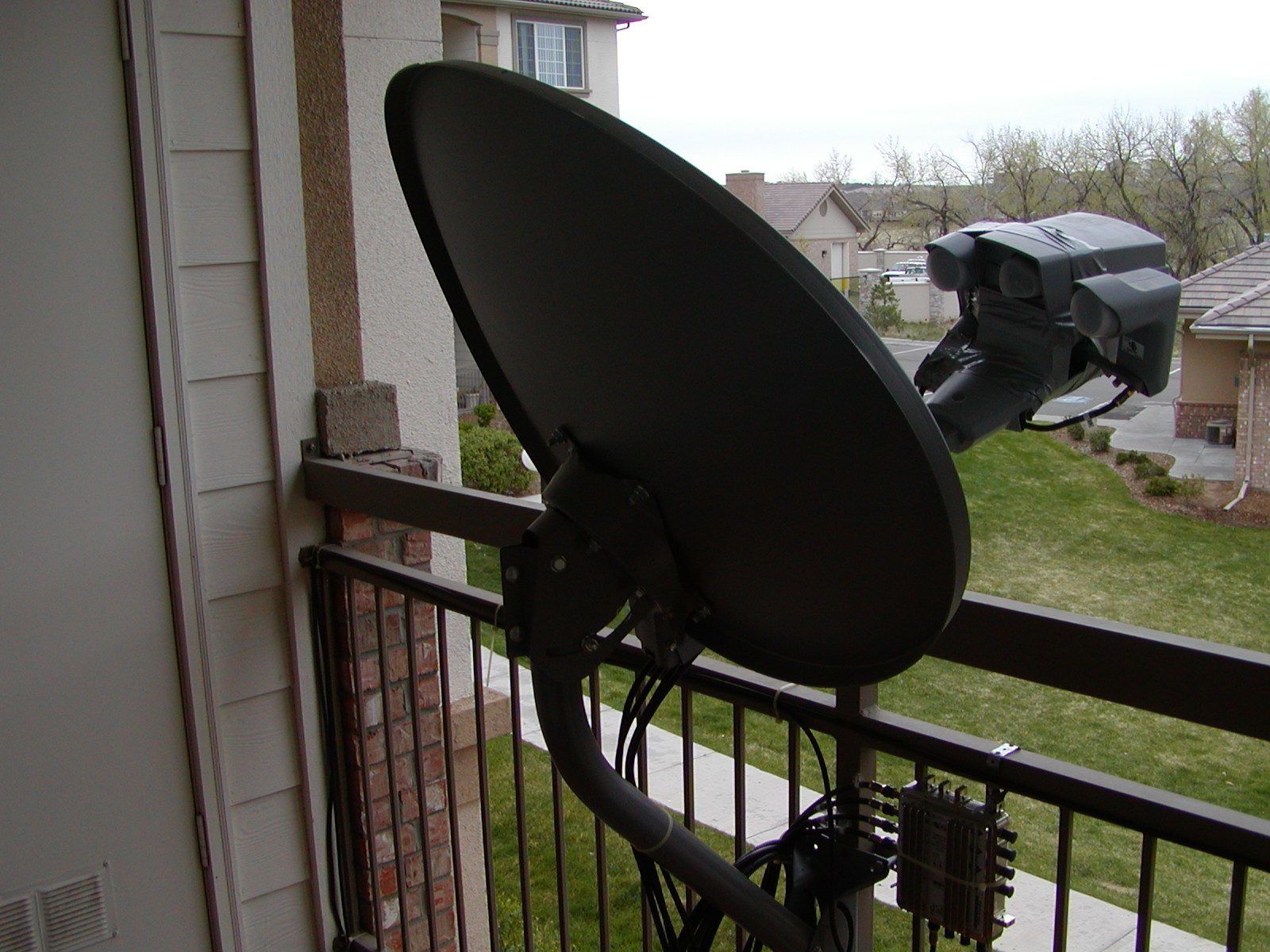

I got back into town yesterday evening and noticed that I lost some channels on 61.5, particularly KBS on TP 18. It was still out a little while ago, so I switched my cables from 61.5 (Dish 500 w/I-Bracket & DP Dual) back to 121 (SD-121) to resume picking up the Korean channels used most often. Since I was doing this, I went ahead and moved my Dish 500 to 129 to see what the signals are today.
I don't believe my SD 121 is perfectly peaked for 110/119/121, but it's close enough.
Sat 129 readings on a 622, at 12:15 PM with clear skies in Denver, CO are:
Using the LNBF duct taped to the side of the SD-121 signals are 66 to 70; and
Using the Dish 500 w/I-Bracket signals are 69-74.
To make sure I have no issues with the management here, my dishes are mounted on the inside of the balcony which seems to give me reduced signals. However, I can still receive a signal on my Dish 500 from 61.5, 110, 119, 129, & 148.
SuperDish 121 w/DP Dual LNBF Duct Taped to Side of Shroud for Sat at 129
ViP 622 Receiver
HD-Silver, with Denver Locals, & Korean Variety Package
Denver, CO; 7/18/06 5:15 - 6:00 PM
Heavy Clouds with Thunder from the South
No Rain yet, but Heavy between Here & Colorado Springs.
HD Programming

From the looks of it, your LNBF that's duct taped is atleast on the correct side of your dish! Looks like your 119 signal strength is compromised for the 121 signal strength. I am going to dial mine in for 110/119 and move the 129 LNB around until I can dial that guy in. I don't have a need for 121 since I am not versed in any other languages. :-(
I'll take pics once I am done (if it works). I hope I can get my 129 in the 80s for signal strength. That's the goal! If the signals are no better than the high 60s/low 70s that I get now on the dish 1k, then this will be pointless.
Thanks again for the info and pics! :)
I'm hoping to replace the shroud on my SD 121 with a repoint kit to convert it to a Dish 1000+ with extra large dish. If not, then I will get some rectangle pipe from an old dish laying around, and make a mount for the extra LNBF for 129. Otherwise the duct tape will work for a few more weeks. Yesterday I noticed it was starting to sag, so I added some more about the time the weather was going bad and brought up the bad weather signals.
