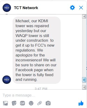

I just sent them another PM via Facebook asking if their power has been increased as of yet since I heard the new fixed repack antenna was installed yesterday, and explaining that I can still basically no longer receive them since repack. They aren't usually very responsive, so let's see if I can get an answer. If so, I'll share it here.
Here you go Trip, I got a timely answer this time!

They have NOT turned the power up as of yet (Saturday 8/3 evening), so likely are still using the interim 16kw antenna at the lower tower level.
Great! They probably need to do other things like install transmission line and whatnot before they can go live with it. But that's great news.

They haven't announced it so far as I can see, but they are finally running at FULL power as of this morning, 8/9/2019.
