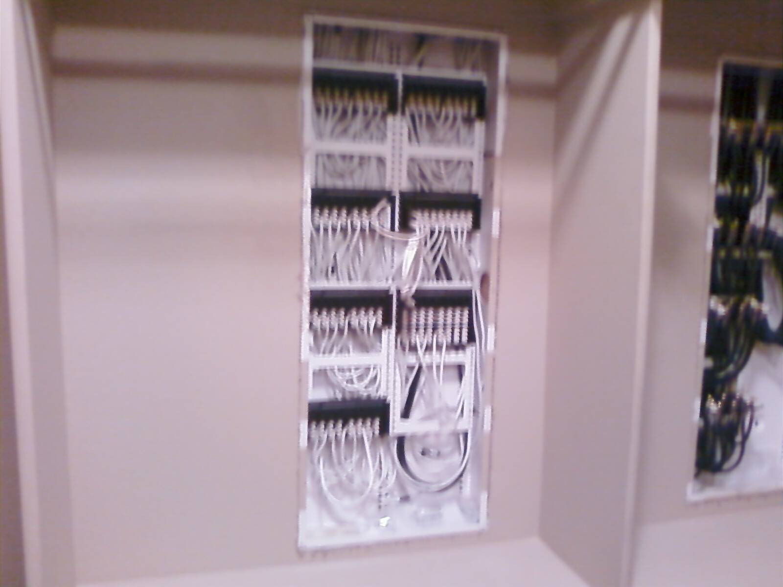

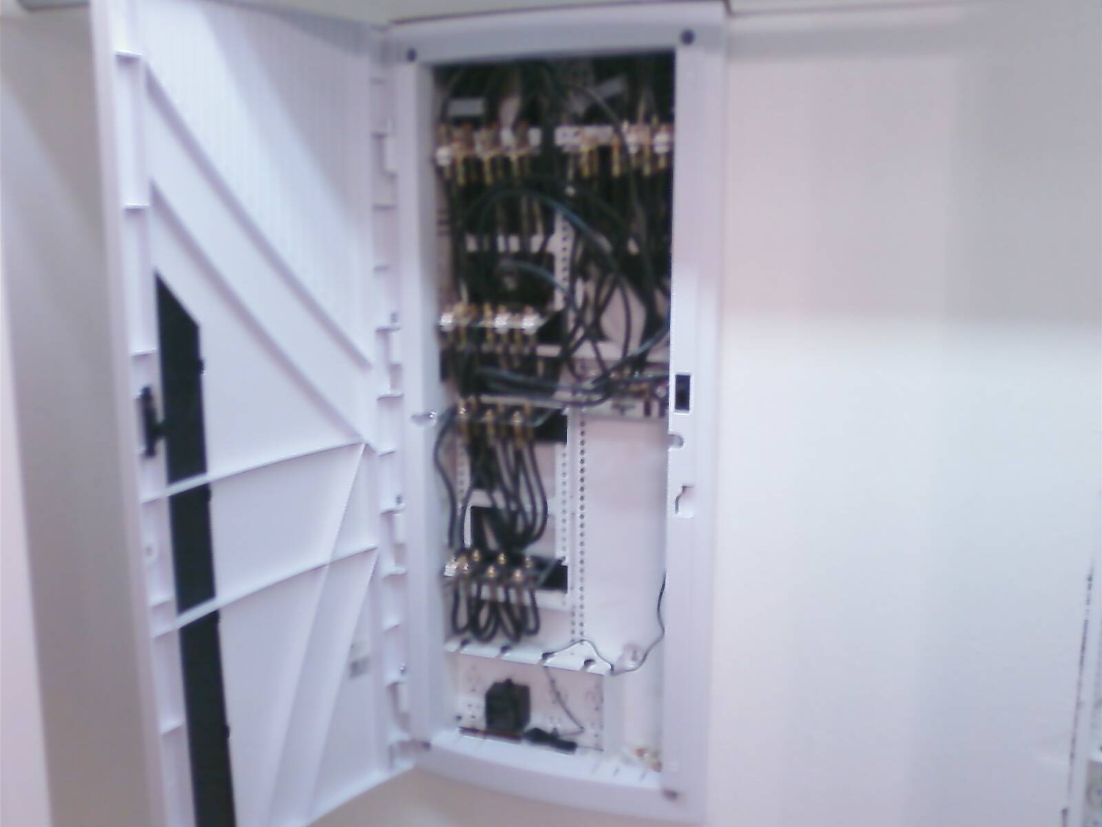

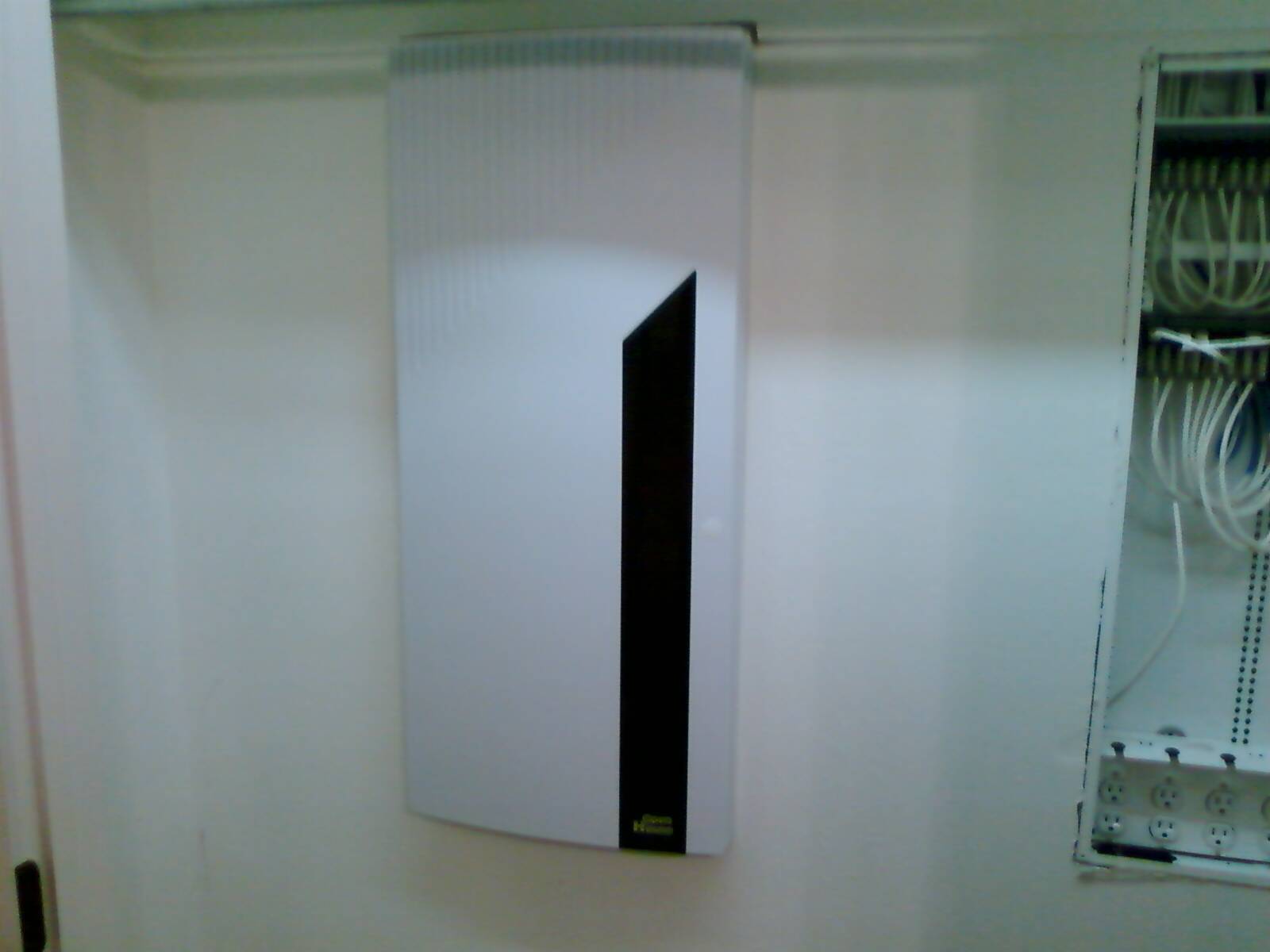

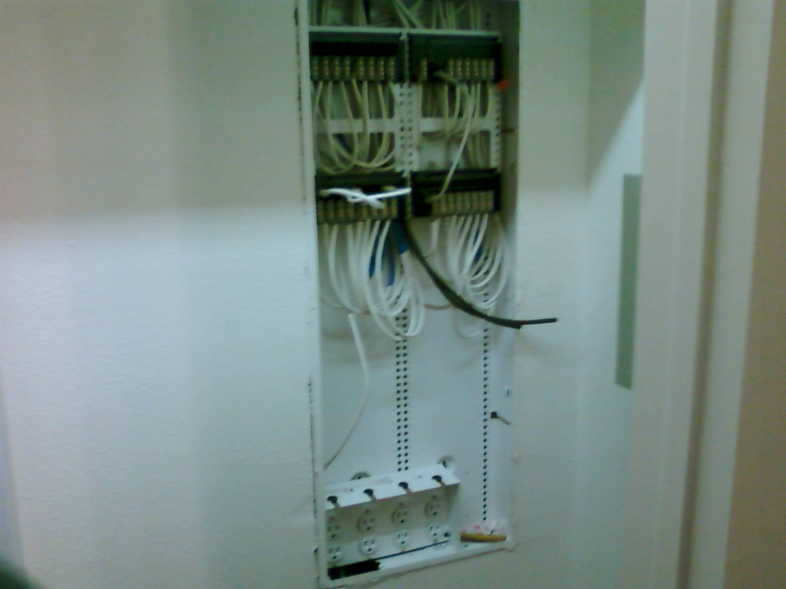

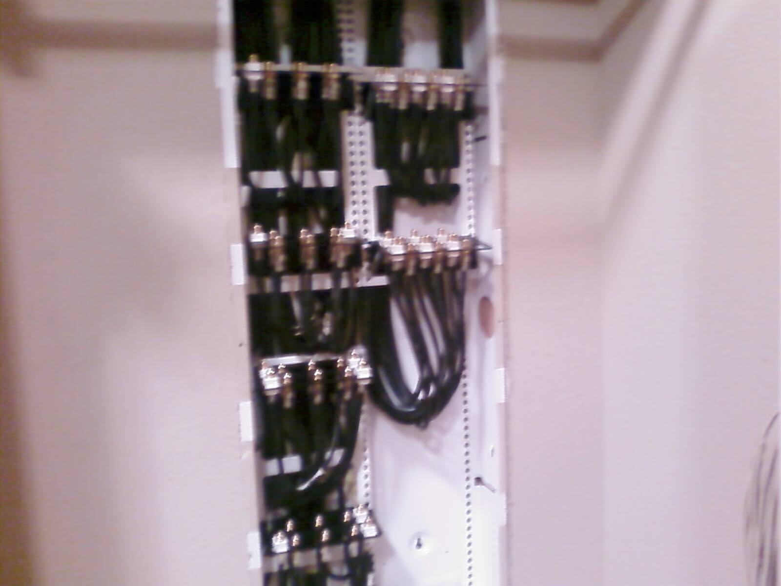

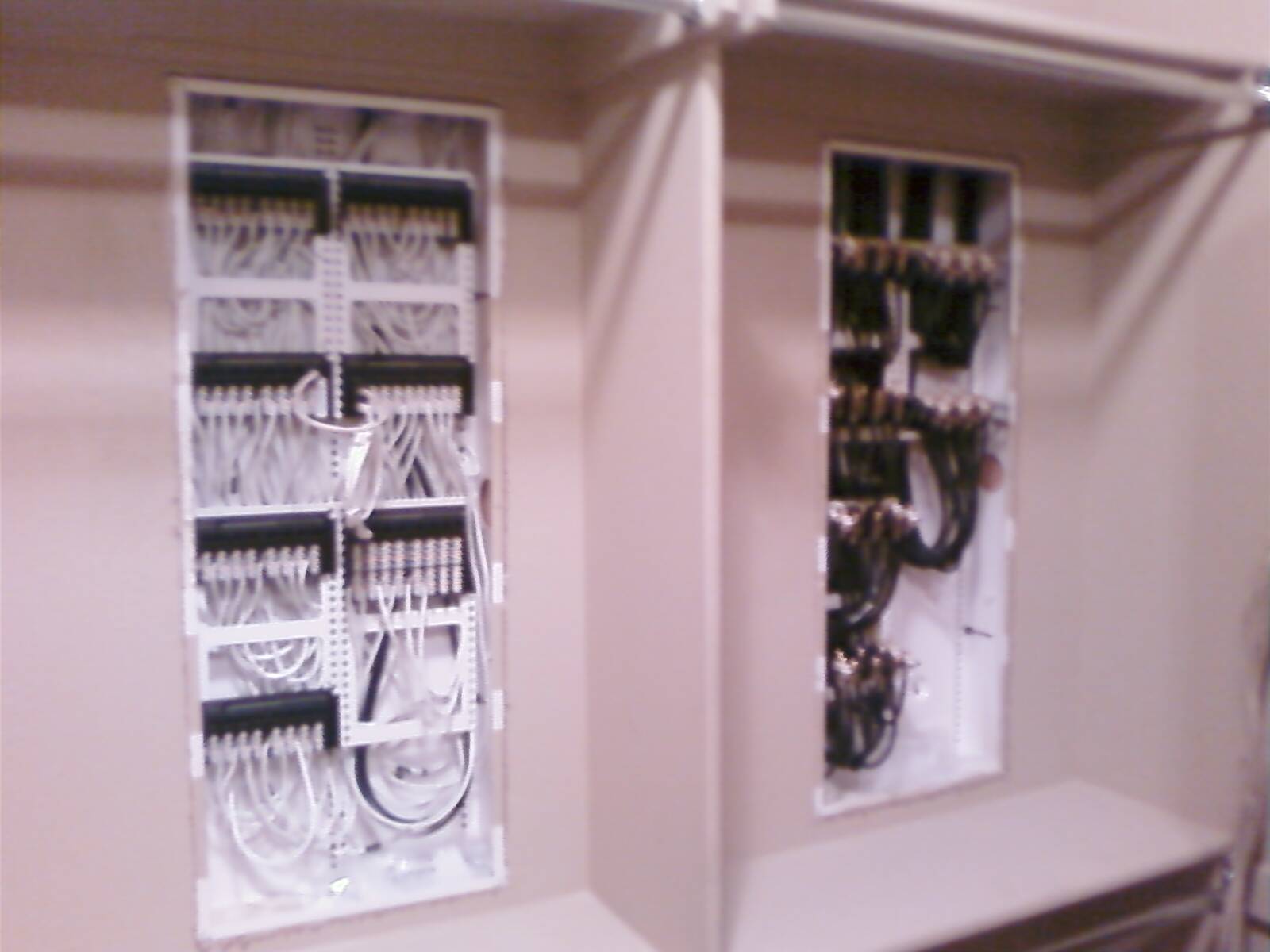

Here are the wiring cabinets from my dads house and my house from a few years ago when I was finishing the connections.

Pictures are too fuzzy ... what cabinet did you use?
Sorry I think I took those years ago with my original iphone. My dad's house and mine were built within a few months of each other. It is all Open House products from Parts Express.
http://www.parts-express.com/pe/showdetl.cfm?partnumber=182-704
http://www.parts-express.com/pe/showdetl.cfm?partnumber=182-710
I don't see the hinged door at Parts Express but this is what I used
http://www.homecontrols.com/OpenHouse-Hinged-Door-Depth-Extension-Kit-LNHDx?sc=23&category=194220
