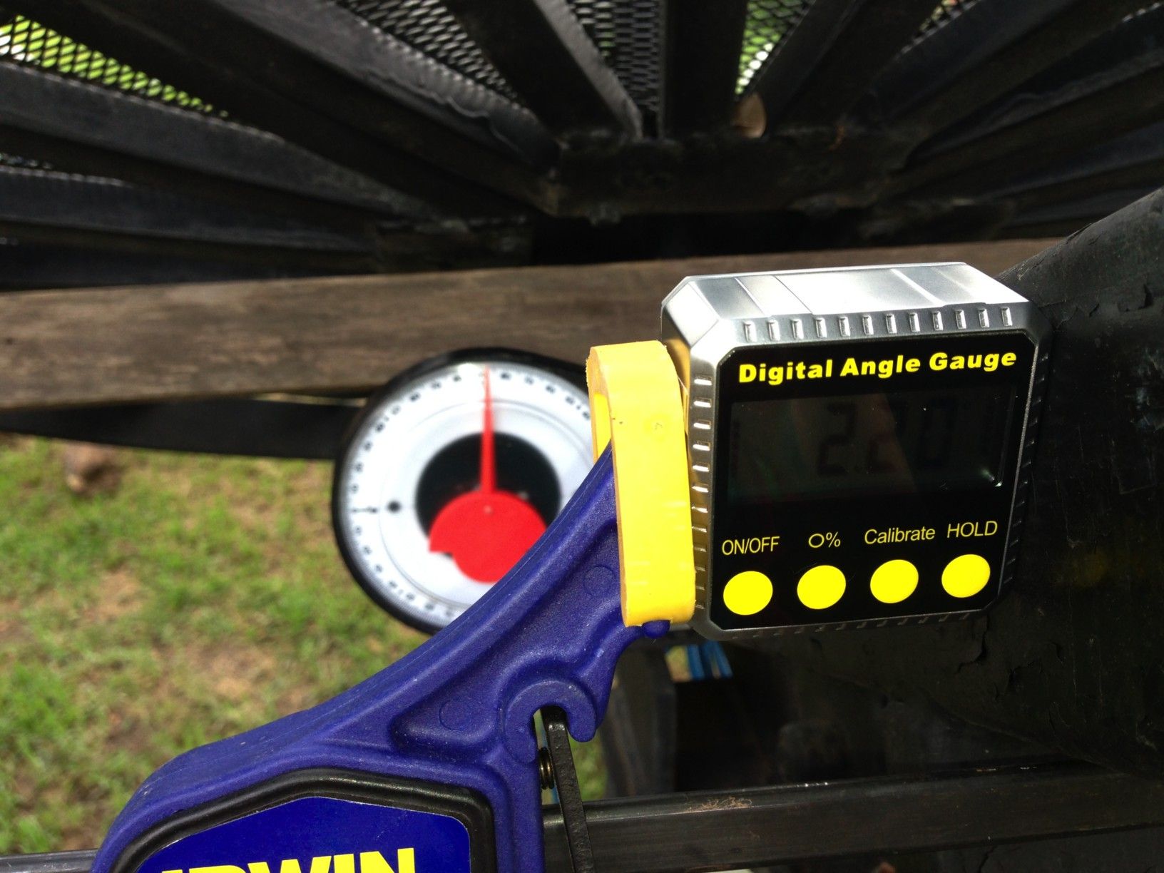

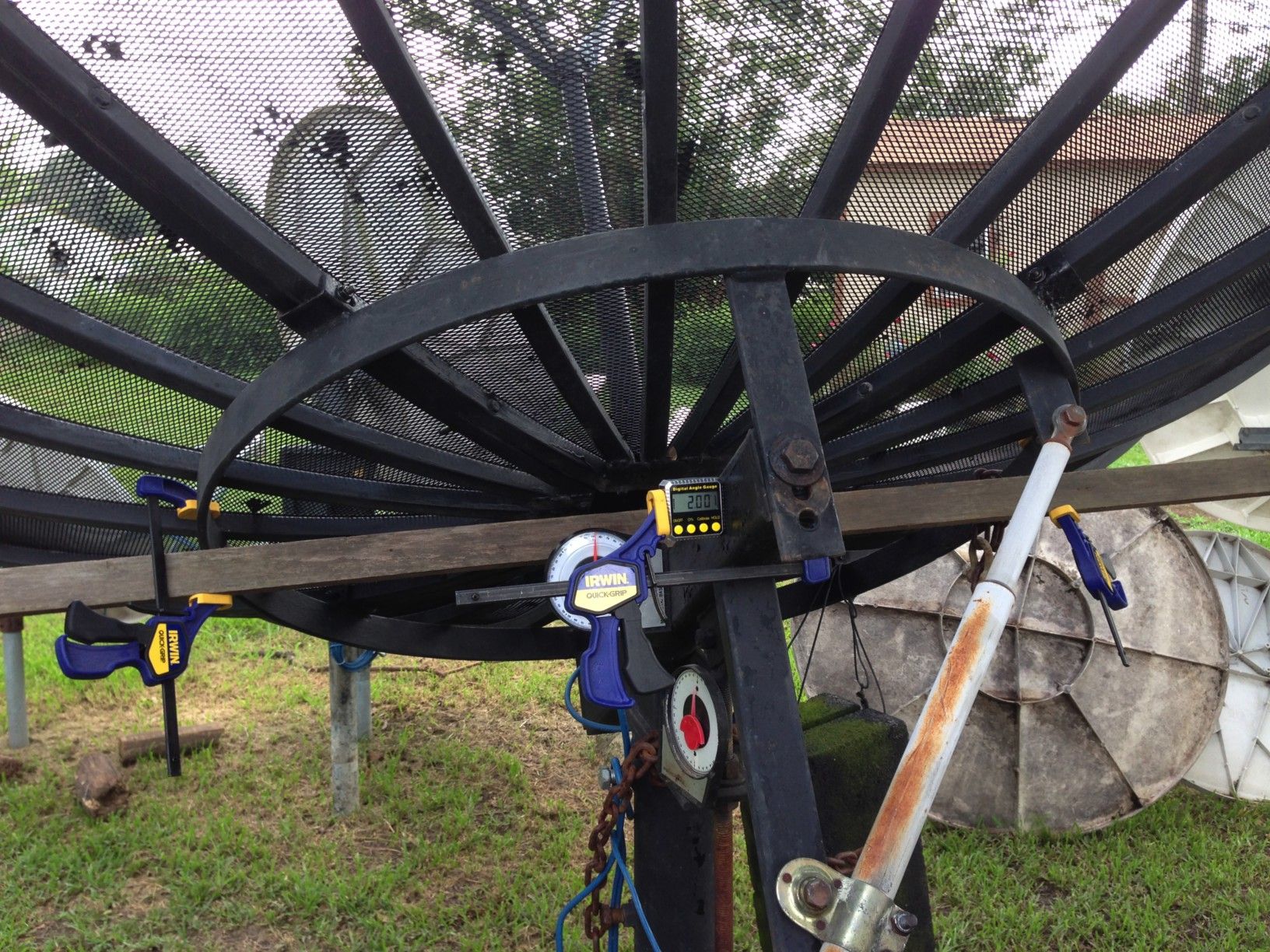

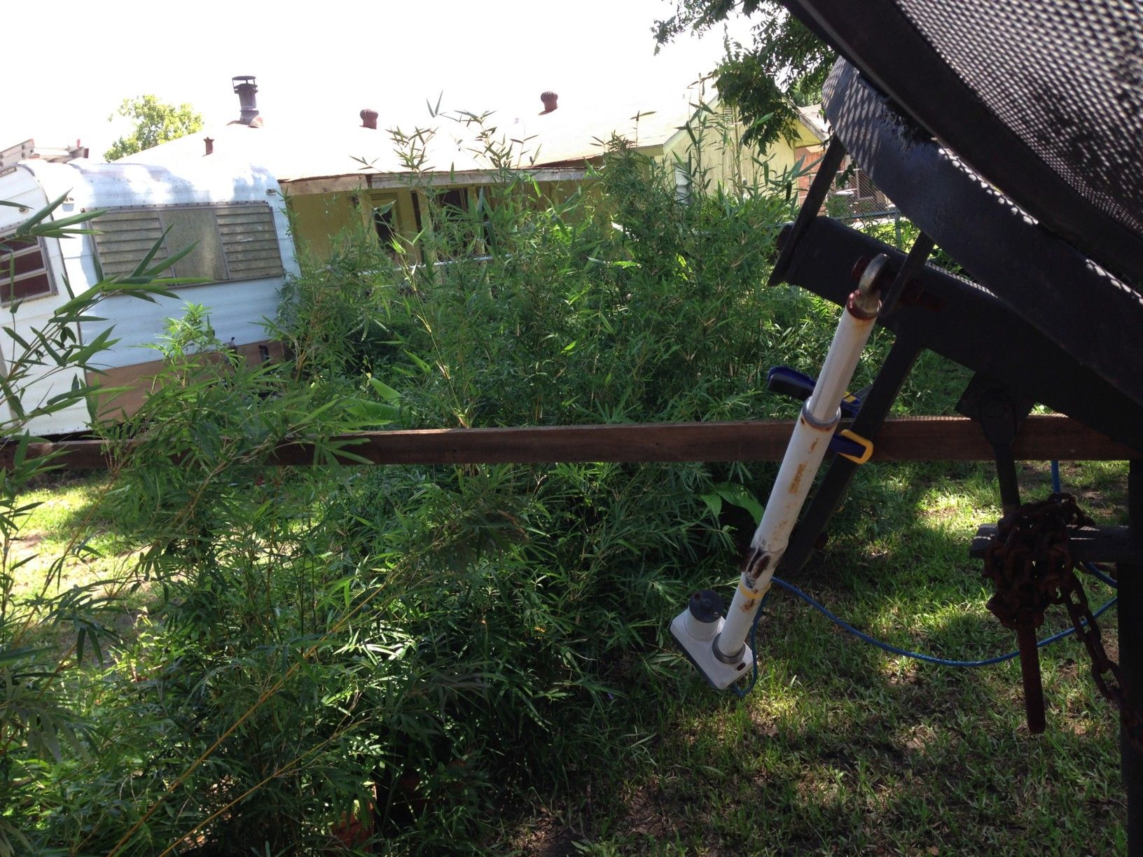

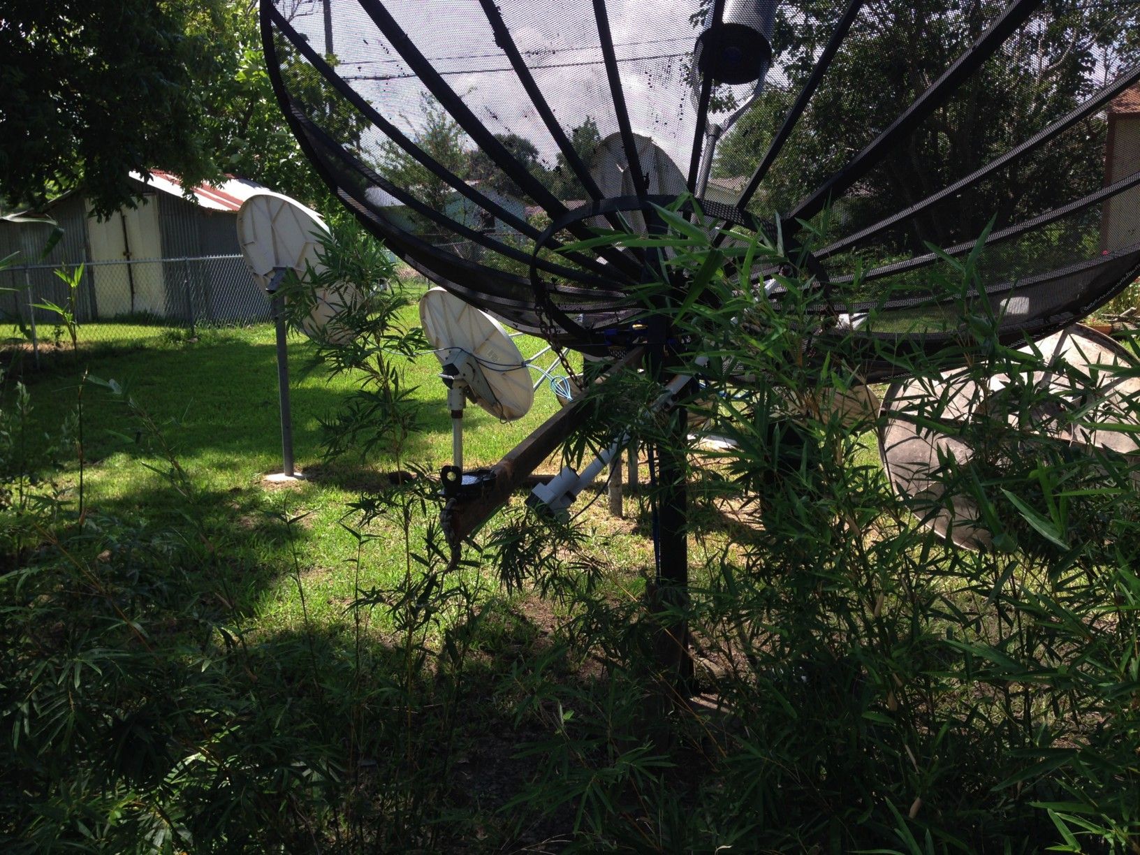

In the pictures above I had the stick on the ring so I could check the dish level against the polar mount to see what was going on.
I also clamp it to the axis of the mount so that I can hold the compass far enough away from the dish that the metal in it won't mess with the compass. I also remove metal and electronics from my person.

I can clamp it to many different parts of the dish to have a place to put levels, compasses, inclinometers, etc..

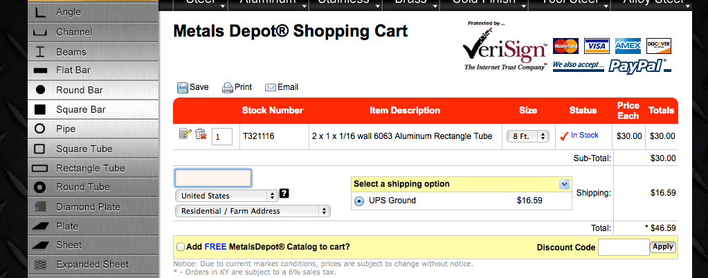

The stick works fine but an aluminum tube would be better. Maybe I can find a place where I can buy one locally.
I wonder if a little I beam would be better... I dunno..
edit: Oooopsy.. I just noticed this is an alloy of some kind. Probably not good for use with my compass.. Darn.. :(
Aluminum should not hurt your compass readings.
Pure aluminum, no. But alloy aluminum?
