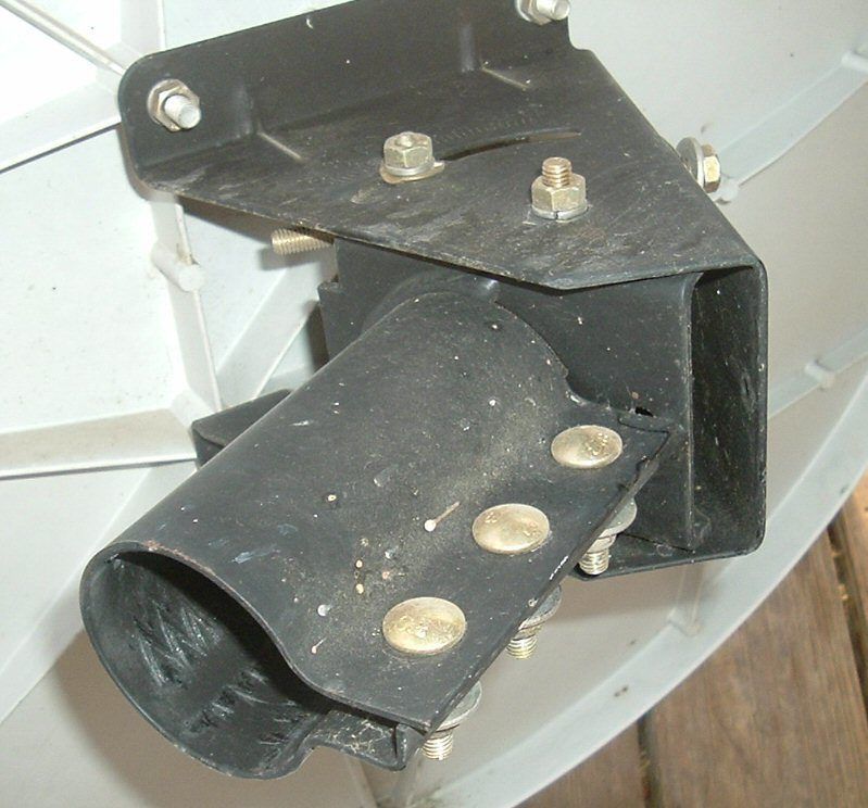

1. I am headed to home depot to get the pole for a motor I want to mount eventually. I am planning on getting the SG2100. What size pole do I need for that? I have a 2 3/8 one from when I did our chain link fence, but for now, while I dont have a motor, I will concrete that into a bucket for a static install to test things out. How deep do I need to go into the ground?
2. I have the DTN dish, with the mount you should see in the picture below, would I better off doing the ziploc retrofit ( http://www.satelliteguys.us/showthread.php?t=42450&highlight=Primestar ) or just turning the mount upside down and using pvc pipe to make the SG motor pipe bigger?
3. I am thinking the legnth of cable will be maybe 125 feet, will I run into problems with that? I am using RG6 from a 500 ft. spool from Home Depot.

1. I'm using a 2 3/8" chain-link fence pole. I'm thinking you could go even bigger.
2. That mount looks nearly identical to my P* one. I did the up-side-down mount and schedule 40 PVC sleeves (1 1/2" & 2"). The ziplock method looks to be lighter but it is more work for sure. I think I'm going to pick up that 50mm tube for the SG-2100 and have just one sleeve when I put my 'new' 26x36 dish up.
3. I wouldn't sweat the long run. Mine is about that long if not longer and I don't notice any difference in the house or out at the dish.
<edit>I just checked... my run is 138' to the Demark box, then 25' from there to the receiver... so a just over 160' run!</edit>
