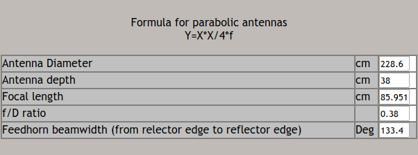

I just wanted to chime in with my results of fiddling with my feed. I'll post my calculator results, but my focal length was 85.4cm instead of the 85.9cm the calculator gave me.
So 0.38 didn't work nearly as well as the 0.40 setting. I figure this is because it offsets the 0.5cm that I am short...
Would adding a small spacer to the base of my feed legs to reach the correct focal length and setting the LNBF to 0.38 give me much more gain?
Would adding a small spacer to the base of my feed legs to reach the correct focal length and setting the LNBF to 0.38 give me much more gain?View attachment 144187

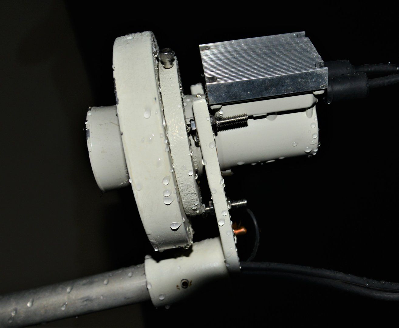

Maybe this will help. Maybe it won't. My dish is considered a "shallow" parabola (?).
After all of the string and tape measurements my LNB was supposed to be stuffed in to the very last (and then some) line on the scale.
I at first tried the original settings that the Corotor was set to. What I found out was the dish was under illuminated by the scalar.
Signal sucked. The "beamwidth was very narrow.
But that was where the original installer placed the Corotor and scalar.
This is where I ended up and signal is great.
It's a button hook feed and I replaced all of the aluminum support tubing with thick wall. It's stiff!
But simply tightening down the LNB set screw where signal was maxed out caused it to drift. Grrrr.
So I grabbed a handful of stainless hardware and made the LNB stationary and the scalar moveable for that last little bit of signal.
Signal sucked. The "beamwidth was very narrow.View attachment 144190 But that was where the original installer placed the Corotor and scalar.
That's interesting. I have very good signal reports as is, so I'm not looking to totally overhaul anything right now. But it gives me food for thought.
I have 12.8dB on 105w NBC feeds, 14.7dB on CTV (107.3w), 15.1dB on 97w CBS Encoder (4120V), and 16.1dB on 97w (3940H).
When I changed my LNBF to 0.38, signals suffered, so I went back to 0.40.
I just wonder how much of my dish is under-illuminated, because it is only 7.5' diameter.
Are you also setting the Focal Length setting to be measured approx. 1/4" inside the feedhorn opening?
How are you setting the FD? The scalar looks to be set too far forward for a .38 setting.
Is the button hook mount clamped to the feedhorn and the scalar independently slides fore/aft? Hard to tell from the photo how the feedhorn is mounted.
Looking at your photo, the scalar and feedhorn do not appear to be correctly aligned. The scalar doesn't appear to be parallel to the dish surface and feedhornlooks to be tilted up and not aimed into the center of the dish.
Hey Brian. Nah most of this is covered in my other post. f/D is an unbelievable .32. No sh*t.
The appearance you see (misalignment) is actually casting slop. A square placed across the yoke of the casting and extended to dish center doesn't point right at the center. Even the original install had washers added for shims.
Aluiminum castings and bending don't play nice together. So there you have it.
On the bench I shimmed the scalar bore with nylon strips and guaranteed the LNB is only going to slide straight in and out.
Then with the assy. mounted and it all pointing dead nuts at the dish center and F was in fact that magic 1/4" inside the LNBF throat. That's when I started tweaking for a sig.
Moved the dish first (knew the LNBF was pointing right at the center) for max signal then used the 3 bolts/jam nuts to squeeze that last little bit out of it.
