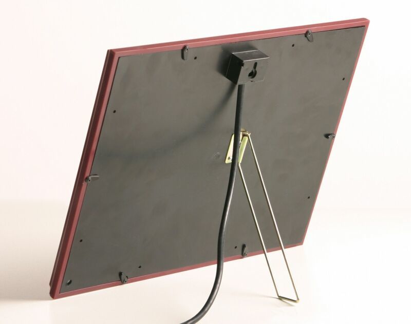

Check out this, it's definitely high on the WAF! :D
