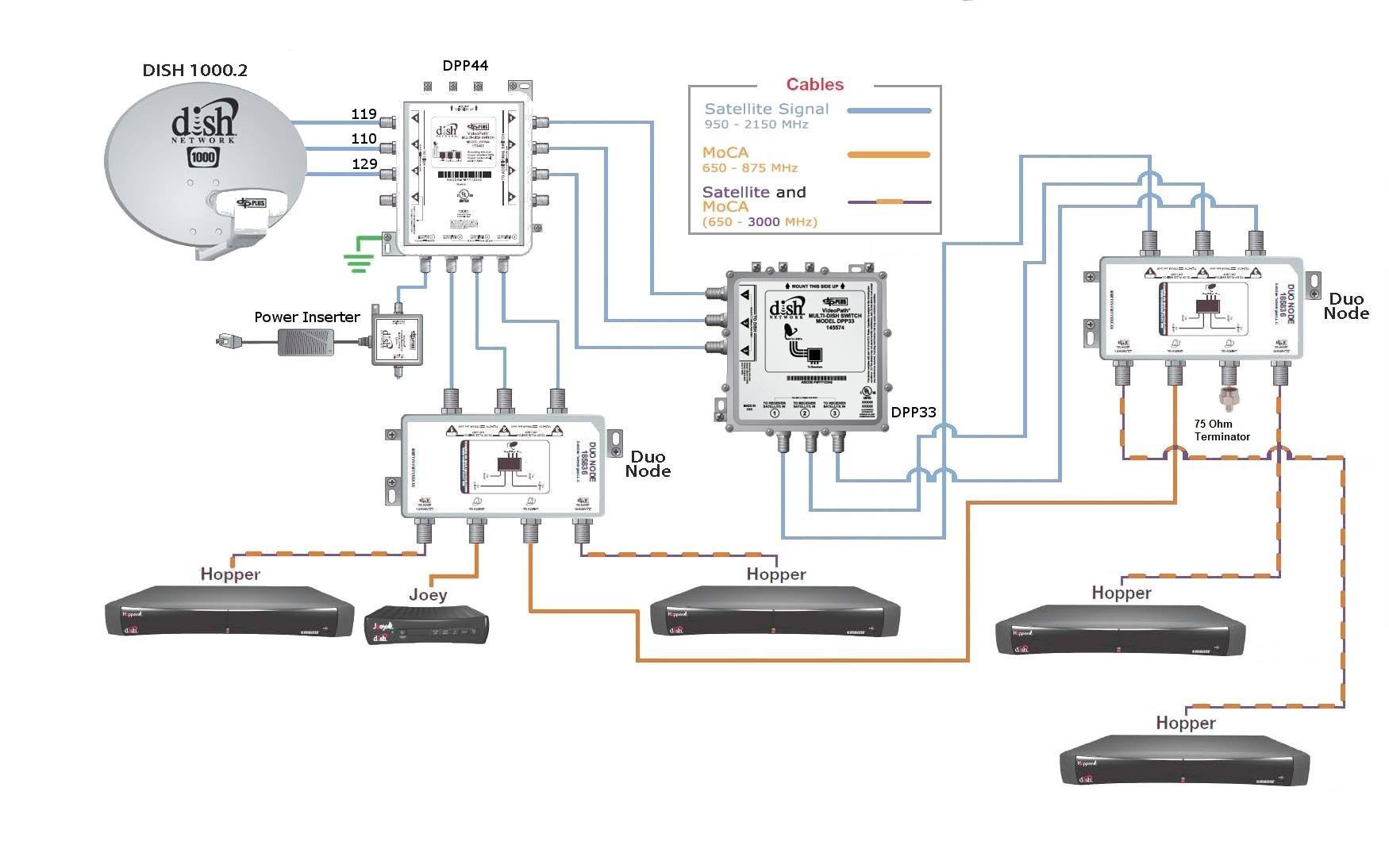

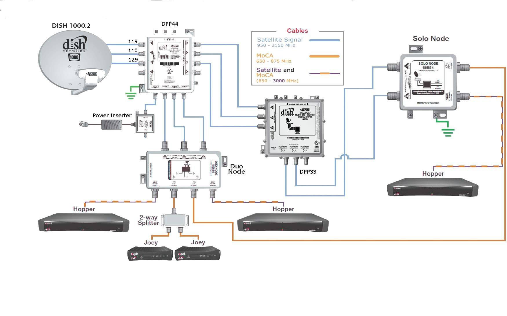

Btw here's some wiring diagrams I made regarding 3/4 Hopper setups :-

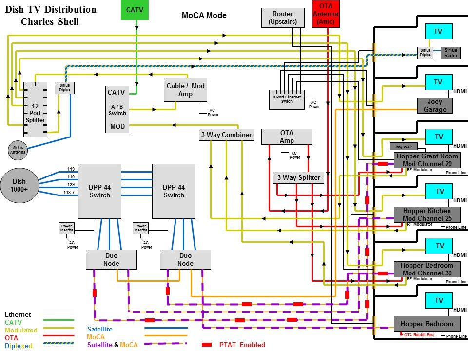

One of your diagrams showed up on DNS Portal. You are a very popular person, they look official. So much so installers are taking them as Dish training material.
But the head Guy for the Hopper equipment says not to cross client ports because it might cause a 1303 error.
I have run in both configurations for almost 2 years now with no issues. MoCA Good on all receivers.
I have been running four HWSs for 18 months now and have never gotten a 1303 error.

I'm sure the reason they say not to do it is because it could cause stability issues and dont want to support something they feel isn't stable. Maybe it works for some, but I'm sure there are reasons.
I'm running 4 hoppers and an "unofficial" wireless Joey here just fine too.
