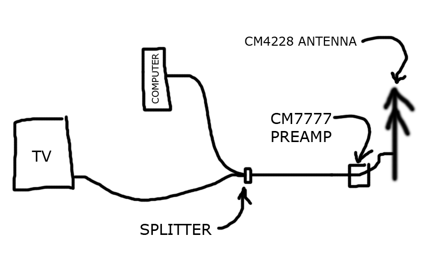

So hook it up like the diagram attached right?
I am going to use a Channel Master 4228 UHF antenna and going to grab a Channel Master 7777 preamp, found one locally for $53 and 90 day return policy...
Your diagram is missing a piece. The CM pre-amp is a hard-cover dark gray box. It should be as close to the antenna down-lead connection as possible. Preferably within a few inches of the antenna's output balun.
On the other end is the CM pre-amp's power supply. A white plastic box with two coax connections and a power cord. It can be located anywhere down-stream of the pre-amp itself, but up-stream of your splitter.
