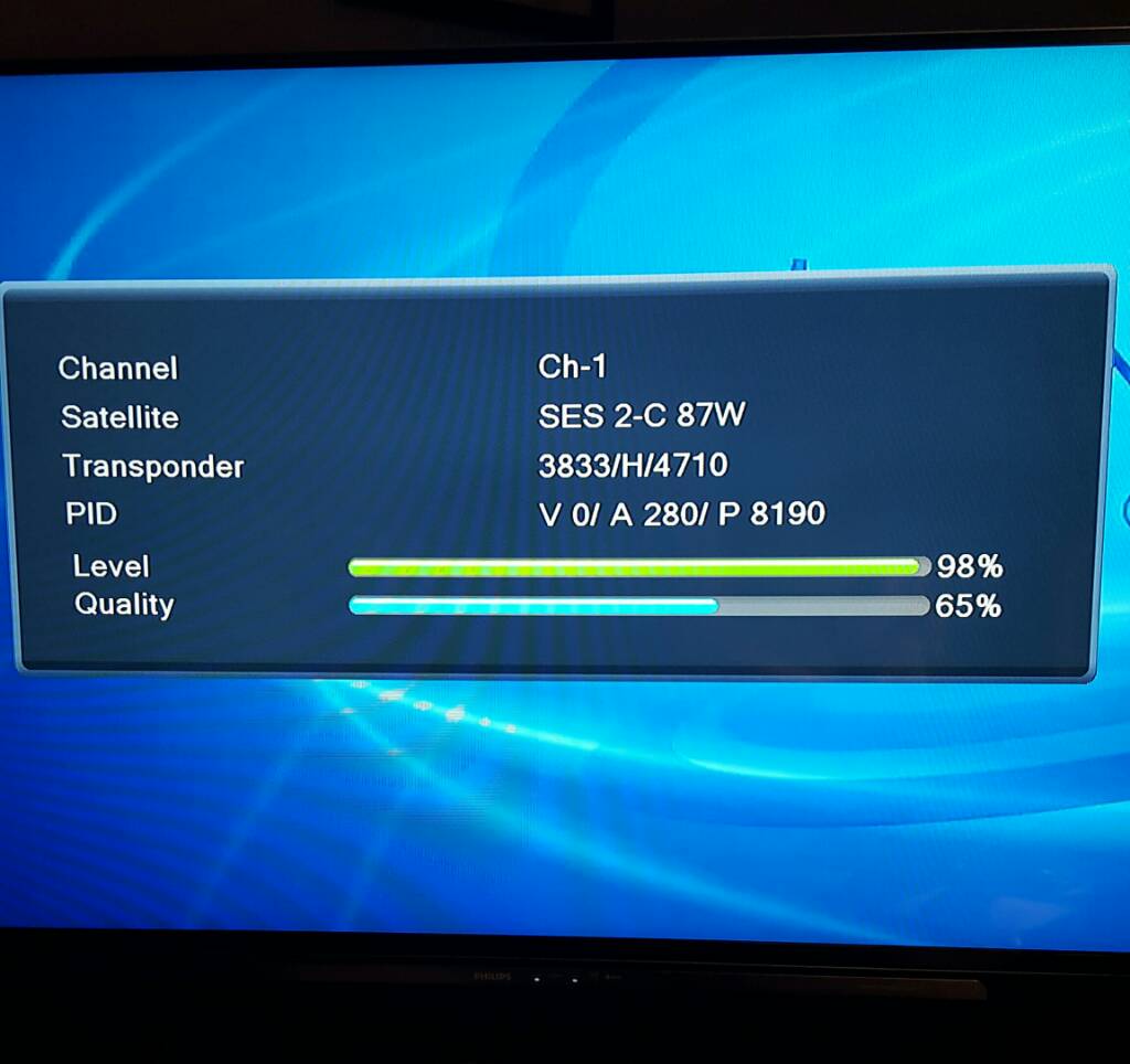

You originally mentioned the 4044 H TP going down or being intermittent at times. Actually that is correct, the uplink facility is no longer going to be broadcasting on the 4044 TP any longer. I would guess it's been intermittent at certain times of the day for certain stations needing important feeds, until they make the change I would guess.
The new frequency for VCY is: 3833 H 4710. Try that and see if it comes in for you. I finally managed to get it to barely blind scan in, but no signal at all; probably due to weather or clouds. I will try again later. Hope the new frequency works for you! :)
Correction, I had to turn my C-Band dish a little more to the west to get the signal to come in. I got it working now! :) This is the new frequency that's replacing the 4044 H TP.

Just scanned 3833/H/4710 here at 7 am.Strong signal.One channel with 19 Audio sub channels. (LinkBox 9000i)
4044/H was nothing.

That's the one! 4044 TP just moved over to 3833. I sometimes might listen to it, USA Radio News reminds me of the Christian radio station days of the 1990's.
