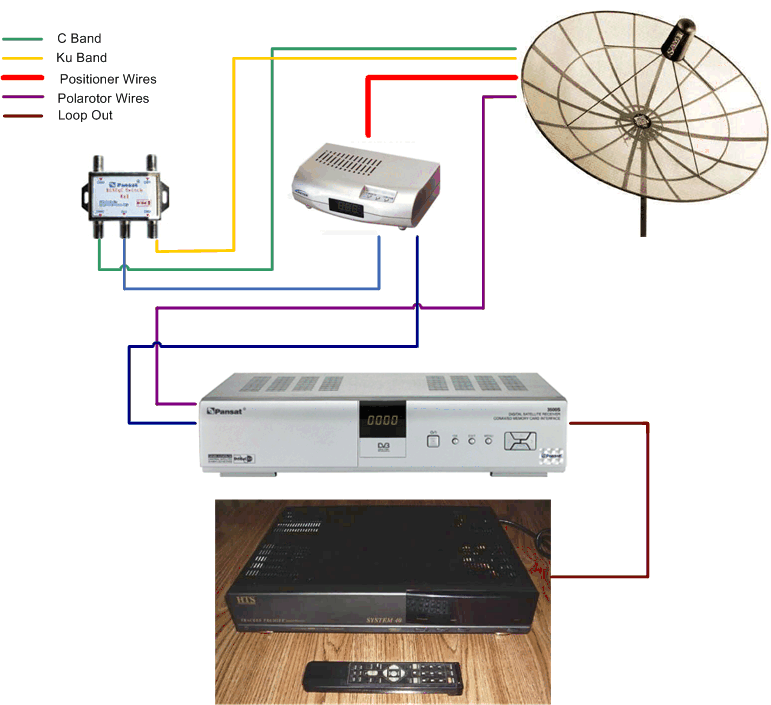

Is this how you are setup? (see attachment)
Hi Shawn,
Sorry to bother you guys with this.
This is how my setup is wired.
I just tried to scan Galaxy 10 for KU and found nothing with it wired back as shown. I'll wait on your response before unhooking from the switch and bypassing it.

That'll work too, but since the analog box isn't controlling anything it just adds more connections :).
Just be sure that your VBOX is connected between the Pansat and the DiSEqC switch.
The Vbox is connected up between the Pansat and the DiSEqC switch.
The next step is to take out the Hi-Freq switch and hook directly from the dish to the DiSEqC switch and see what that does.
