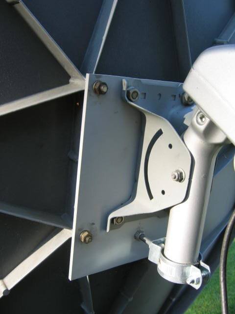

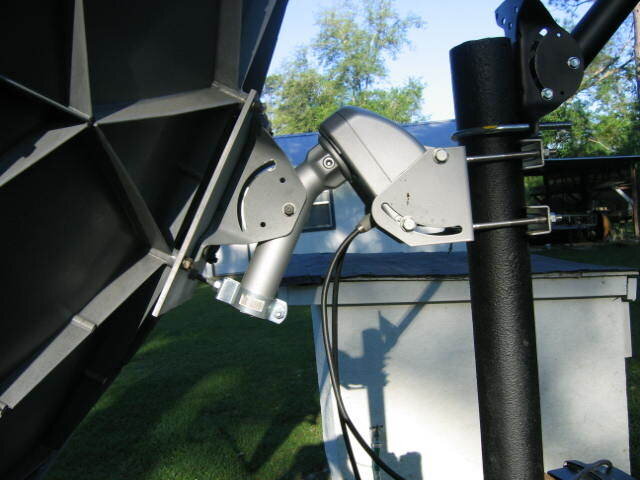

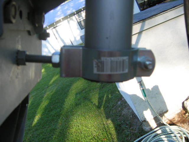

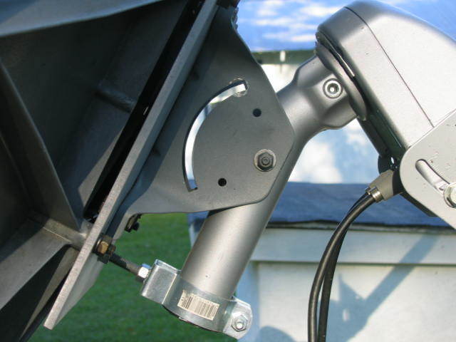

For me the simple way to do it is to mount a plate to the dish (you can use plywood in a pinch or aluminum angle, or flat bar if you can get it, I used Aluminum plate because I had some.:D ), then drill the plate to accept a foot mount from a Directv dish. Then you can use a fab'd jackscrew to adjust elevation. I have some pics here of my 1m dish to give you an idea. PM me if you want detailed instructions on how I did it..

Looking back at the archived threads in the 1m to 1.2m Primestar thread this post is where I adapted my idea from. I used the top set of pics as a guide. Thanks to him for the idea.
http://www.satelliteguys.us/showthread.php?t=23072&page=6&highlight=SG2100+Primestar+Dish
Now, looking farther down the page, I see at the bottom someone using a skew plate from a D* Phase III dish. I have about five of those lying around, so I may try THAT for my 84e. :cool:
