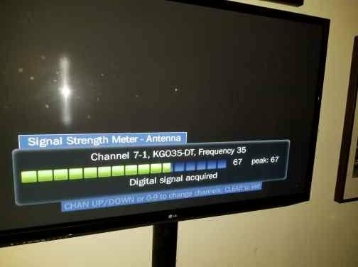

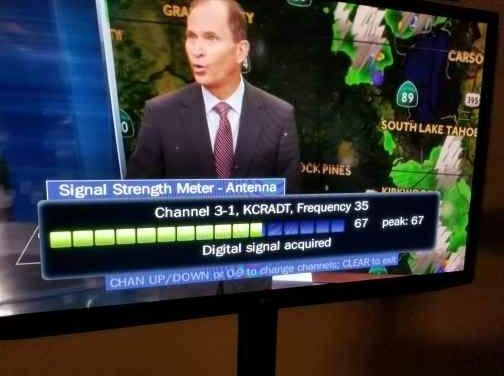

Update:
My antenna is exactly 35' above ground. clear sight with no trees etc.
My issue is that I get a local channel KCRADT just fine of course.
But another bay area channel KGO35-DT comes in at the same signal strength but no video.
I realize that there is a great difference in distance. Just wondering if the signal strength is the same why I am not getting the video.
Here are pics of both:
View attachment 130727 View attachment 130728
3-1 and 7-1are on the same frequency channel, so if you receive one the other is also received.
It appears the station is not providing signal to the 7-1 sub channel.
