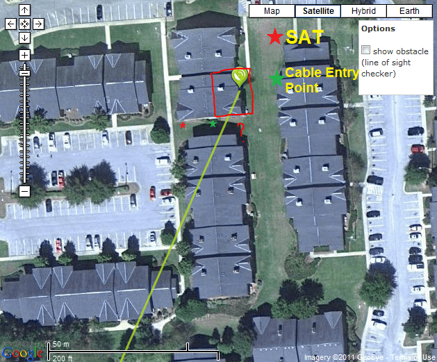

Unfortunately, I do not have LOS at my apartment, so it looks like I won't be able to join the satellite crowd at this time. I will be looking for other options for television, as I almost broke the television from having to look at blocky, compressed HD during football and Grimm last night. Thanks again for all of the information!

Is there LOS where the cable TV enters the building? If so, they could install the dish on a pole in that area and using SWM technology use your existing wiring.
You're in Alabama? There should easily be LOS over the building across from your top floor balcony. The birds are pretty high in the sky in the southern states.
Edit: just looked at your DishPointer image, the problem is your balcony isn't facing south so it would need to go on the roof just above your balcony.
So if they won't allow a roof install, it needs to be put on a pole near where the local cable enters the building.
Try this:
attachment.php

I asked about alternate placement of the dish, but unfortunately they will not allow it unless it is on the balcony or directly next to the building where my apartment is located. The landlords, while great people, are very particular about satellite television. She almost turned up her nose when I carried the renter's document for her to sign. The good thing is, it is an apartment and I do not plan on making it my permanent dwelling. So hopefully, once we move out and get a house, I'll be able to sway the wife for one with an exellent view of the southern sky :)

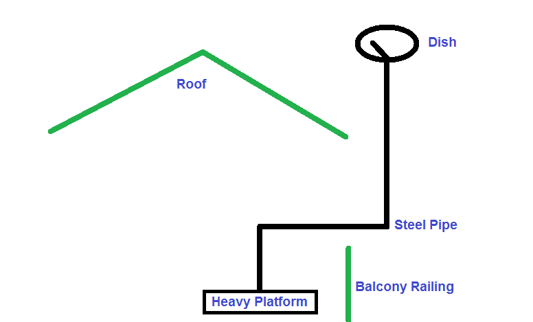

If it were me I would resort to something like this.
Drawing not to scale. For concept purposes only. Could possibly add a non penetrating clamp at railing and roof line for stability.

Well, I went ahead and grabbed Comcast - they had a good deal running, and considering we have just renewed our lease for another year at this complex, this will be the best bet. The money/price is right, and they have all of the HD channels I'd want (BTN, ESPNs, FSN, FX, locals) in much better quality than U-Verse. It's settling, I know, but hopefully in the next two years I'll be making my way into a house of some sort.
