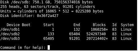

My external HD has 3 partitions on it - mounted under my linux vm:
/dev/sdb1 = 1GB
/dev/sdb2 = 500GB
/dev/sdb3 = 198GB
The only folder in /dev/sdb1 is lost+found but both /dev/sdb2 and dev/sdb3 have the DishArc folders.
Not sure what the purpose of the 1GB sdb1 partition is but it is there on my drive.
When I had the corruption I couldn't mount /dev/sdb2. that was the partition that I had to run 'e2fsck -f -v /dev/sdb2' on when I was getting the drive must be formatted error message.

OK, you got something unusual - so far all EHD disks had two partitions: 1st - 1GB, 2nd - rest of disk space.
Could be 750 GB specific, is someone have 1 TB disk for check partitioning ?
