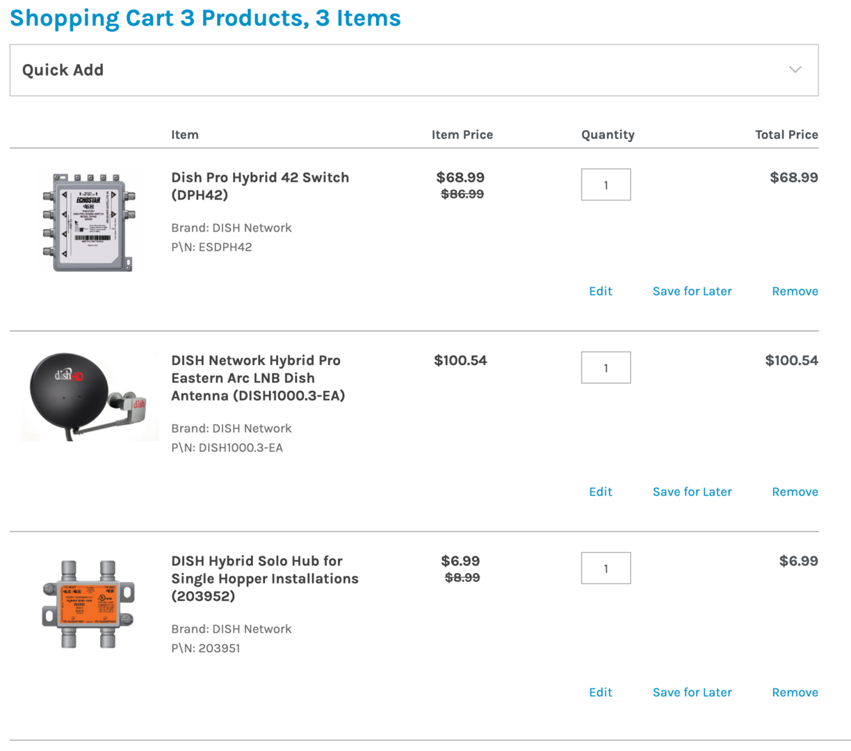

Please see attached. Is this exactly what I need? I want to use a single Wally today, and possibly a Hopper in the future. I would much prefer to climb the roof just once and be done. It is unclear if this dish comes with a mount or not. The back of the dish will include the bracket to adjust the elevation, etc. correct? I have both an existing DirecTV and Excede Internet mount at my disposal I can just take the existing dish off of, correct? The rep I spoke to at Solid Signal previously said I needed the solo hybrid hub. Do I still need that if I am buying the DPH42 now? Will the Wally work with the DPH42 without a Hopper in the mix at this time? In terms of physical connections, will it be as simple as one coax coming off the LNB, into the DPH42, and then out of the DPH42 into the Wally?
Thanks again! I am old hat in Satellite, but a complete newb to the world of Dish.
That looks like a kit, should come with a standard 1 5/8" mount.
Yep, and accurate if the mast is level of course.
You can use them if the mast is 1 5/8" OD, afaik most (or all) DTV slimlines are 2", no idea about Excede. Very old DTV was 1 5/8".

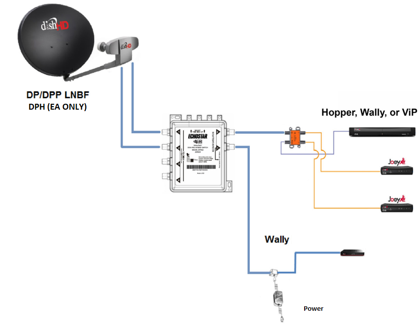

The Hubs are used to provide a client port for Joey's to run off of the Hopper, if all you are connecting is a Hopper/Wally then it is unnecessary, would still install one if you see yourself putting a wired Joey in the future. (Check the diagram, I edited an image from the DPH42 manual to sort of resemble what you would go for)
Yep, as long as the switch is powered it will provide signal on both ports, don't need two devices connected for it to work.
Not quite, you need one coax run from the LNB to switch per satellite, in your case 2 because that's what EA has. Then DPH42 to Wally, and the power inserter installed somewhere in between the Wally and switch (it can also be installed on the cable going to the future Hopper, as long as its going to receiver port 1).
